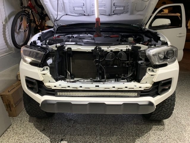

    just completed the swap on my 2016 using the trd pro units. Install was very straightforward using the oem MX150 connectors and I just repinned the oem wiring. Makes a major difference in light output and how the truck looks.

    So you cut and crimp the terminals to the OEM harness? Can you show? What did you do with the grounds?
  19. Oct 24, 2019 at 10:08 PM
    #279
    metdfd
    metdfd Well-Known Member
    Oct 26, 2014
    #141121
    112
    correct. I cut off the existing harness connectors and soldered/ crimped to the new MX150 female connector. You only use one ground on the new connector and the other grounds that are left are just not used.

    Pic of this?
