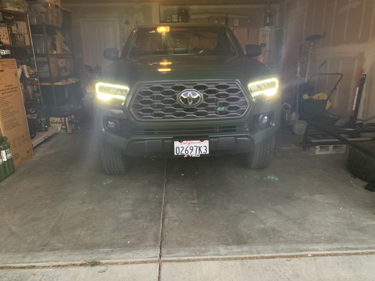

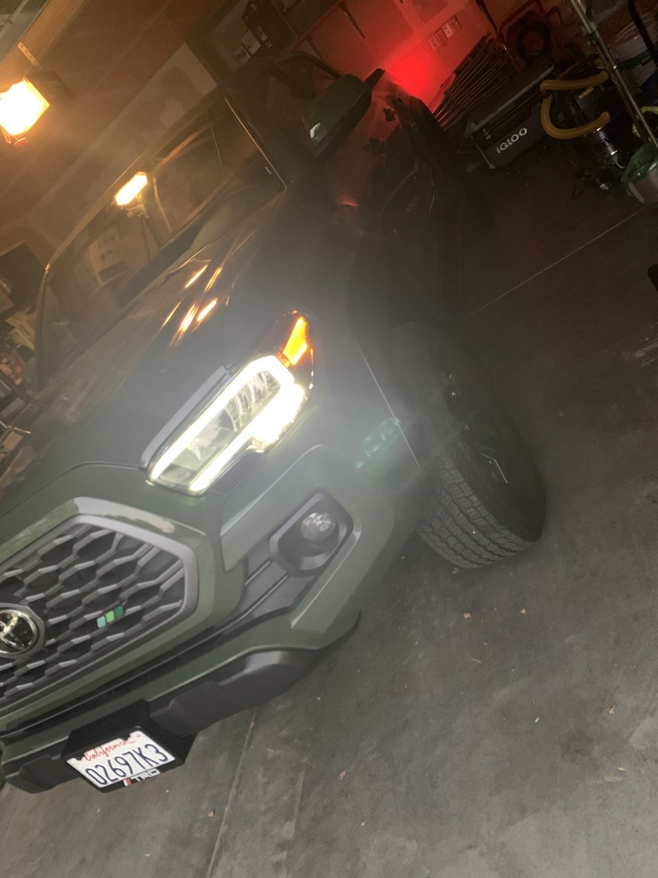

    Not the greatest lighting, but here ya’ go!
    before and after

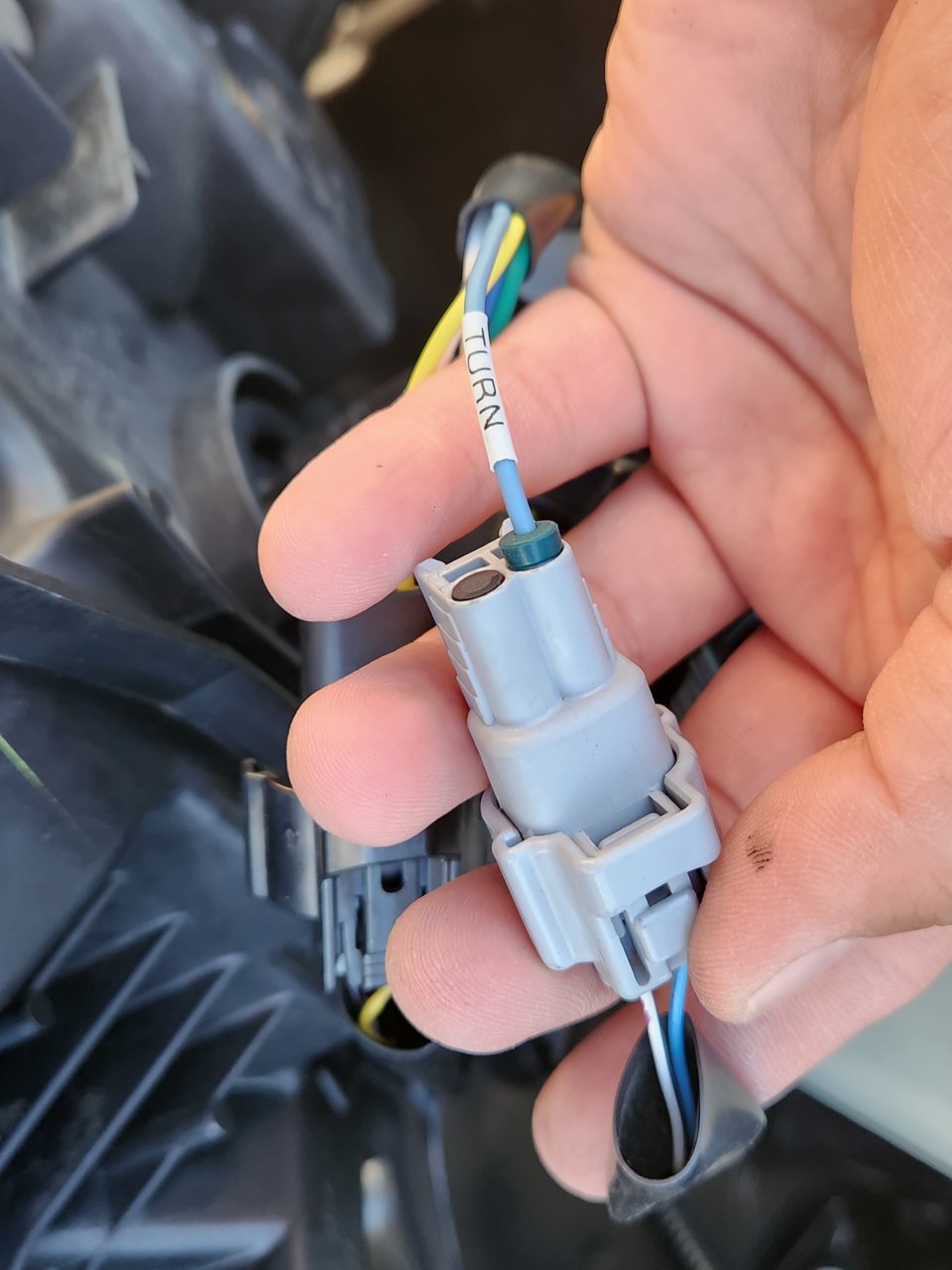

    Anyone know what the little reflectors under the DRL strip is for? The ones where it would say "TRD" "PRO" on the TRD Pro models. Is it just a squirrel finder/uplight? Or just more DRL.
    Edit: Also just installed the OEM LED headlights on my truck. Didn't realize Dave included two "dummy" plugs for the unused parking light connectors to keep it sealed and water tight. However, I'm noticing an issue with the passenger side light. It'll turn on just fine but after two minutes, it dims about 25 percent. Anyone ever have this issue before?

    you may have crossed the low and high beam plug up.

    The lower front lighting and sidemarker are only on with the parking light circuit. DRL is full bright on the C. Parking lights are dim on the C, sidemarker and 3 lower lights where the TRD and PRO trim plates are.
    However, DRL (when active) trumps parking light so there are actually 3 modes:
    DRL only == full bright C, sidemarker and trim plate lights off
    Parking Lights == full bright C, sidemarker and trim plate lights on
    Low and high beams == dim C, sidemarker and trim lights on
    the ECU has the DRL signal active with DRL and parking lights on the stalk but kills it when low beams are on.
    I haven’t tested stalk in parking light mode and pull back to activate high beams. I would expect that to look the same as push forward would look but not sure if DRL is on or off for that.

    Yes. Easiest way to check is make sure any OEM white w black stripe wire connects to harness solid black or (if it’s my harness) white w black. The colors are for positive, solid white is high beam positive on the driver side, solid yellow on the passenger side. Low beam is solid red driver side and solid blue passenger side.
    If you’re talking about the C itself and you have an upper trim which has auto on the stalk then it may be working as designed. But what I think I read does sound peculiar and unexpected. I’ve only ever seen dim trouble with the C, one guy has a headlight which never dimmed or never went full bright.

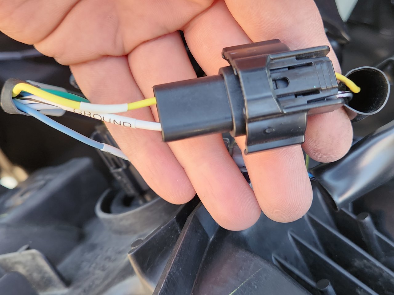

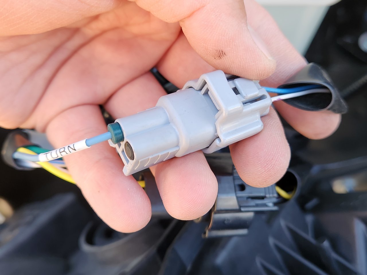

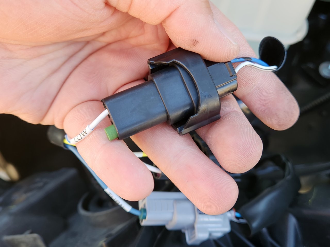

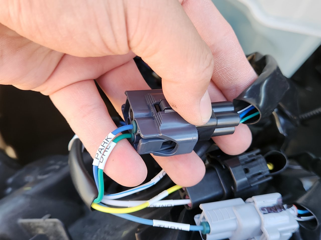

    Here's the harness hooked up to the trucking wiring on the passenger side, the side with the headlight that dims after 2 minutes. I think I have everything hooked up right.
    TahKo likes this.
  13. Sep 16, 2022 at 5:12 PM
    #2813
    daveeasa
    daveeasa FBC Harness Solutions
    May 14, 2020
    #328079
    7,477
    David
    PNW
    2016 Tacoma OR DCSB 6MT, 2005 RC 5MT PreRunner, 2002 Tundra SR5 RCLB 4x4
    I don’t see problems so far. The dimming is one side or both?

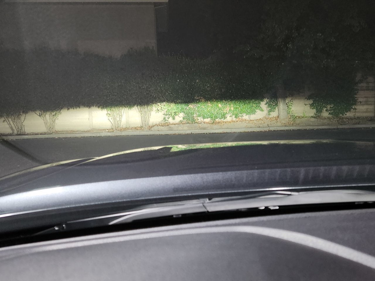

    Here's some photos. I think the first is dimmed. Second is full brightness when I first start up the lights. You can see in the top first photo all the way to the right, it's a bit dimmer than the second photo. More noticeable when driving and suddenly the light dims down like an led diode died.
    Trying to upload the short vid I took of it dimming.
    Edit: vid uploaded, happens around the 12 second mark

    Can you look to see if there is in fact an issue with a diode? There are 3 LEDs in the low beam (I think, I’m usually wrong though so double check that). Maybe one or more is turning off after a bit?

    There's five diodes for the low beam but it's hard to see which one is dimmer than the others. I looked up at the diodes and it looks like the further one in the corner, nearest the fender is dimmer than the equivalent furthest corner diode in the other headlight. Maybe the LED drivers in the headlight is bad.

    Yeah, I suspect you’d need a welding mask to be able to tell. But looking at your video, there is something up for sure in that low beam. If you have a way to test amperage, I’d be happy to send you a harness to test it.
