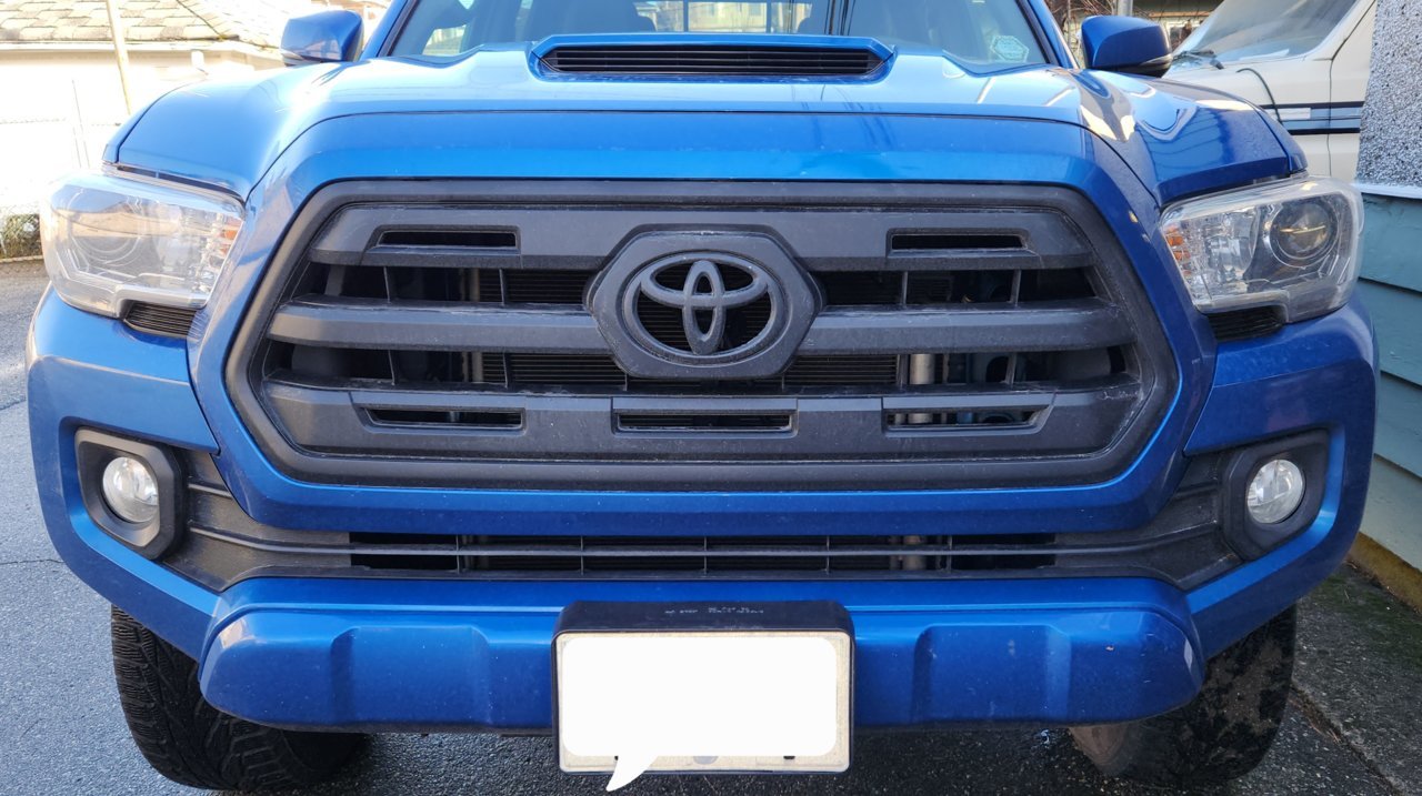

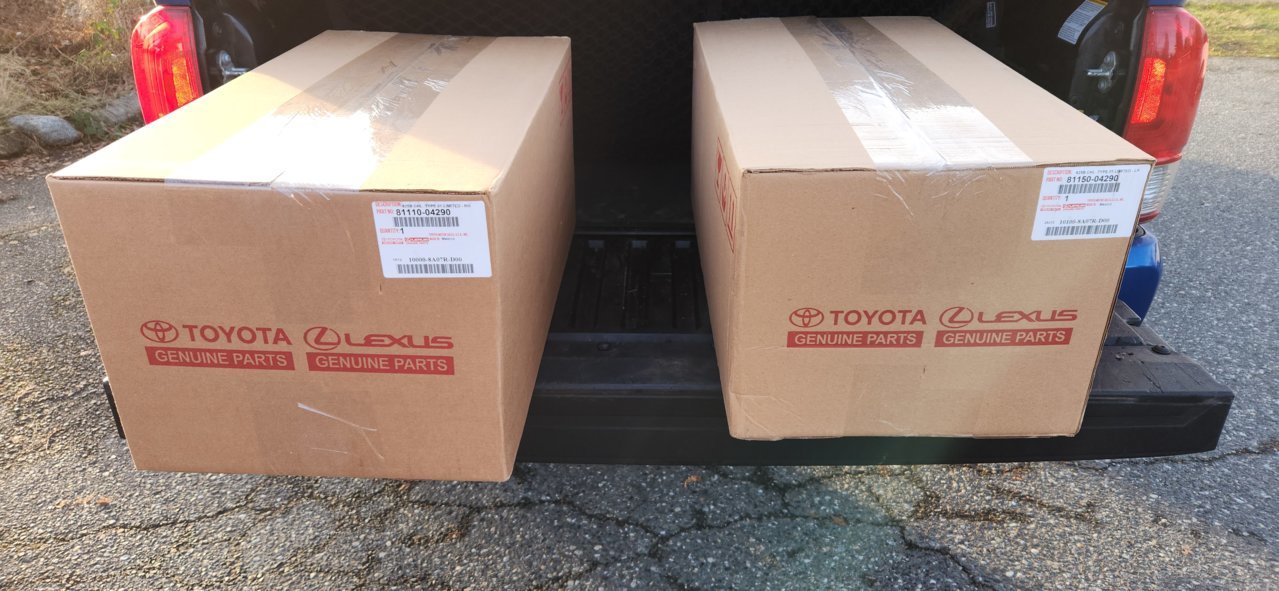

    Just picked up some boxes from a shipping depot in Washington State...

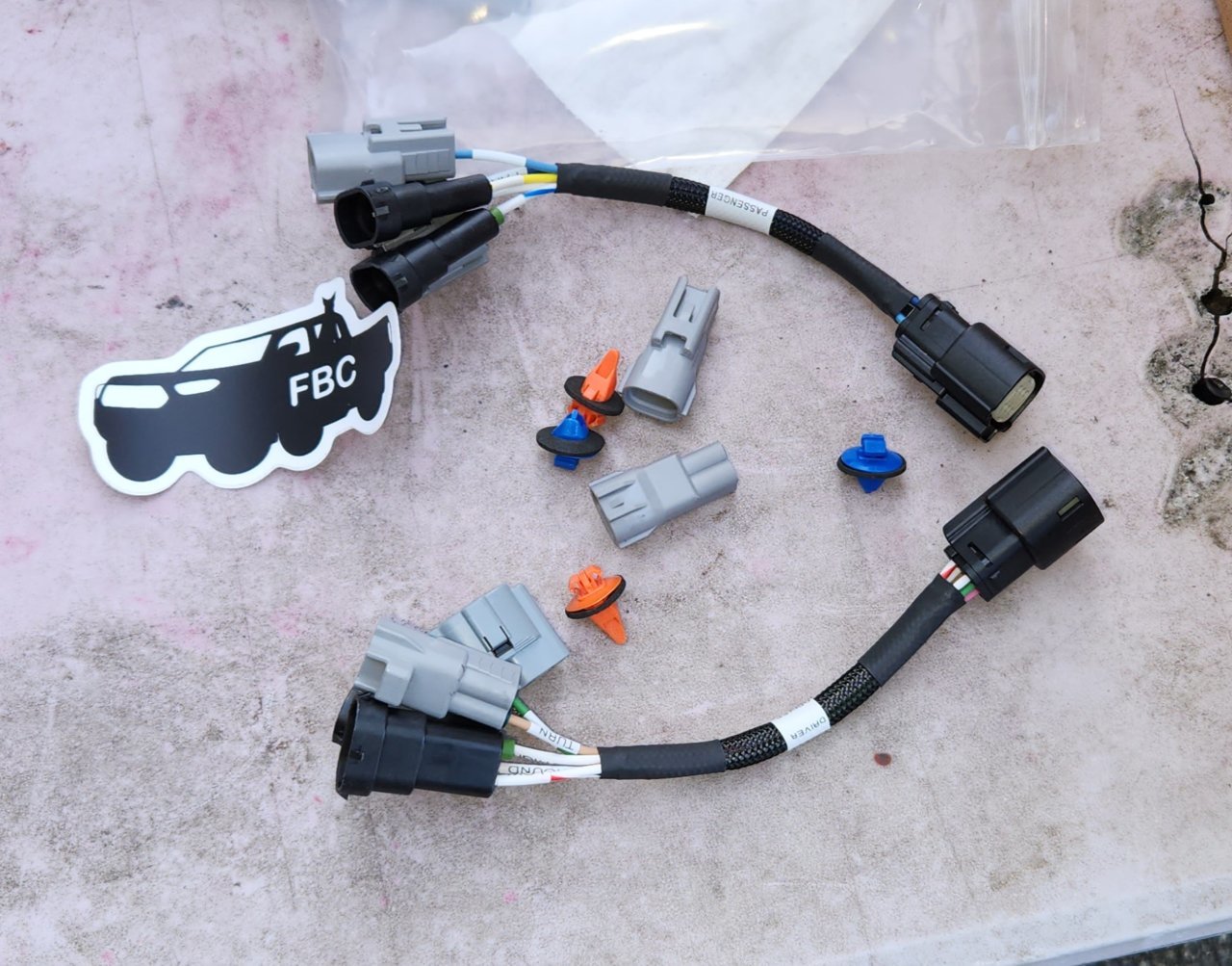

    Also a third package from @daveeasa ( Thanks again Dave )

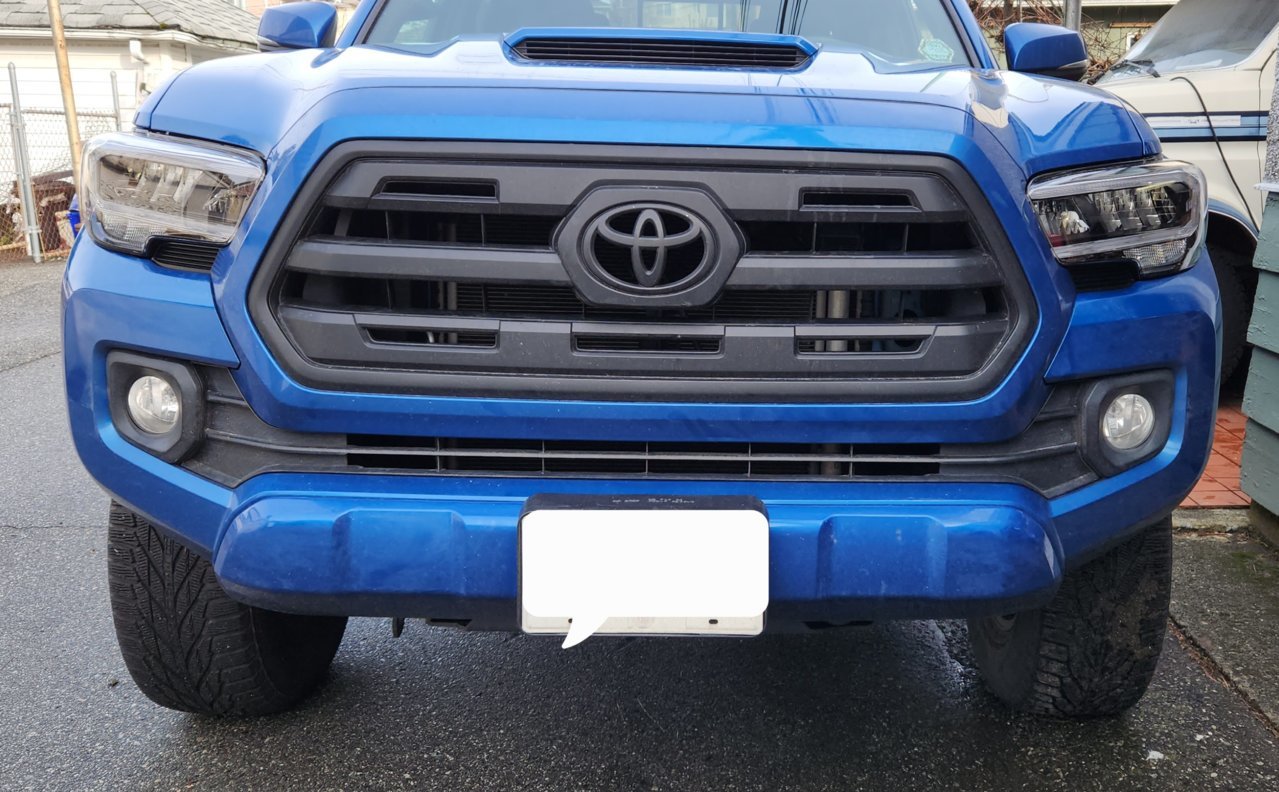

    Spent and hour or so and went from this to...
    This...
    Long winter nights are going to be much brighter now. I also picked up Rough Country 30" LED light bar for the lower grille area that will get installed soon. And will figure out what I want for fog lamps.

    Good evening folks, just purchased a 2023 TRD sport with the LED DRL, would also like to convert my Halogens to the OEM LED from the pro. Has there been any wiring changes since 2021 that would prevent this install with the aftermarket conversion harness?
  7. Jan 4, 2023 at 5:17 PM
    #2947
    Speedfreak
    Speedfreak Member in poor standing
    Sep 22, 2017
    #230756
    4,934
    Dave
    Canada Eh!
    2017 Tacoma TRD Sport DCSB 6MT, Blazing Blue Pearl
    Manual Mall Crawler
    You should be able to plug and play those lights right onto you truck with the conversion harness. I have not read of any changes to the wiring since the headlight assembly is unchanged.

    Thanks for the reply, I haven't read anything either. FBC site doesn't allow me to ship to Canada, I ordered a Morimoto H128 harness for the conversion. However the vendor indicated that they thought a wiring change had occurred for the 2022-2023 year and that the harness may not be compatible. Ironically other sites do show that the H128 harness works for 2016-current.

    I have a 2022, and used the FBC harness with oem led headlights and am 100% happy with the setup.
    FBC is on here @daveeasa ,and I'm sure you can work out on shipping?

    There have been no wiring changes

    No wiring changes as spikey mentioned. You’ll be fine. Make sure harness ground (often solid black on harnesses other than FBC) is connected to OEM ground (always white w black stripe) and you’ll be fine.
