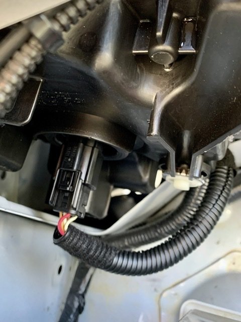

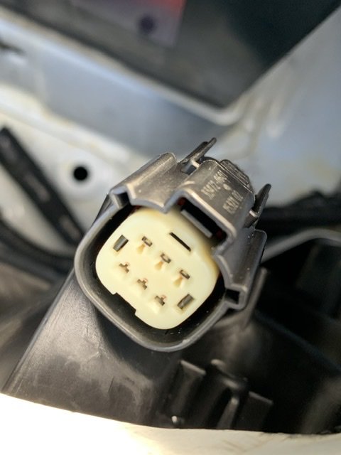

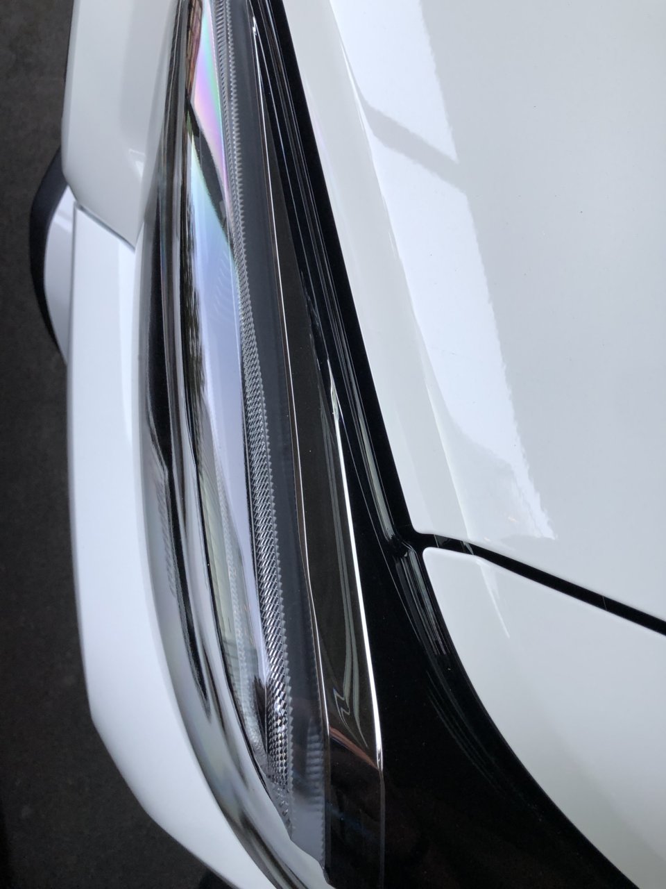

    112
    I will take a pic of the connector for you.
  2. Oct 25, 2019 at 6:20 AM
    #282
    TRDProOne
    TRDProOne Well-Known Member

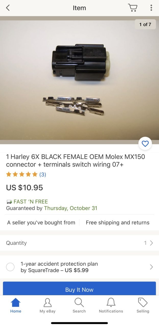

    May 2, 2019
    #292100

    Hi, could you PM some pics of your connections? I’m going to try to do the swap this Tuesday I already have some ideas since a fellow TW member posted some pics about the connections, but I just want to make sure everything is right.
    Thank you!

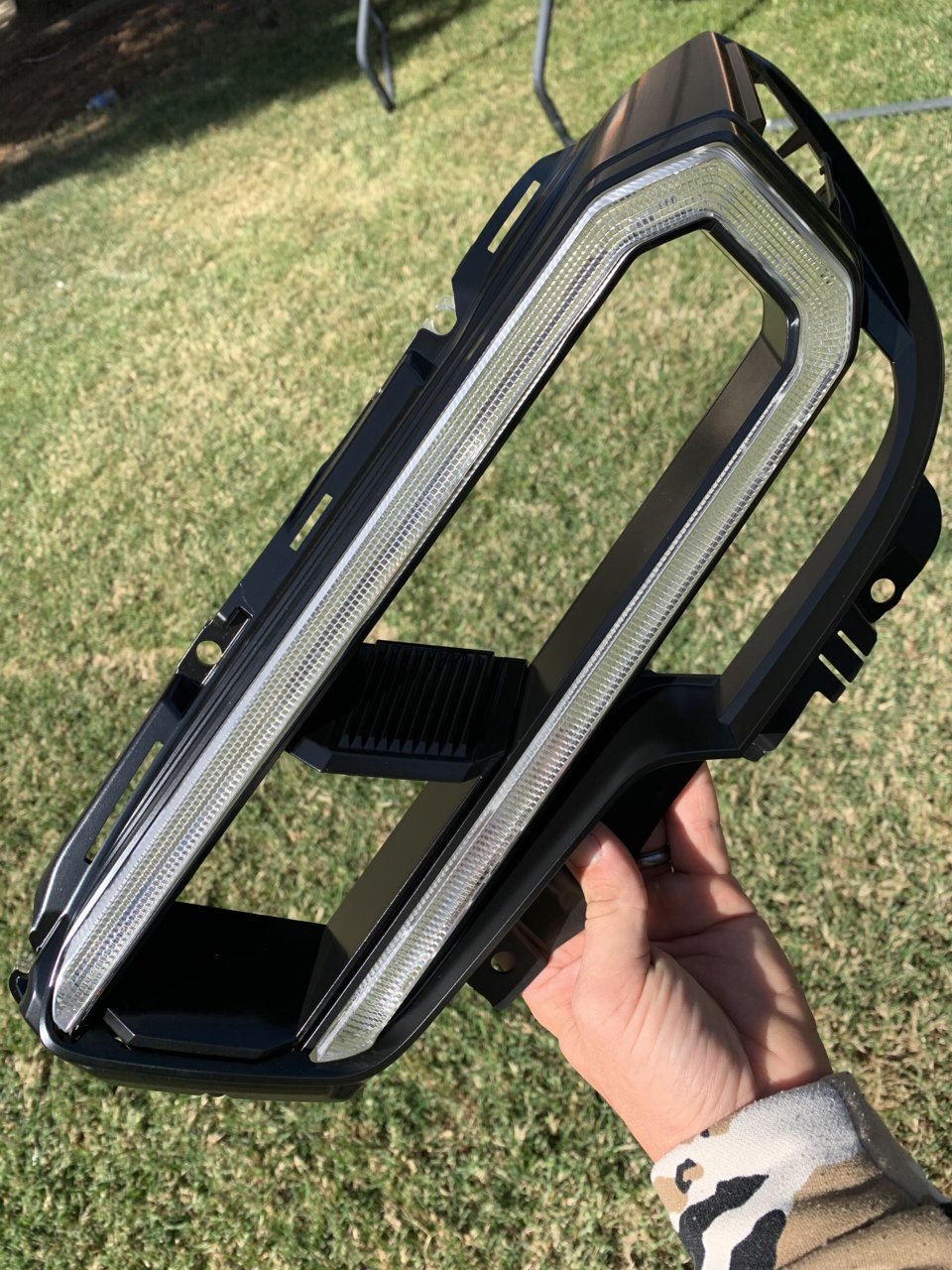

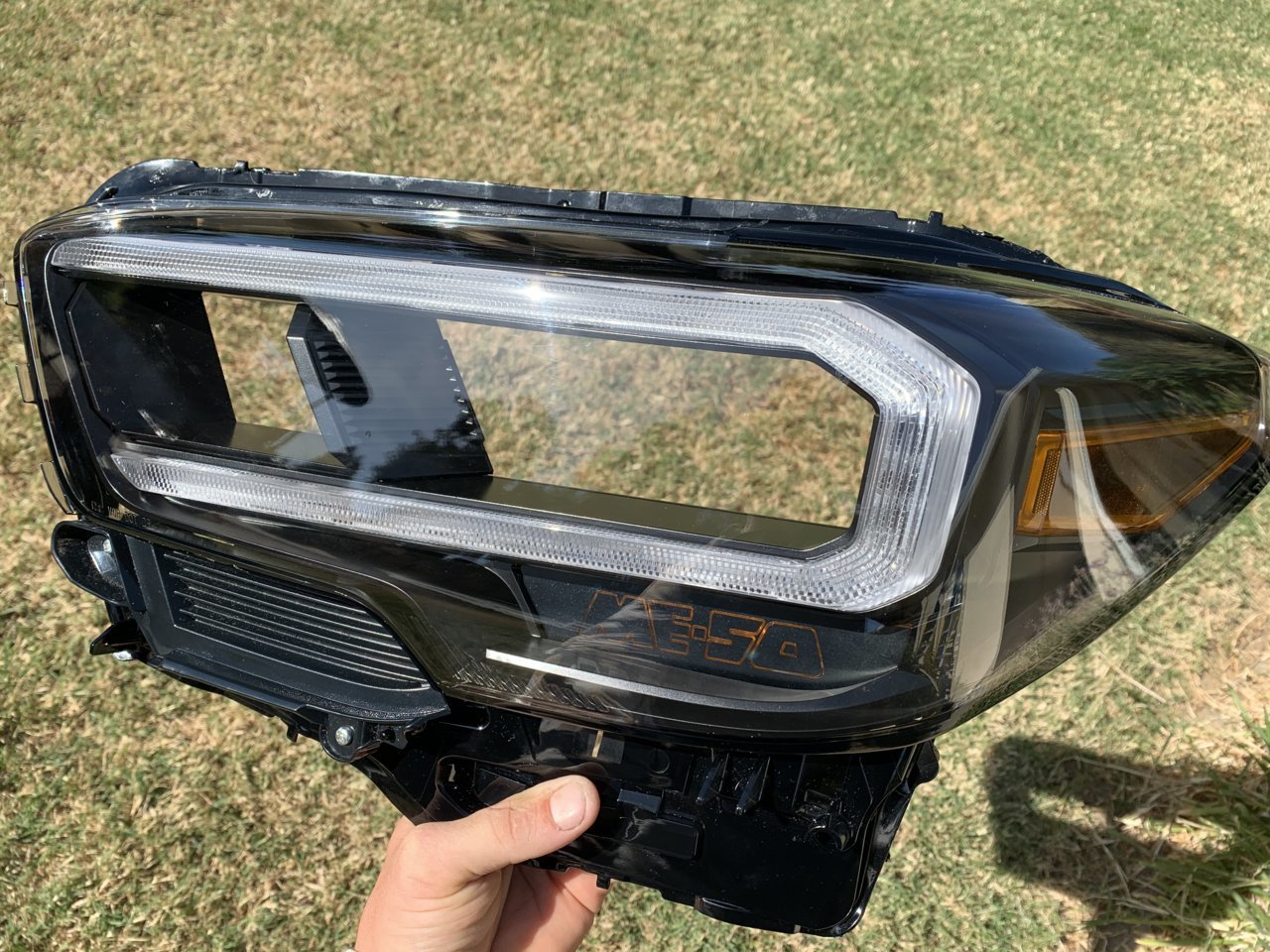

    You have to pull the headlight apart and paint it. like this

    So are the 2020 TRD Pro headlights not black housing like previous years ?

    they have black and chrome inside

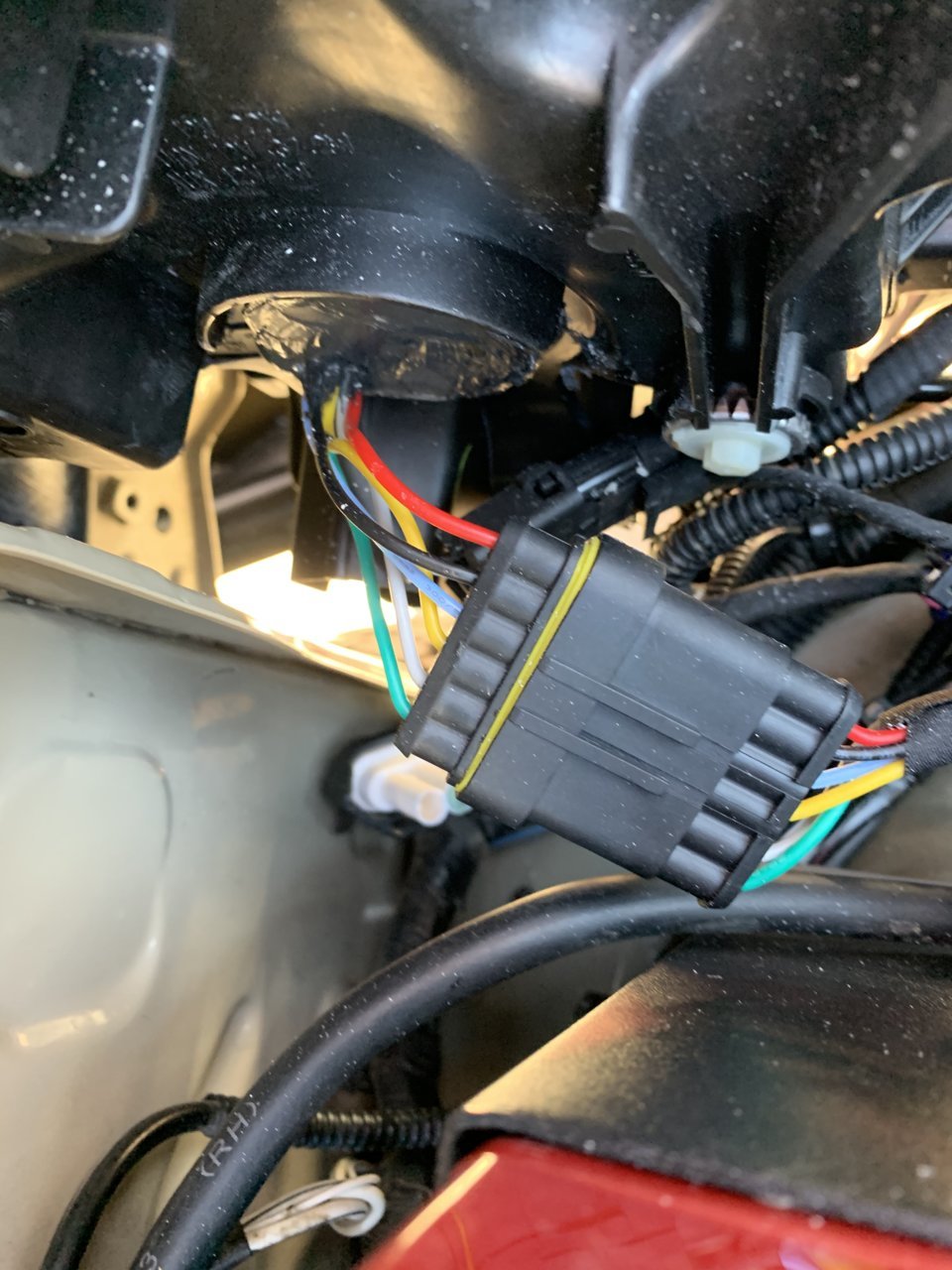

    metdfd Well-Known Member
    Oct 26, 2014
    #141121
    112
    Here you go
    D856DA5B-9A7B-4946-A5F2-9397CD3276A0.jpg F4222456-D0A7-49B0-8647-336CE26408AF.jpg
    Rainer415 likes this.

    If anyone doesn’t want to wait for the OEM plug. The internal wires are as follows;
    BLACK- GROUND
    BLUE-DRL
    RED-LOW BEAM
    WHITE-HIGH BEAM
    YELLOW-TURN SIGNAL
    BROWN-PARKING LIGHTS
    I didn’t feel like waiting for OEM 6 pin so I cut it off, soldered a universal 6pin TYCO(very common) and sealed it up with a 3D printed cap.
    Rainer415, 20tacoma17 and Knapz like this.

    Which ground did you keep?

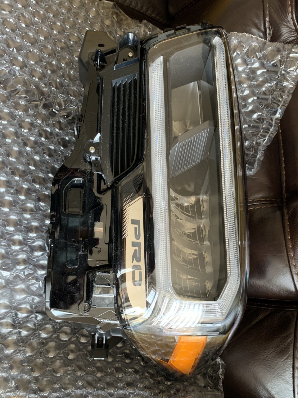

    Just got the headlights! Man they look beautiful!

    metdfd
    Oct 26, 2014
    #141121
    112
    I used the ground from the low beam and the rest of the grounds I just tucked away

    I ordered two of these and I received them within a few days

    Awesome, I was just about to ask on how to order the connector (Molex MX150). Thanks for sharing...
