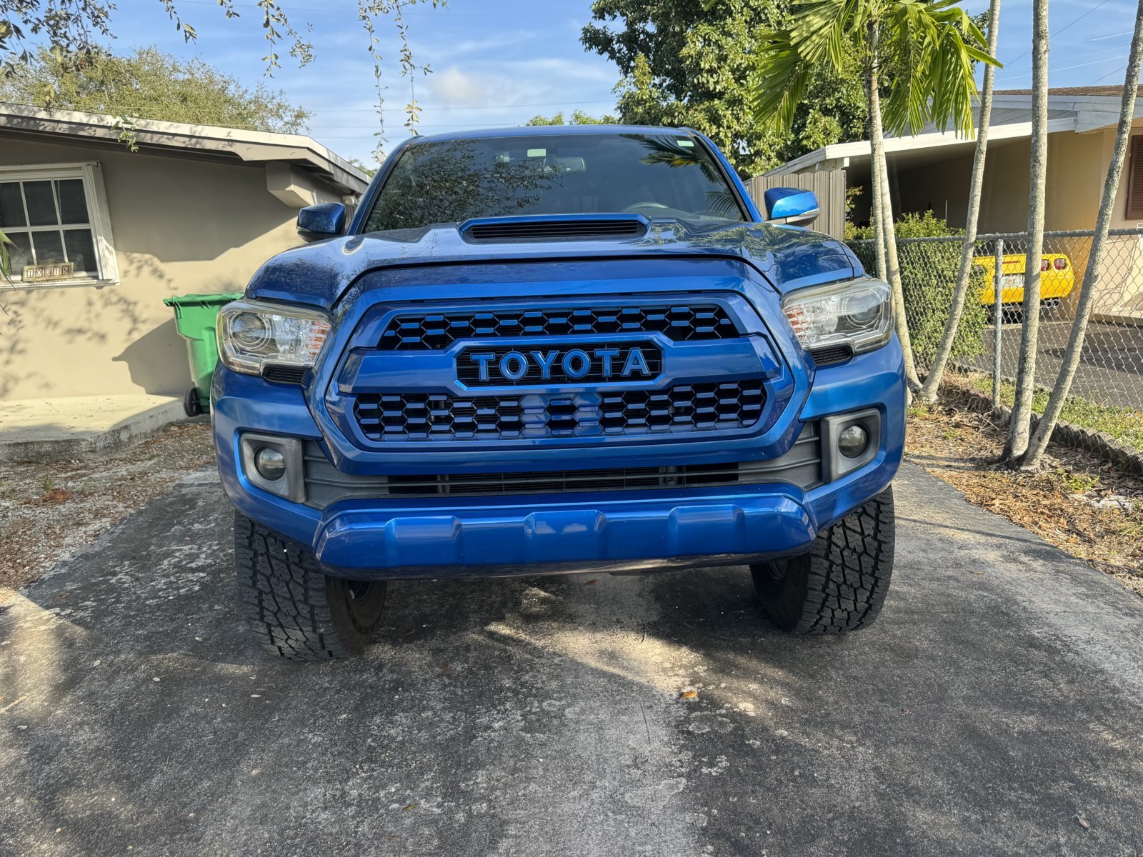

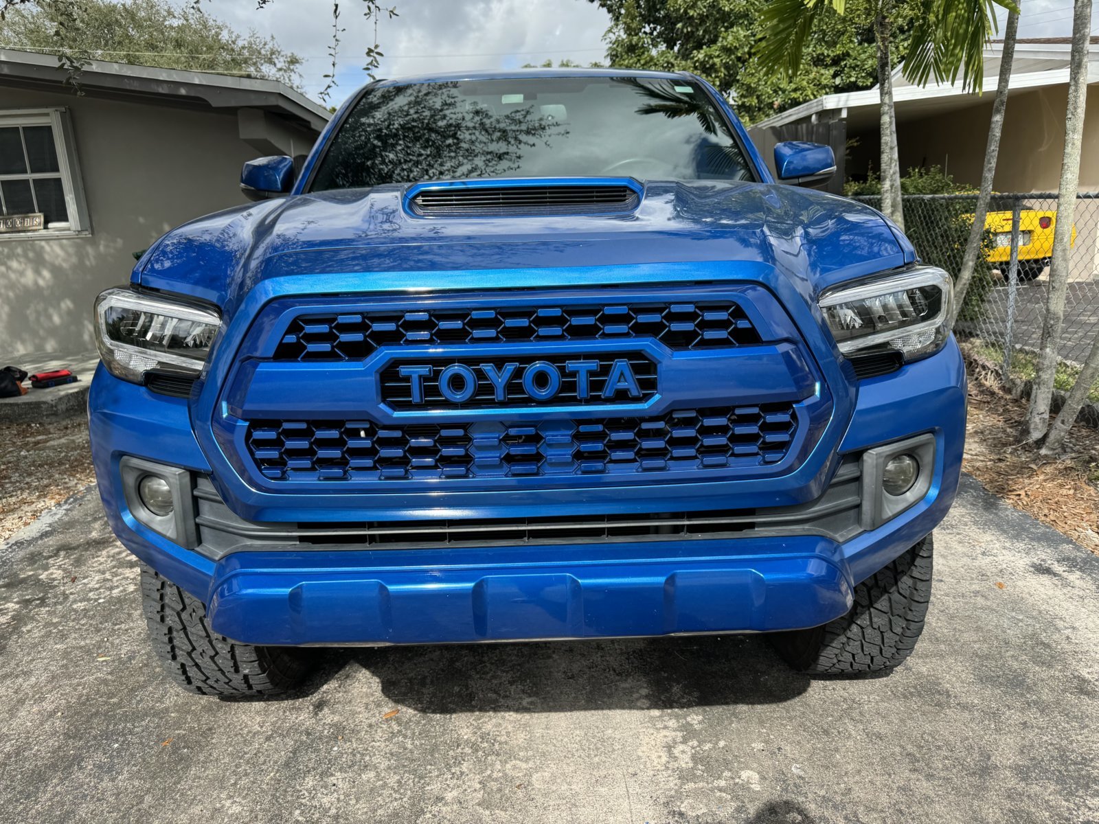

    Did my install today. Here are my thoughts…
    * whoever decided to hire an accountant to engineer this truck at Toyota is an idiot. Who in their right mind would install a bolt behind a fender and under a bumper cover to secure a headlamp. That was a pain in the ass to get to.
    * when installing the FBC harness, be sure to check the orientation of the high beam/ ground connector when plugging it in. Plug it in wrong and the high beam will not work.
    * be very careful when wiggling / finessing the lamp into place. I slightly scratched the corner of the lens with the fender. Nothing major.
    * lastly, have extra fasteners handy if your truck is on the older side. Mine is a 2017 and the push pins / fasteners / clips were brittle and broke a few.

    So first review of the headlamps…. They have a MUCH wider light output than stock! Anyone else notice this?
