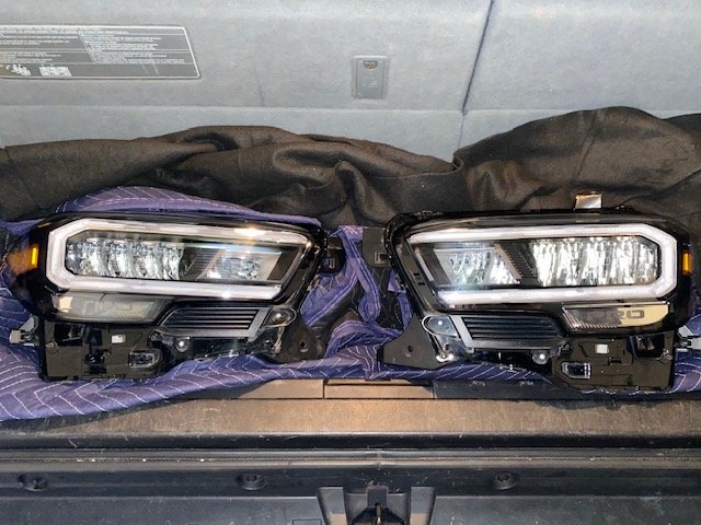

    How long does it take you to do the swap?
    I have the lights from a 2023 Pro, and just received harness kit from Dave, have got to leave for work at 6 in the morning.

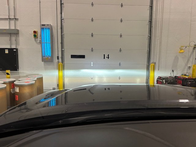

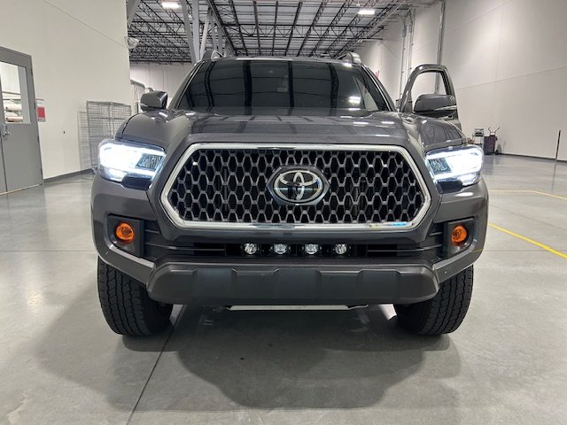

    Trick or Treat was rained out, so I decide to work on it. All done in an hour and half and I wasn't rushing. I didn't take the bumper off. The biggest issue for me was the passenger side bumper corner wouldn't release. I came back inside and watched few videos, one of them said just yank it. It was all it took.
    If I were going to do it again, I would wear my welding sleeves. Lots of scratches on my arms.

    Huge differences between these and the factory halogens. :101010:
