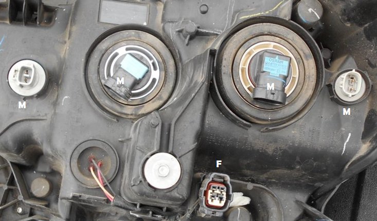

    Thanks to all TW members for the info you’ve provided in this post especially @caribe-makaira, today I made the conversion adapter for the LED headlights!
    I just need some adapters that I’m ordering from China but I tested it out and it worked.

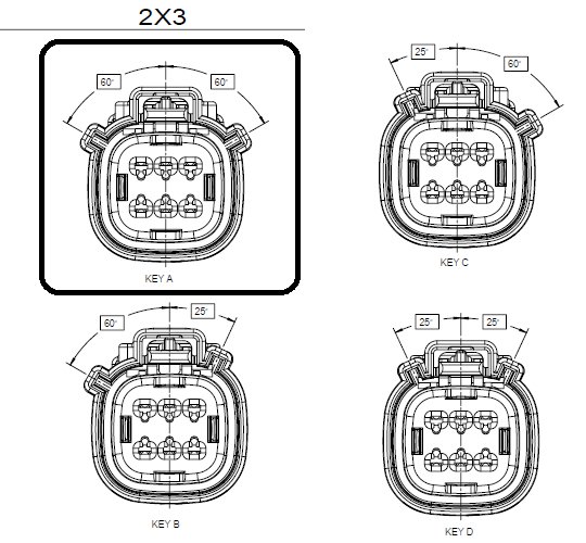

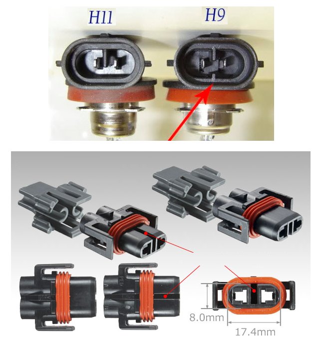

    So based on what Caribe posted, are these the right connectors? No idea which of the Molex connectors is the correct one since there seems to be a Key A and Key C?
    Molex MX150 Connector Female (33472-0601 key A/33472-0603 key C)
    Key A https://www.corsa-technic.com/item.php?item_id=1005&category_id=191
    Key C https://www.corsa-technic.com/item.php?item_id=1008&category_id=191
    H11 https://www.amazon.com/Adapter-Harn..._1_7?keywords=h11+male&qid=1572113412&sr=8-7
    H9 (possibly the same as the H11 with a little modification)
    DRL Connector (90980-10869)
    https://www.corsa-technic.com/item.php?item_id=895
    Turn Signal Connector (90980-11486)
    https://www.corsa-technic.com/item.php?item_id=1165
