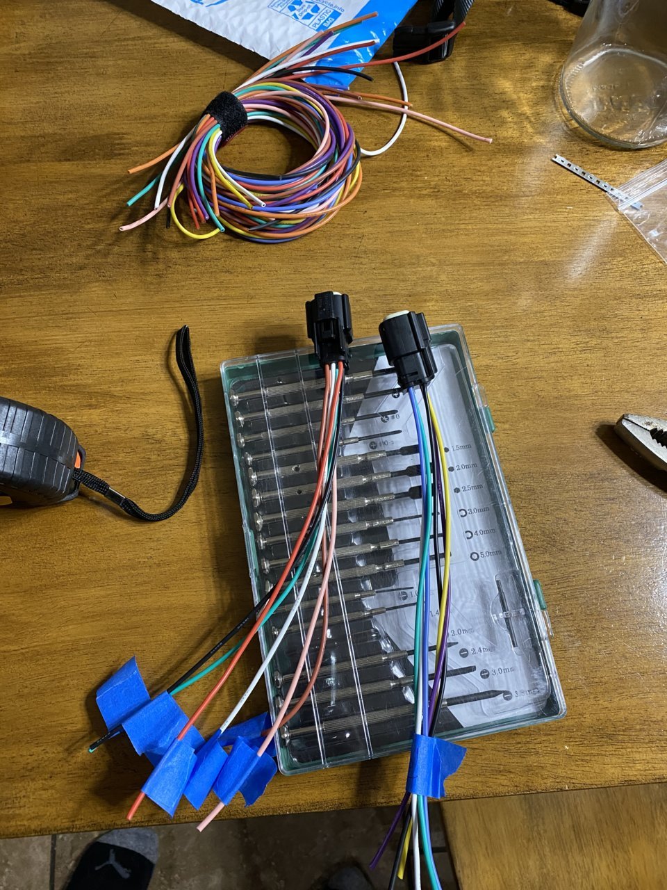

    You’re da man!

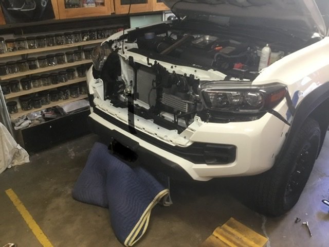

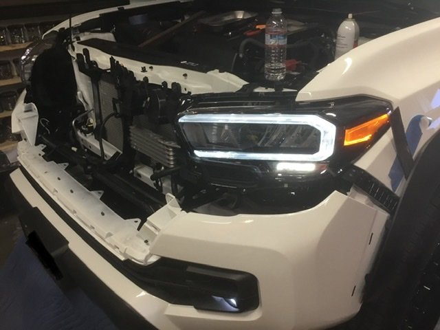

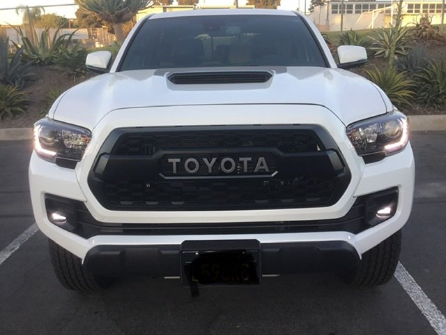

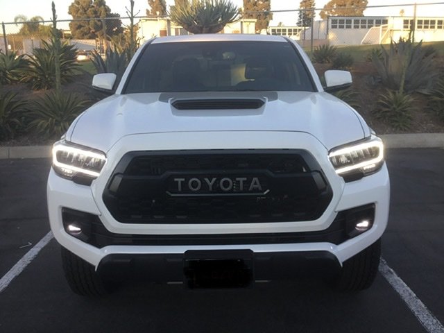

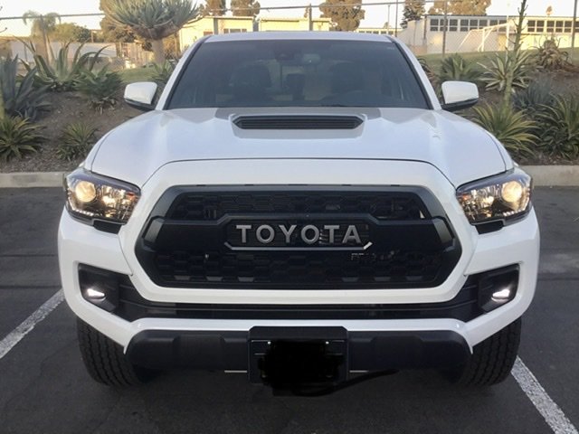

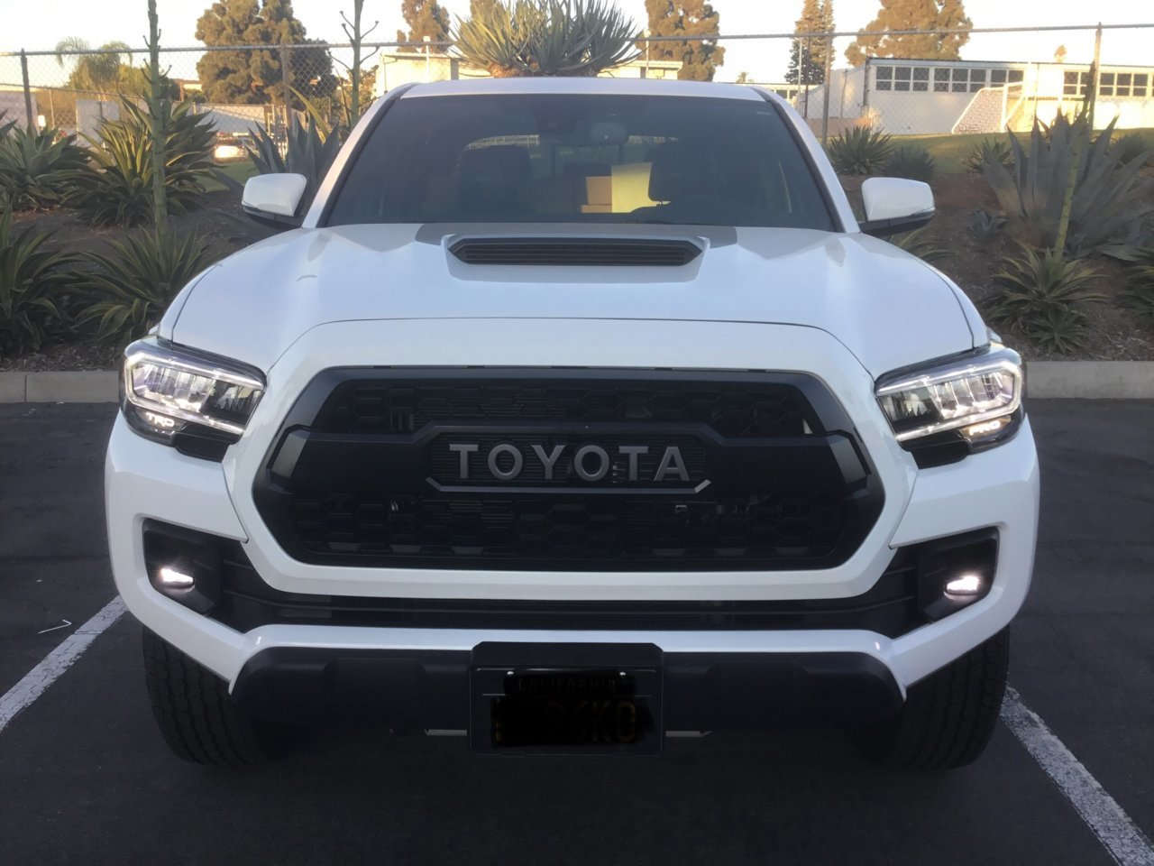

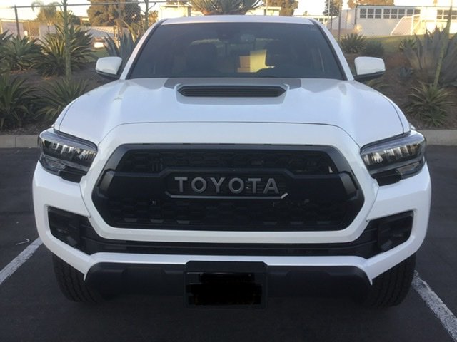

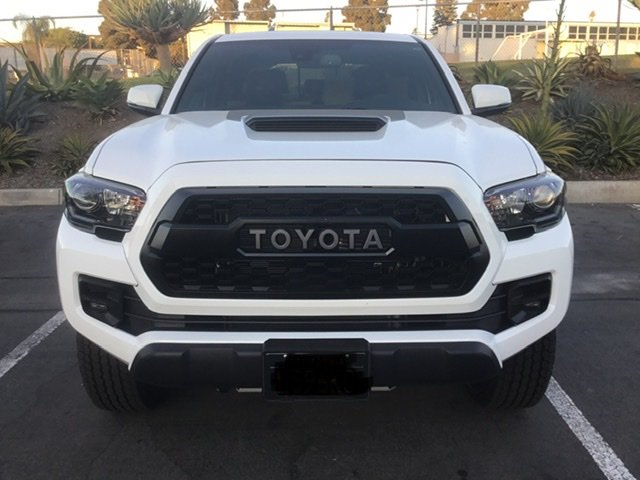

    Recently converted my 2019 Pro and I am VERY pleased with the results. From start to finish the conversion took me about 2-hours because I was VERY careful with every step. No broken clips, fasteners, scratched headlights, etc.
    The 1st step is to disassemble the front end

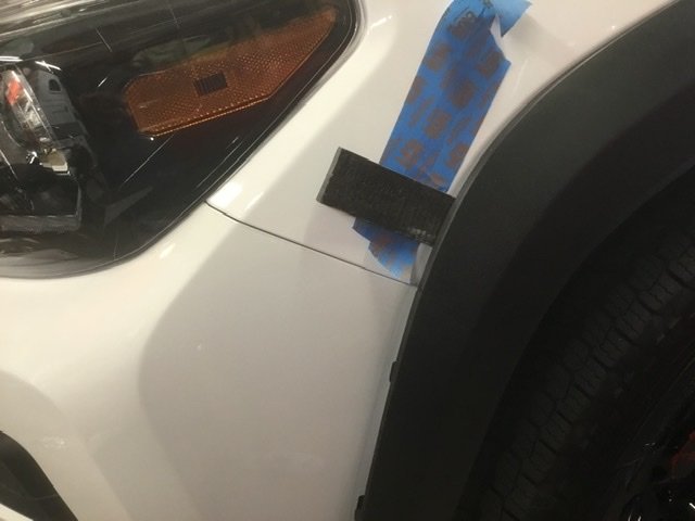

    I used extra care removing the fender flares to avoid damage
    I then marked the “low” beam with painters tape because the L&H beam connectors are identical looking. I then proceeded to R&R each headlight assembly. The headlights are held in with 3 fasteners and one “slide” connector. It slides from side-to-side, do not pull forward! I then plugged in my conversion harness to my existing headlight connectors and then plugged the 6-pin harness into the new 2020 LED headlight and verified everything worked before reassembling
    Here are some before and after photos

    Plugs for the sidemarker connectors that are unused (protect the terminals).

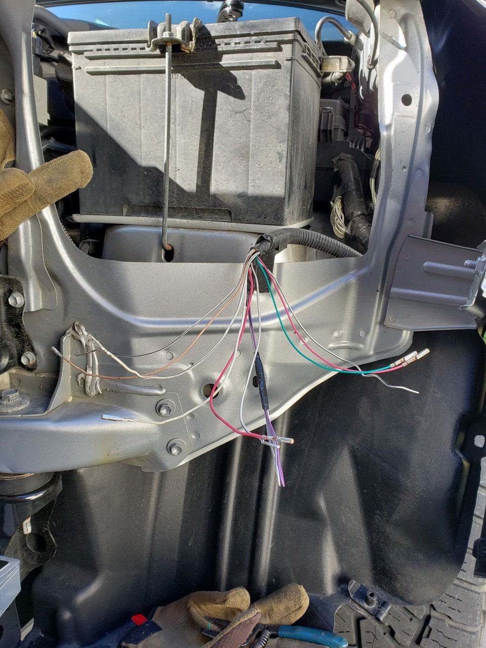

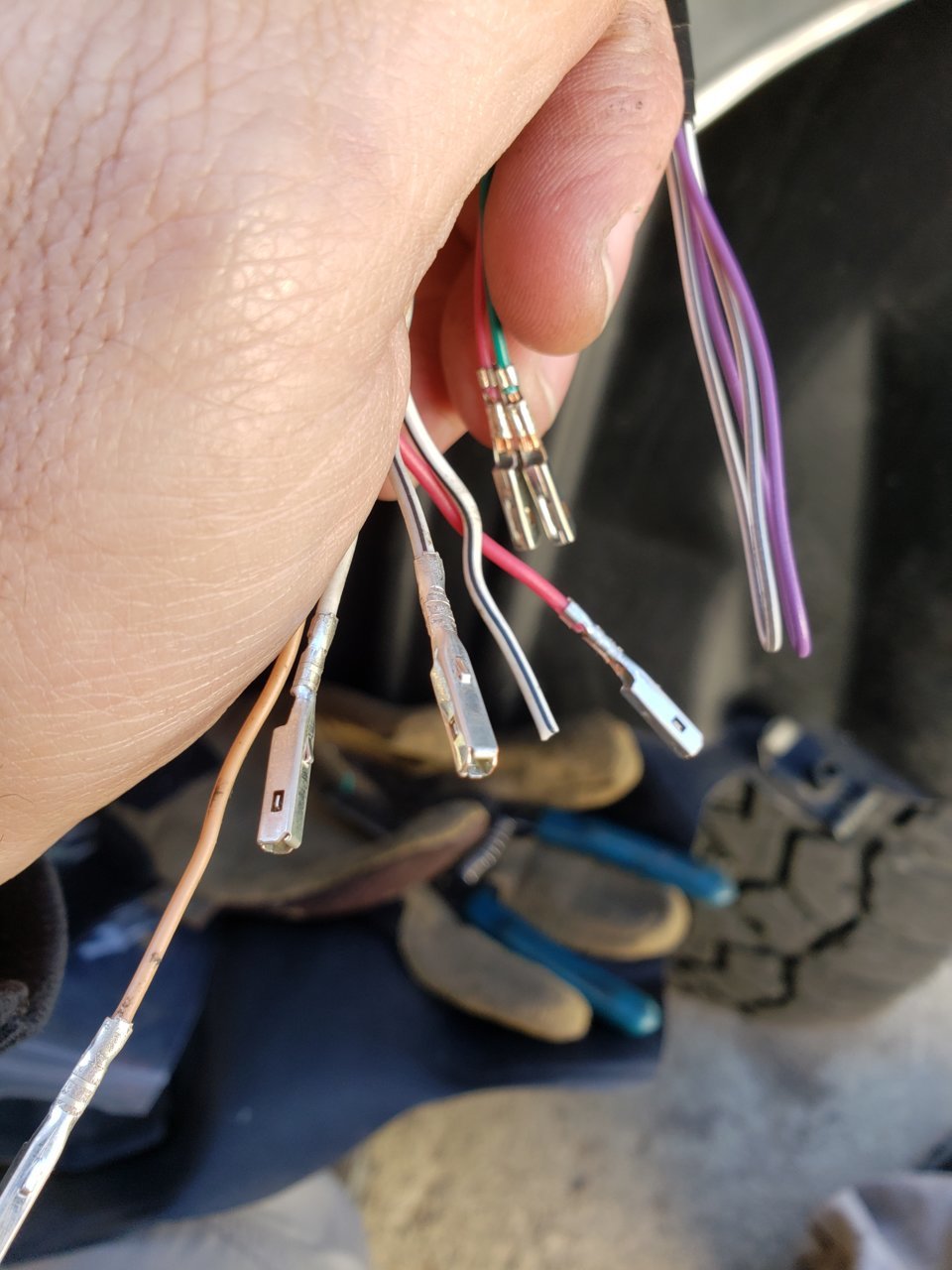

    $85 for an adapter isn't a bad deal.
    I spent $20 on 2 Molex connectors and $20 on a molex crimper. I then spent about an hour slowly cutting, taping off and re-insulating/wrapping the wires.
    I enjoyed the process, but not everyone else might.
    Depending on your time and skill level, the adapter seems very well priced. I did leave tails on my old adapters, so switching back, if I were to, would not take too long, but I would have to solder the wires. The adapter allows you to simply unplug them.
    I prefer the rewired connectors, but if you don't have the stomach for it, adapters would be good.
    I also was impatient and adapters were no where to be seen...

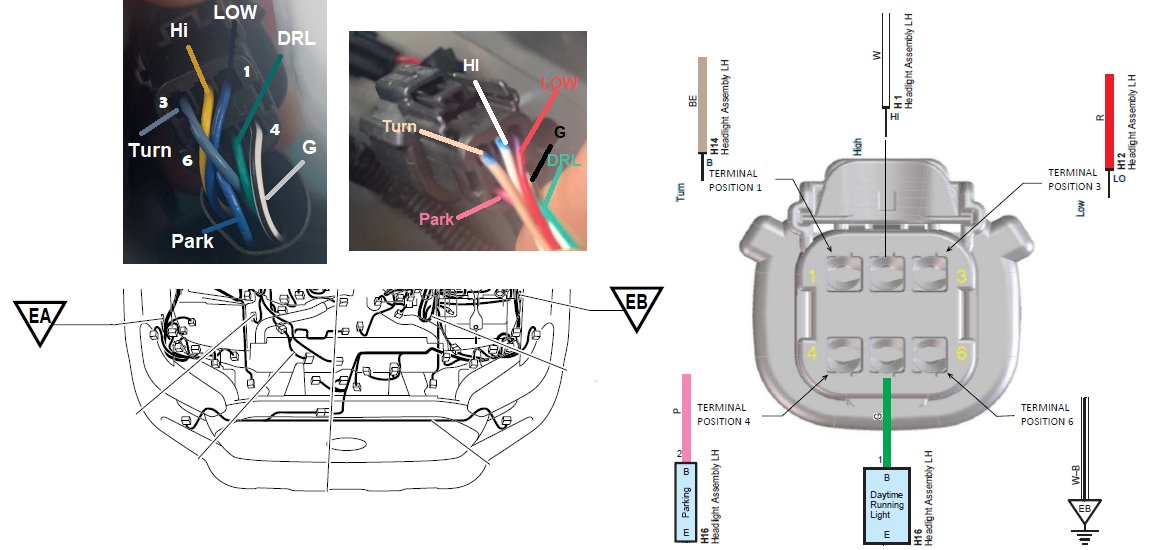

    This pic contains all the info you need for the color codes if you wanna be brave and start cutting.
