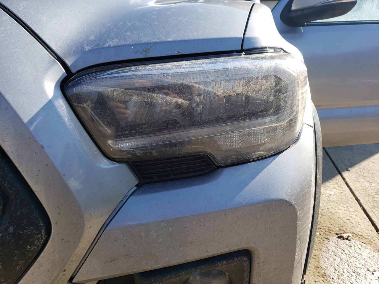

    I just didn't see this 3/4" strip being worth the hassle. Luckily my truck is Silver, But I have debadged and replaced the chrome caps on my truck, so i'm certainly not pro chrome.
    You can not see it from the front regardless. In the sun, you can't really see the chrome strip due to the housing glare on the side either.

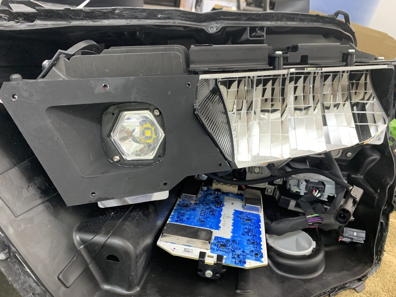

    Yes, there is a twist cap at the bottom of the housing. Theoretically you reach in from that hole and unplug the lower PRO light. It’s
    Just a harness that plugs into a LED board and projects the light behind the logo.
    best pic I could find

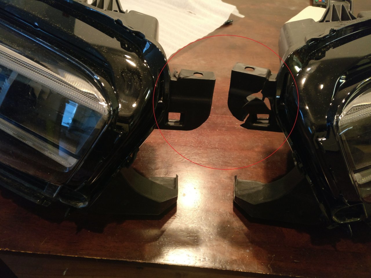

    There will be a lot of broken ones too. In my case the tabs that were broken during shipping were the ones that hold the Grill. They are not that hard to fix, but I'm not keeping a mended light that I paid a good chunk of money for.

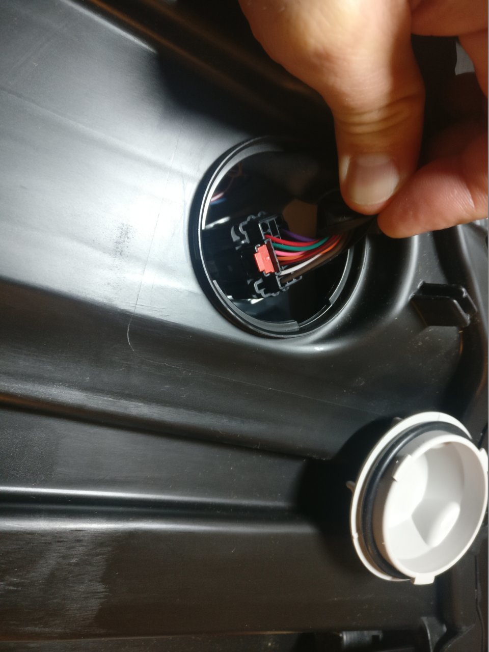

    I assume this is the twist CAP MESO was referring to. You can access it without opening up the headlight although I don't think it will be too accessible with the headlight mounted on the truck. Sorry for the picture quality, if someone needs a better picture I can take it outside to get a better one.

    That's the connector to disable the "PRO" illumination? Sorry for the dumb questions. I could live with the logo etched, but not illuminated and is probably the better compromise. I don't have the headlights in hand (or the funds) at the moment, so I could easily disable when the time comes.

    That’s the main connector for the DRL side marker and pro. There will be a smaller connector tucked up higher to just disable the logo
