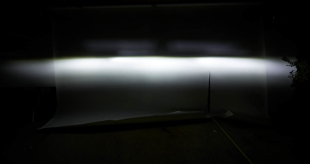

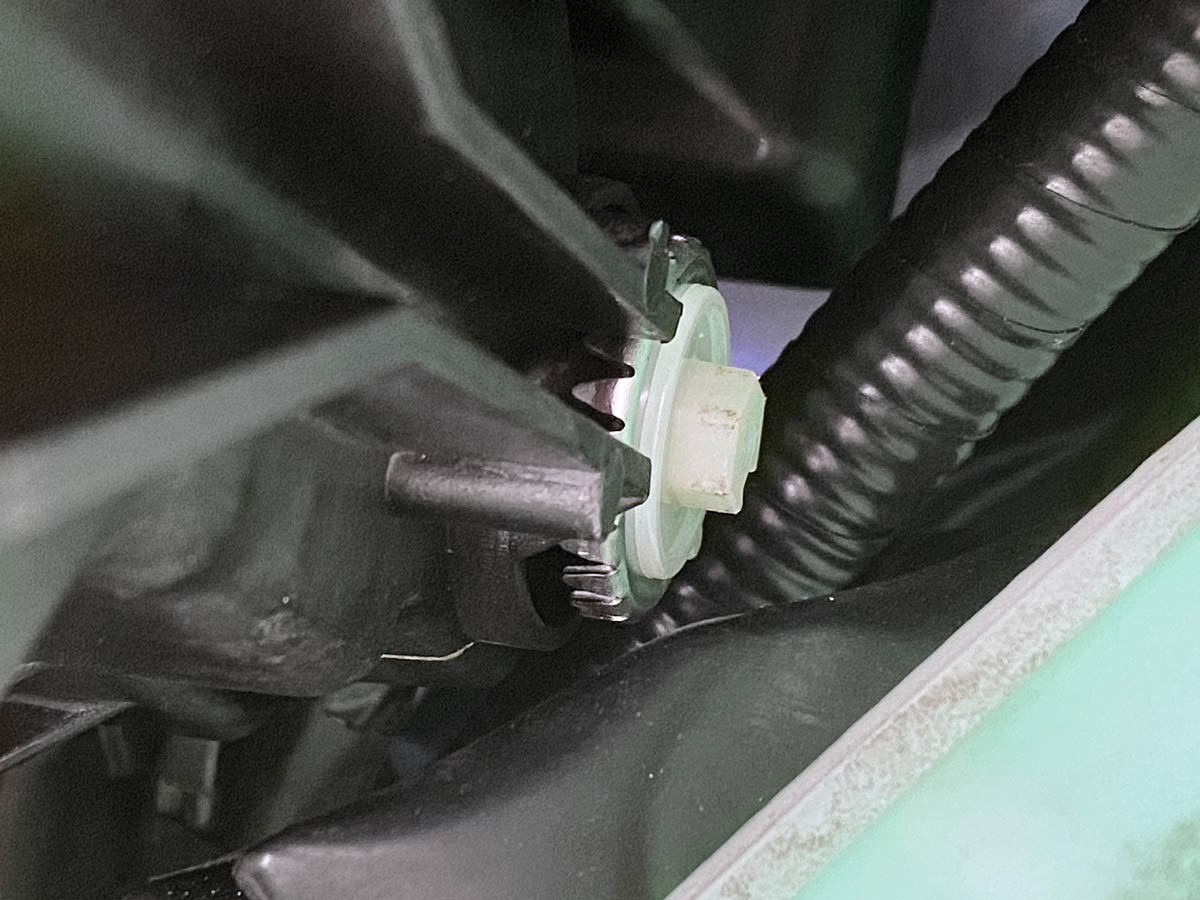

    Did you adjust the headlights after install? I just did mine last night and my beam isn’t perfectly straight like yours. How do you adjust the beam?
  9. Jan 25, 2020 at 7:41 AM
    #789
    Sasquatchian
    Sasquatchian Well-Known Member
    May 30, 2018
    #254922
    723
    Yes, my lights have required aiming after installing. There is a single white plastic 8mm bolt on the back of the light. The driver's side is easily accessed without moving anything but I find I need to remove both of the bolts holding the windshield washer reservoir on the passenger side to move it slightly out of the way to get easier access to that side. If your hands are smaller you might not need to do that. I'm using a small 8mm ratcheting box end Craftsman wrench. Since there are virtually no shops with a proper beamsetter for alignment, even here in Los Angeles, it's been an iterative process to get them correct and it's actually quite a bit more difficult to do compared to the projectors since the beam cutoff is considerably softer with these new lights, and seems to be even softer toward the far edges of the beam.

    Or you can use a Philip's screwdriver for the passenger side headlights to adjust.

    There's only about an inch, maybe less, of clearance between the adjuster on the passenger side and the wiper reservoir. Even a stubby Phillips is way too long (and fat) to get in there. Take less than a minute to take the two retaining bolts for the reservoir and move it an inch back, which is about as far as it'll go without fully disconnecting it, but that's all you need.IMG_1017.jpg

    You’re supposed to use a long Phillips and stick it down that channel that leads to the adjuster. The screwdriver and the teeth on the wheel act like gears to turn the adjuster.

    Oh, ok. Now I got it. Sorry for the misunderstanding.
