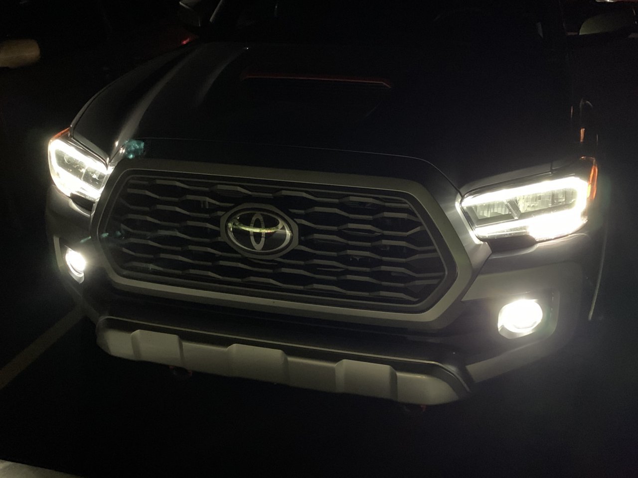

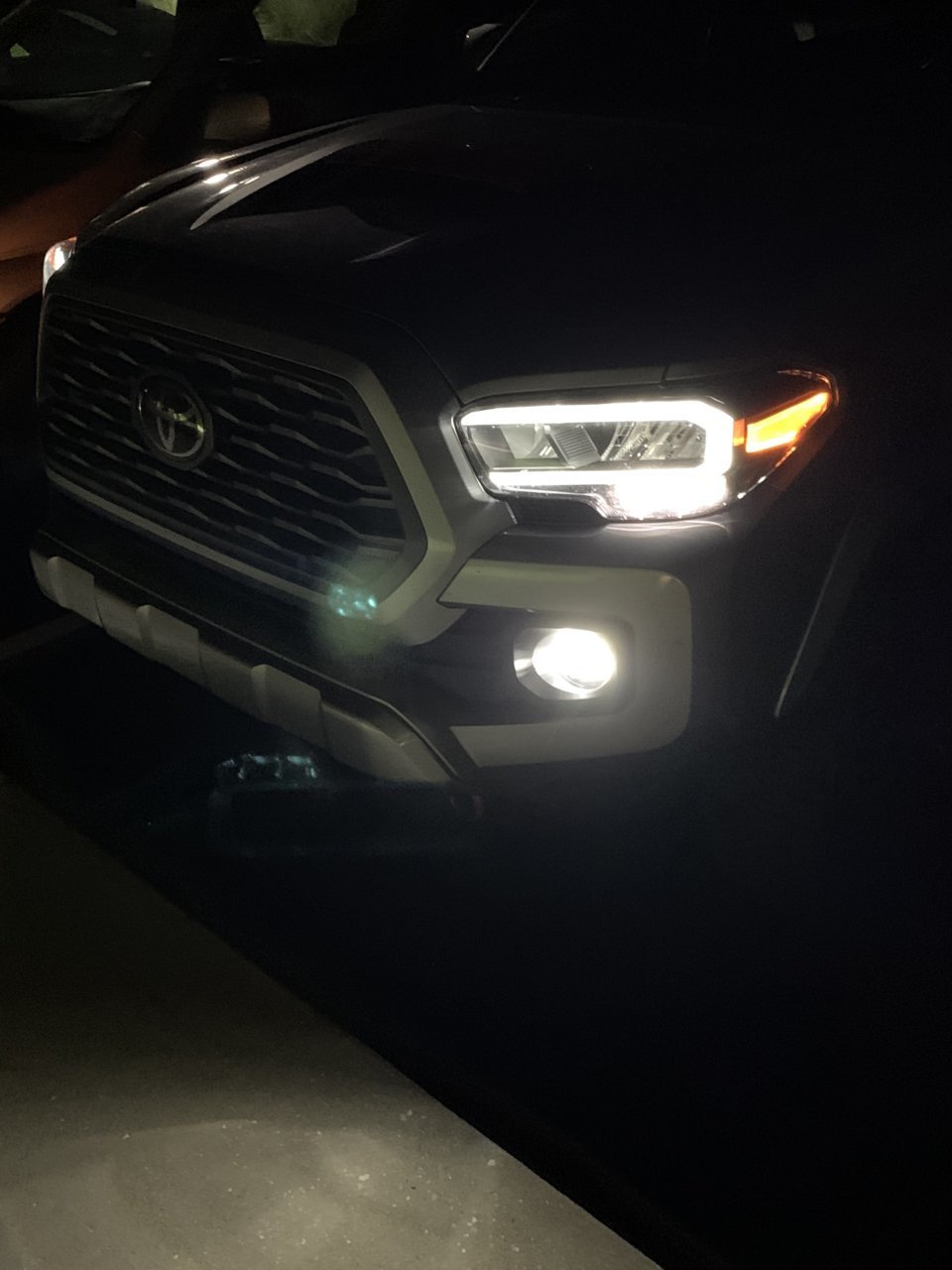

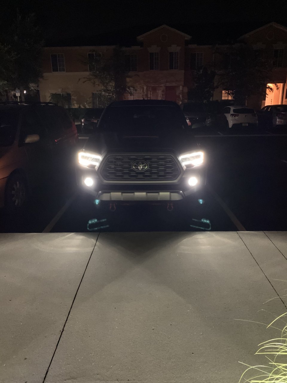

    LOVE these babies!!! They totally make the truck look so much sexier!! :cool:

    Nice!
