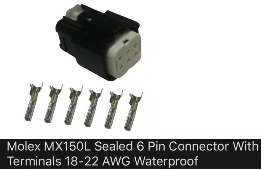

    2 sets of these...Cheaper, faster and DIY...
    P.S. It should be MX 150...the MX150L are larger.

    What are the 2 loose plugs in xrunners kit for ?

    plugging two connections in the harness that are not needed for the LED headlight

    ^ yes for the halogen headlights. It’s acts as a cap

    To cover the side marker connector. One per side. Or to use it to add another light that you'd want (terminals added) that'll illuminate when Tails/Parking are selected.

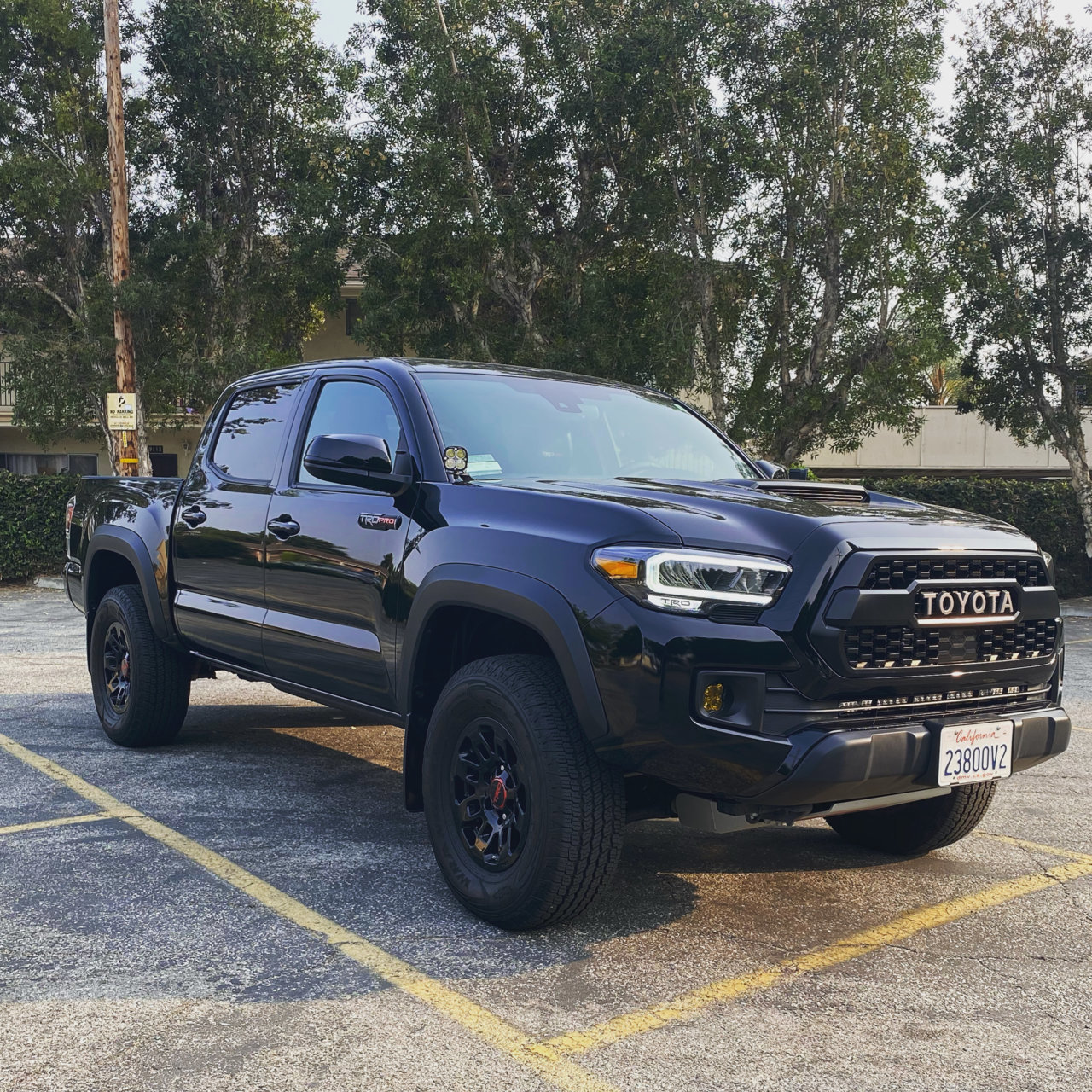

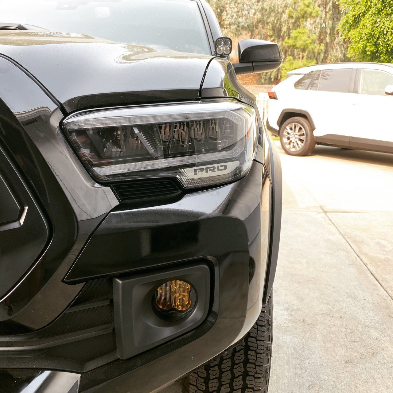

    After months of debating and waiting I finally pulled the trigger and went for it! I wouldn’t say that there’s a major light output difference when it comes to light intensity, but definitely a noticeable spread in coverage area. Loving the look! If you need a wire harness hit up Mike (xrunnerdude67), I was skeptical about sending a complete stranger money, but he is 100% legit.
