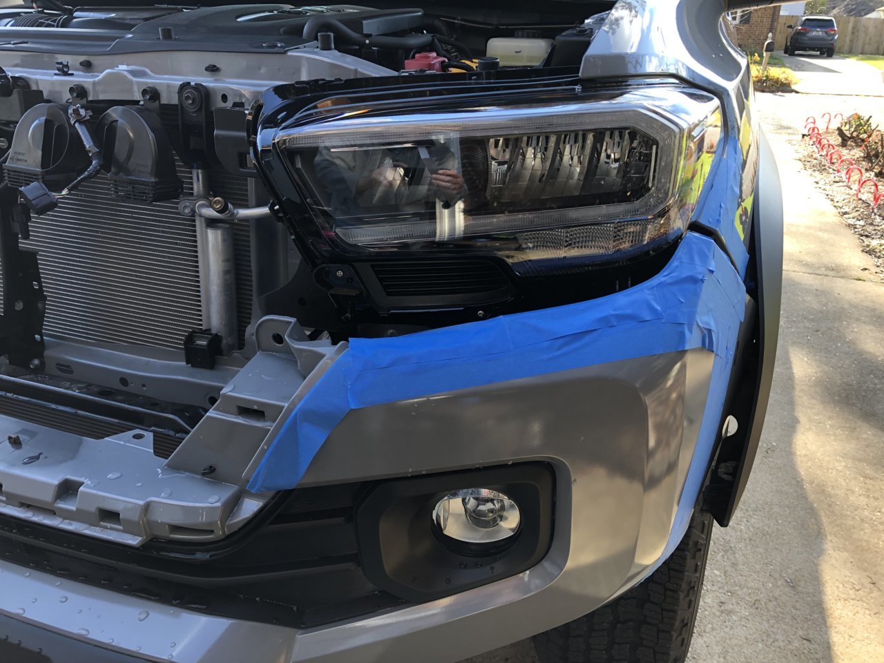

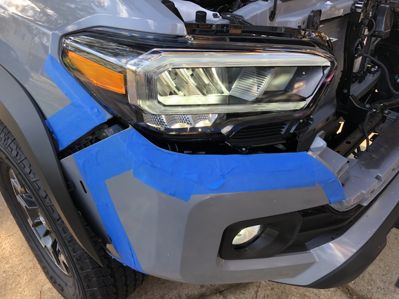

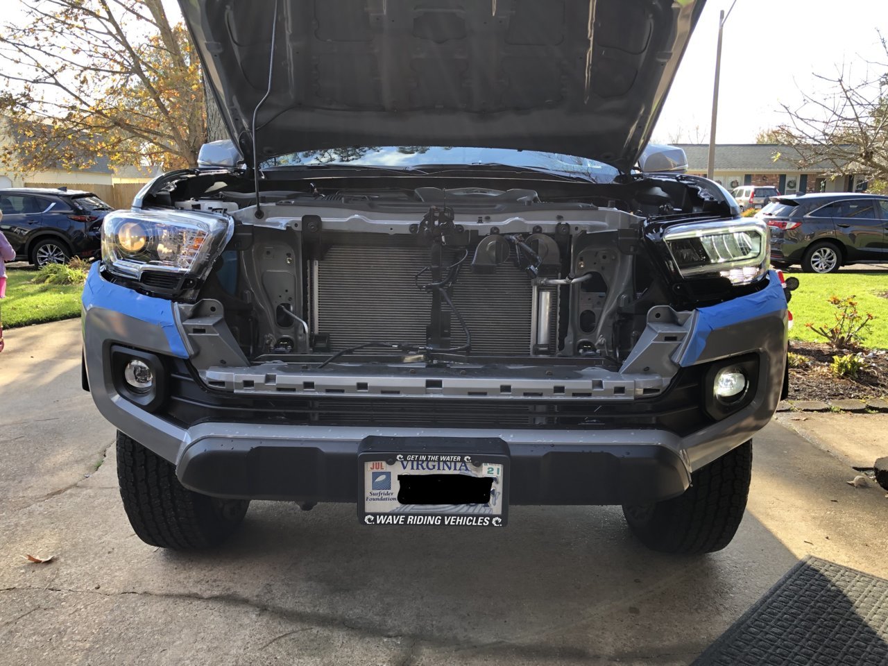

    Got mine installed this morning and my wife said they look more beefy. Lol. Loving the drl’s and don’t think i need to align much if any. Came pretty level with the old halogen’s but i’ll drive some tonight and see. Took about an hr and half. Pretty easy just have to go slow and mask the bumper in places you may bump or scratch. Also covered the lenses until the lights were bolted in. Didn’t force anything in but just went gentle and let the housing line up to the mounts. Tested all functions like turn signal, hazards, parking and everything is functional. Matt’s harness worked perfectly. Can’t wait till it gets dark to take a test drive.

    That's awesome, congrats! We all love beefy!
    Did you have any issues with the clip's? Was there a particular youtube video that helped on the process?

    After the grill was off, then removed the plastic dividers i was able to reach in to the clips on the black fender and release them while pushing outward without damaging any. Worked for both sides and slowly popped the bumper off the mounts to get to the side bolt. Loud pop but thats normal. Only needed to drop bumper enough to get that one side bolt. I did watch this vid and it gave me a general idea how to remove the bumper when i was deciding beteen OEM or Morimoto’s.

    I taped my fenders just like you did and also taped the headlights just in case. Congrats. Looks awesome

    This is great advice, especially the headlights. I didn't and have a scratch :(.
