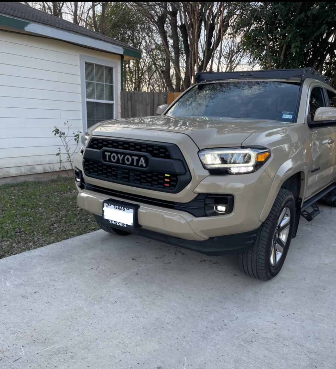

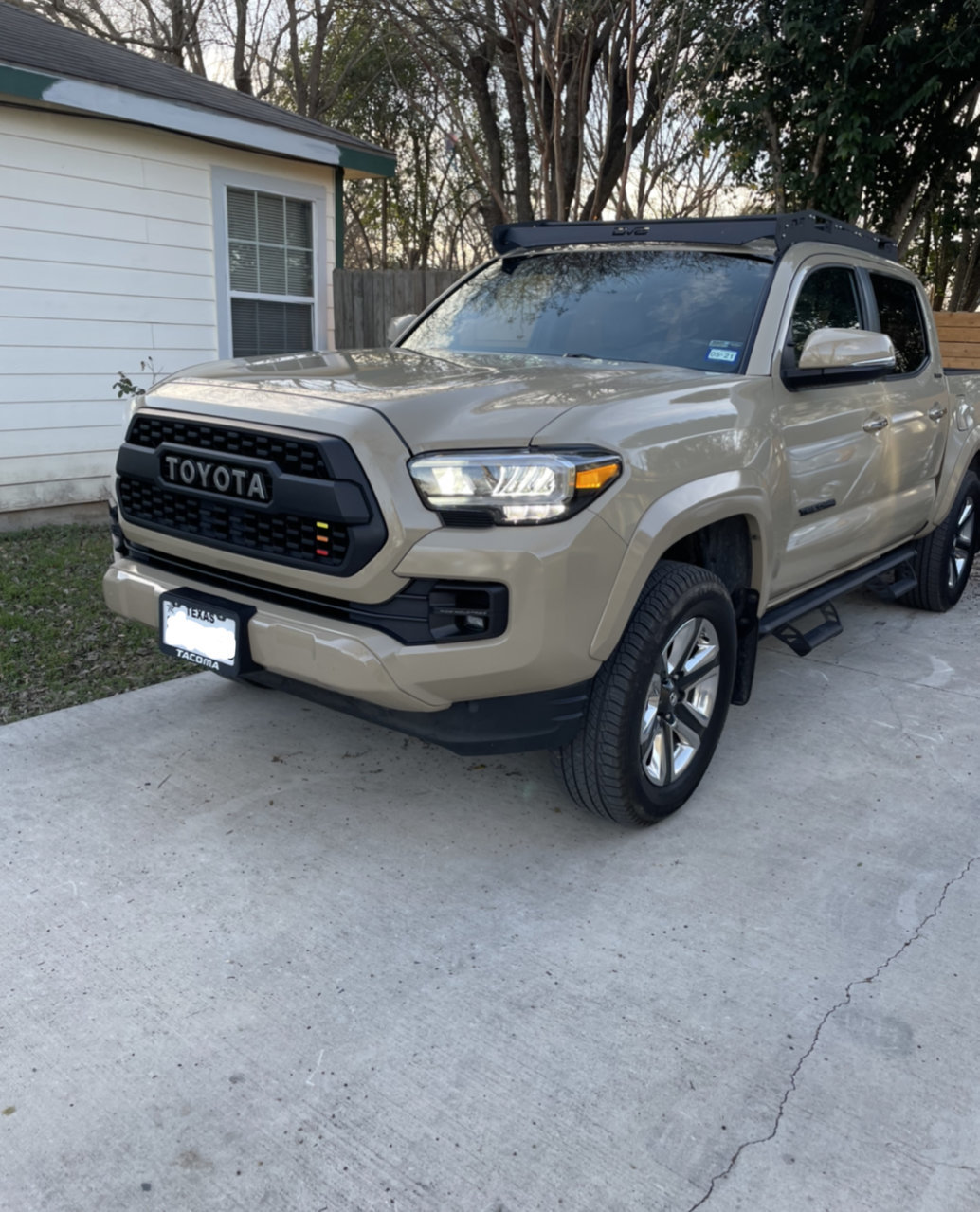

    Can some one help? I installed these led headlights and I think the hi and lo is reversed. The picture with all the lights on is the hi beam and the other picture is the lo beam. I only ask because I keep getting flashed at night.

    Yup. They're swapped. And I think I read something about the retrofit harness having that issue.

    Yes it is reversed.

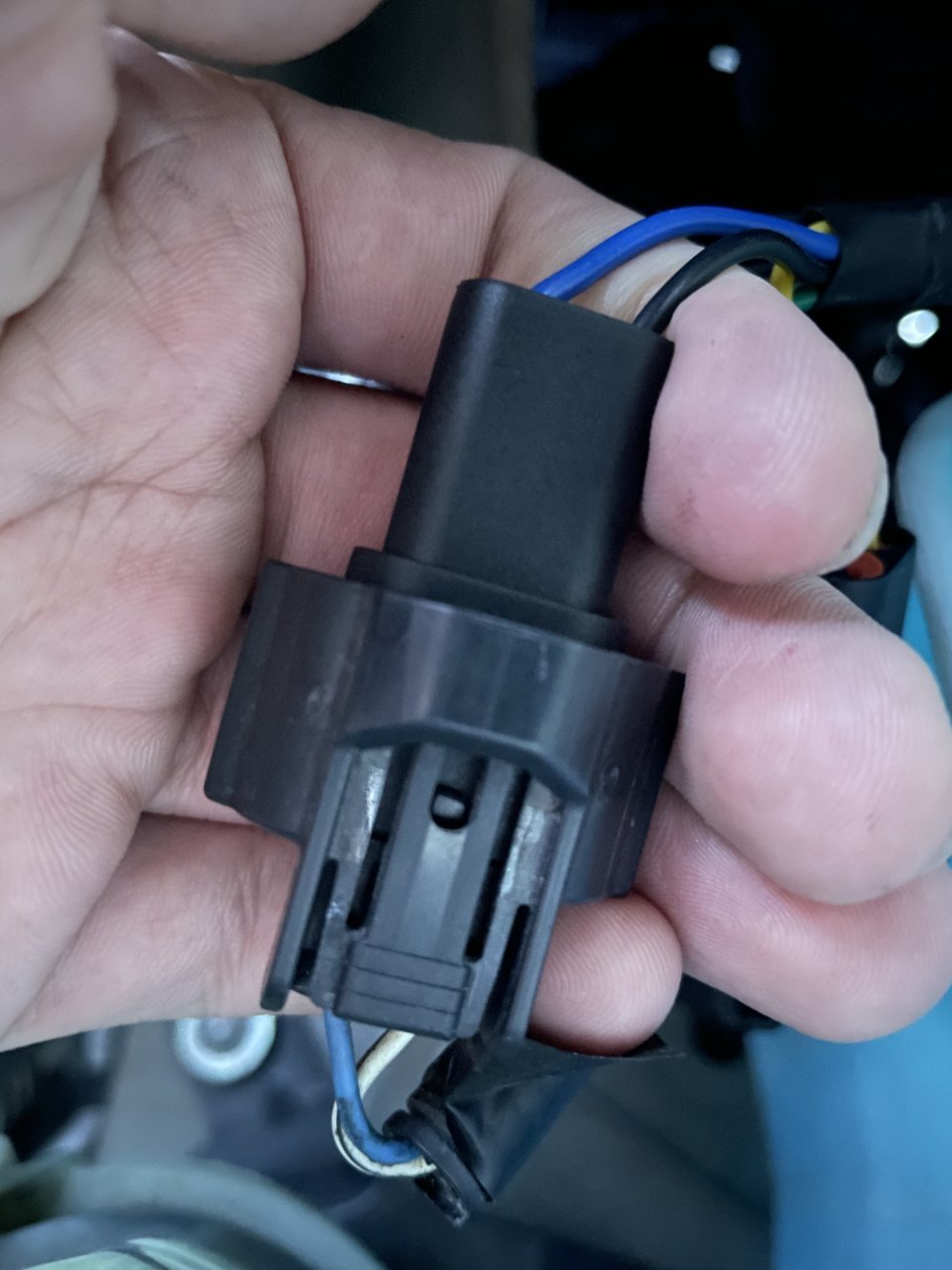

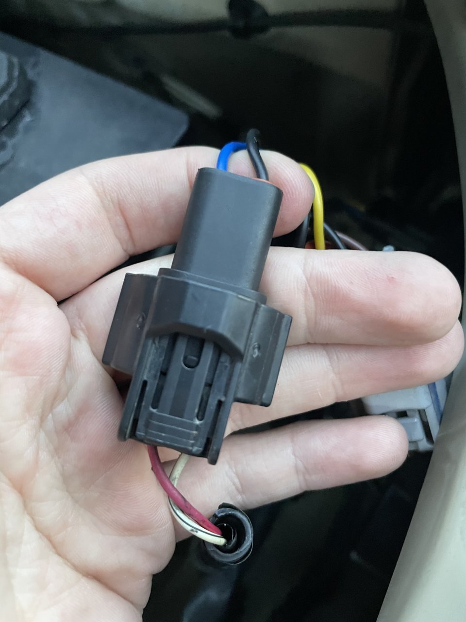

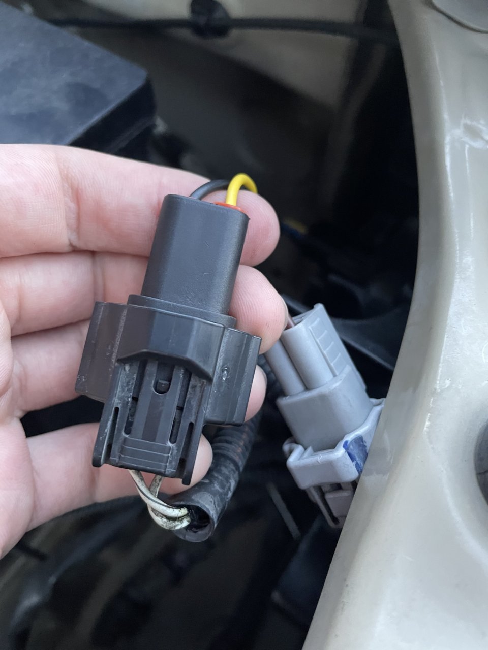

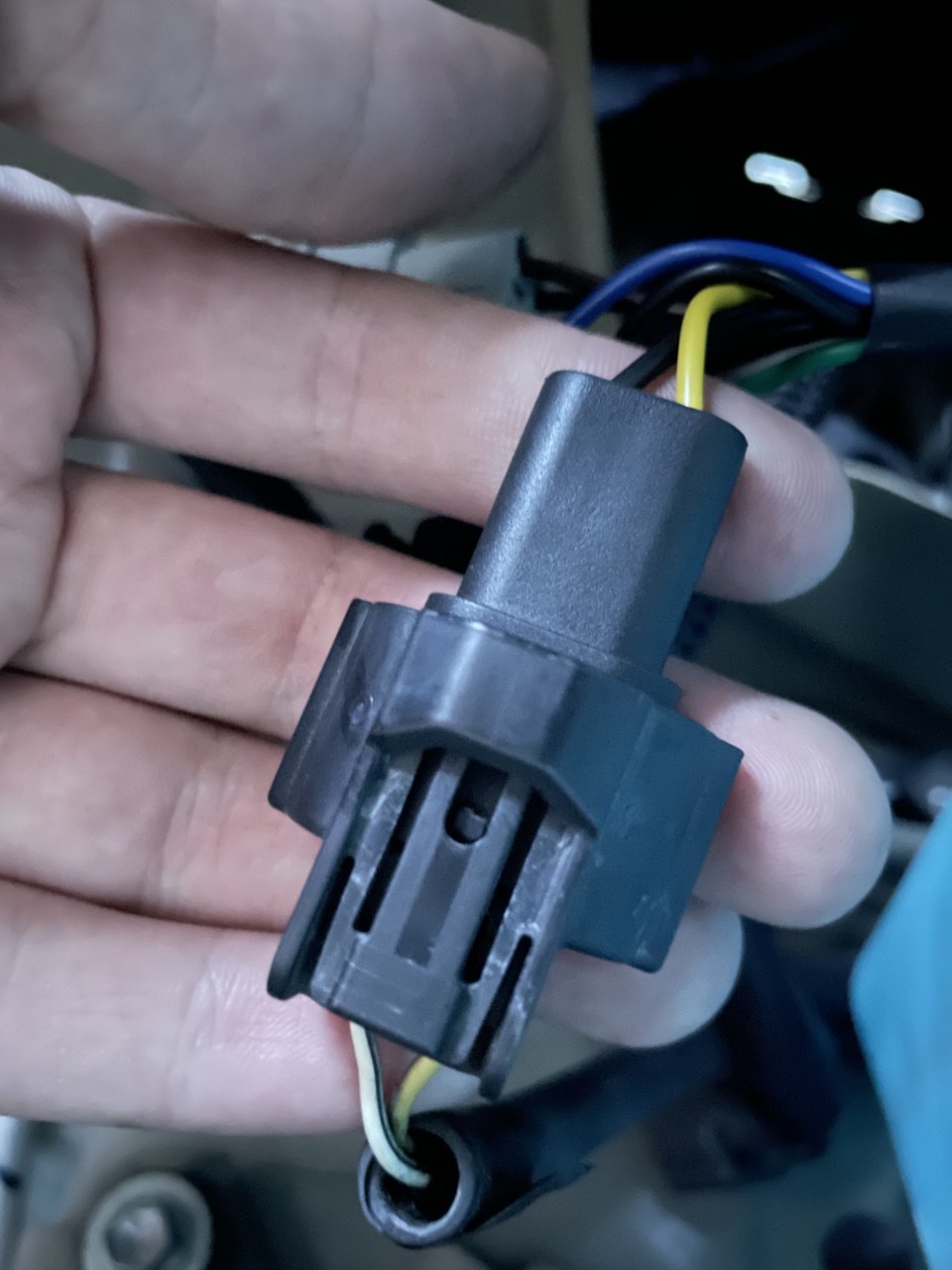

    Actually I just answered my own question. the hint here was matching the blue and yellow wires on the passenger side. I had to turn the plug around the only thing is the plug doesn’t snap in.
    Here’s pictures of how it should look in case anyone has a similar issue. First two pics are driver side second two are passenger.

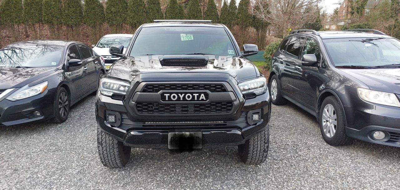

    Had the custom 2020 LED headlights installed on my 2017, while truck was getting a touchup. Didn't realize how bad the projector HLs were until now. Thanks Kevin.
    @ novtec4me
    tektaco84, Glaese and Tacospike like this.
