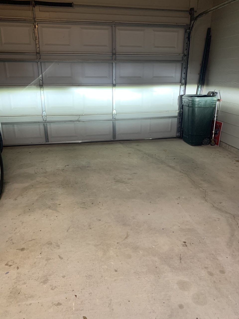

    I just received my LED headlights in the mail and will install them after my harness from Mike shows up. Am I going to have to adjust the headlights so they line up and arent blinding people? If so, how do I go about that? Thanks

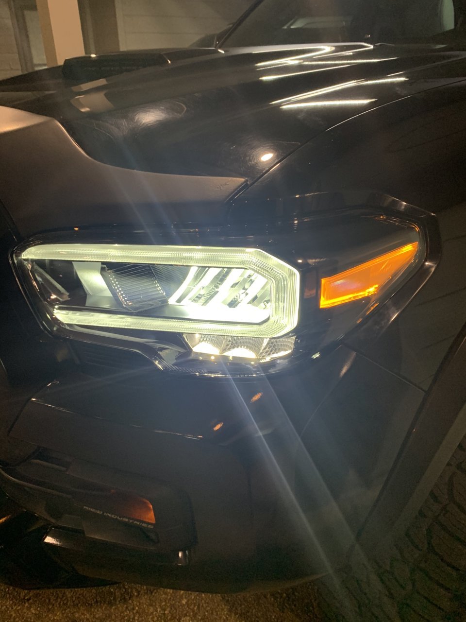

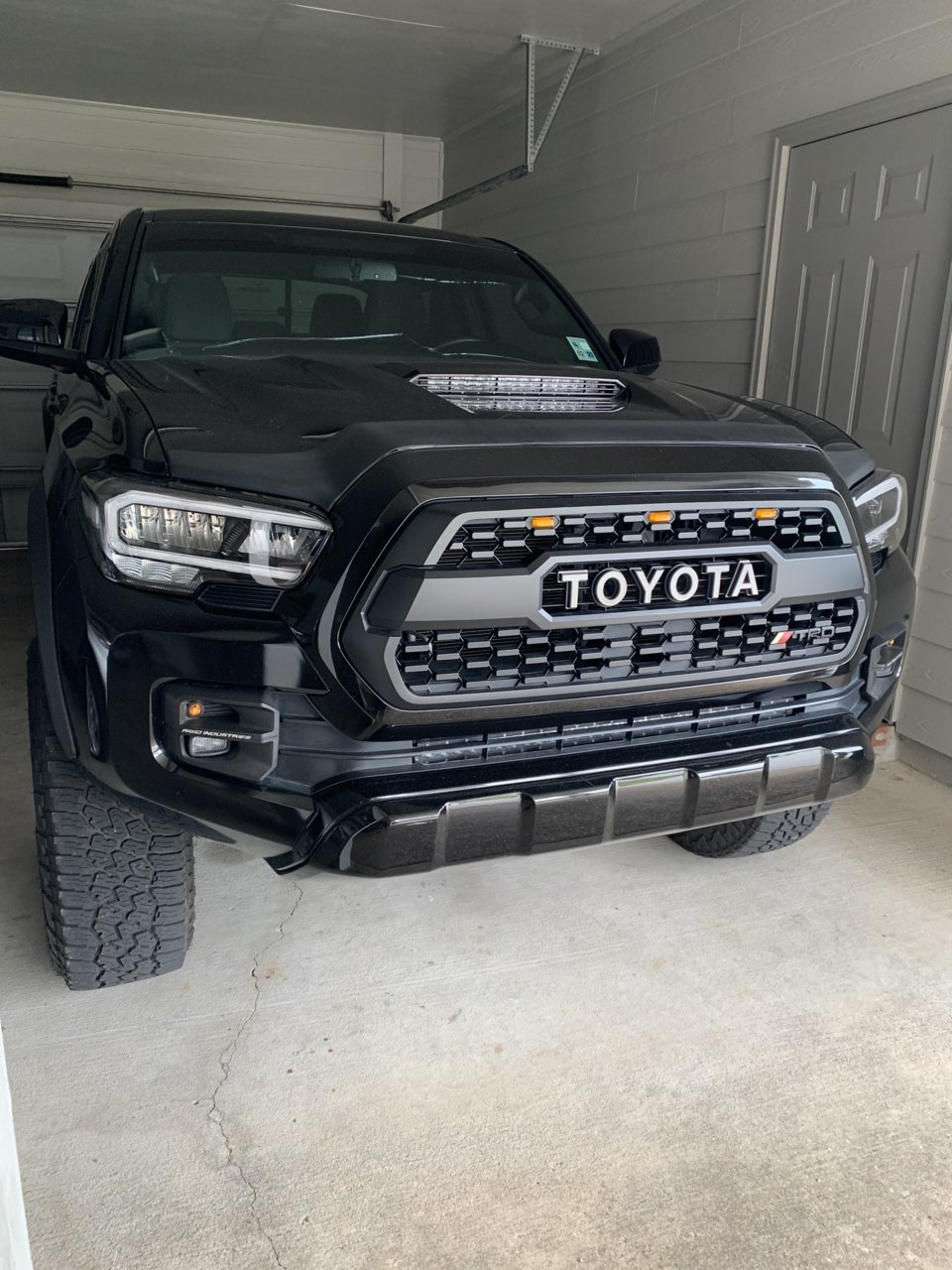

    Got mine Tuesday. After installing, I pointed them at the garage door (I had marks from my previous lights to compare). Had to lower the driver side a few inches, that was it. I used a philips screwdriver. There is only one adjustment, and it is easy and self explanatory. Turn it one way to go up, the other way to go down.

    thanks man, truck looks hard bro wish i would have got black instead

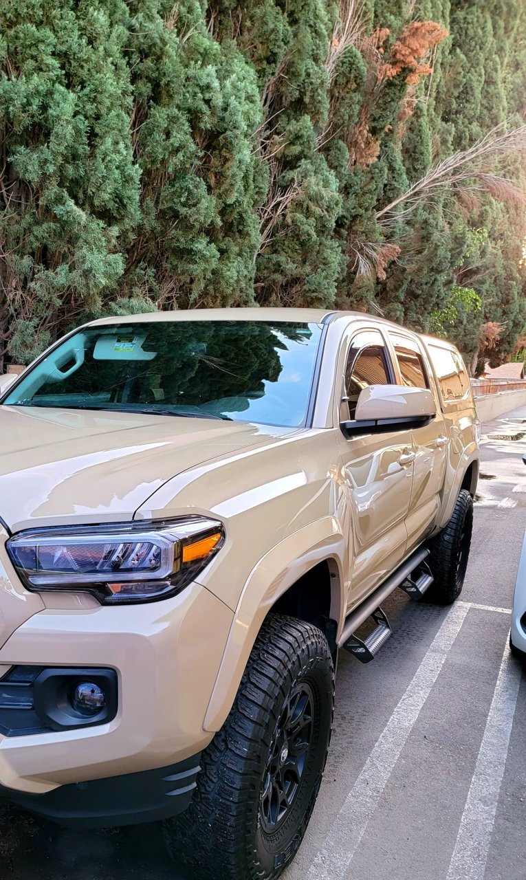

    What harness did you use for the sr5??
