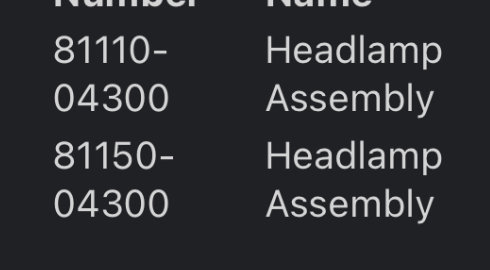

    by any chance do you have the part number?

    SAPR53 Well-Known Member

    thanks.. just wanted to make sure i had had the correct part#

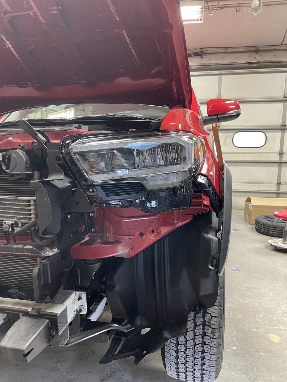

  12. Mar 6, 2021 at 1:25 PM

    Install today with mikes harness. Very happy with the results.

  14. Mar 6, 2021 at 3:37 PM

    Buddy’s body shop

    Why’d you decide to pull off the entire bumper instead of just peeling back to get that 10mm bolt on the side? Just curious for my future install

    I pulled my entire bumper as well. Partly because it was fun, partly to get a really good feel for what was going on, partly just because. In retrospect, it was a completely unnecessary waste of time.
