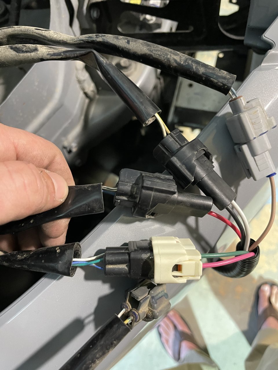

    Can anyone help me out not sure what to plugs into what.

    Green connector goes to the red guy, beige to the white + black.

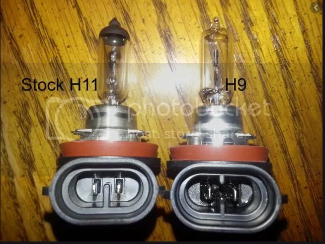

    Green connector is H11 (low beams) with 1 tab/nub, white connector is H9 (high beams) with 2 tabs/nubs.
    Mike's harness has low beam male input as red with no ground and high beam male input as white and black for ground.
    The grounds need to match up orientation-wise so you want OEM blue to Mike's red and OEM yellow to solid white, OEM white w black stripe to Mike's black.
    EDIT: Fixed some typos
    Also: Compare to driver's side where it should be a perfect color match (aside from OEM white/black to Mike's solid black) and repeat on passenger side where the colors of the positive leads are different.

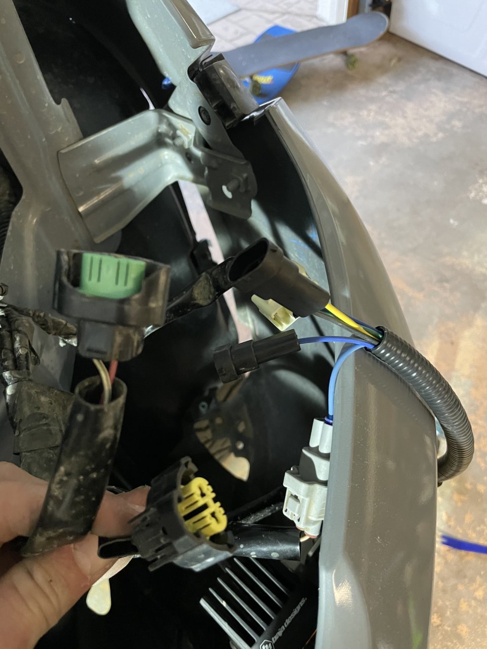

    oh man, I feel kinda dumb not picking that up but like this?

    That looks correct to me, yes. Test and confirm all is working properly. It should not be possible to damage anything if you have polarity or high/low swapped.
    High beams emitters are medial (to the midline), low beams are lateral (to the fenders).

    Thanks dude and driver side? Hopefully someone else finds this useful!

    OK, dude, this is going to kill me if you don't swap the two sides. Looks like the harness you have is perfectly color-matched all the way around, you just need to swap driver and passenger pieces. Then all the colors should line up perfectly.
    On the passenger side you did blue to red and yellow to white. On this side, see how you'd be doing red to blue and white to yellow?
    It'll work fine but oh man that would just kill me to not match the colors :)
