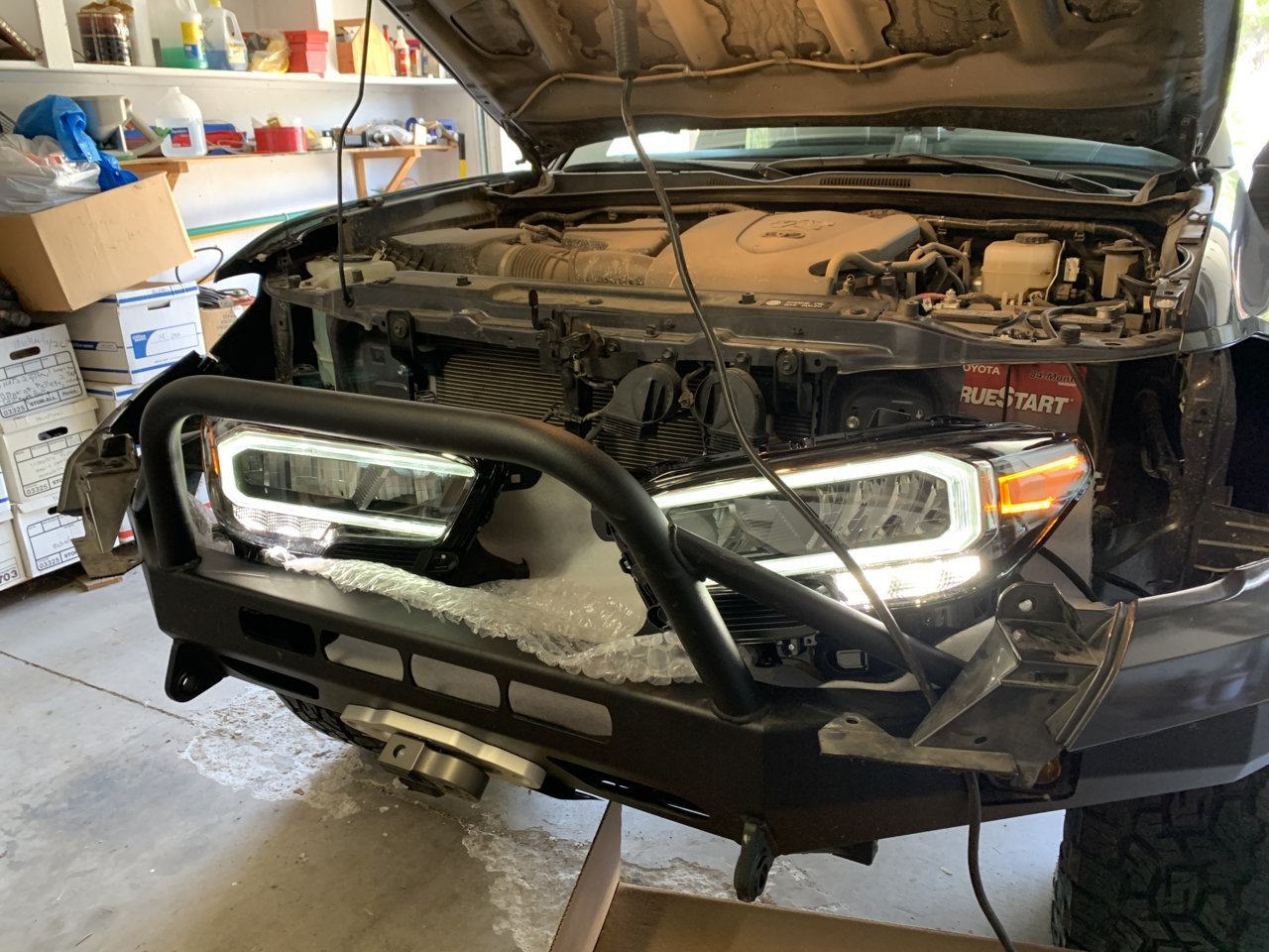

    Bumble Bee Tuna
    Bumble Bee Tuna Well-Known Member
    Aug 15, 2018
    #262891
    340
    SoCal
    18 4x4OR M/T
    1 dumb driver
    For anyone still ordering harnesses, I ordered mine from eBay with this guy $49 https://www.ebay.com/itm/2016-2020-Tacoma-Full-LED-Headlight-Conversion-Harness/143742838089
    I think he’s located in Southern California. No affiliations just looked it up online. No instructions came with it but super responsive via eBay messages. Worked well and appears
    well made like the others guys/companies mentioned on TWorld.
    FYI this thread cost me $1,3xx dollars. Purchased mine through Olathe Toyota.
    One tab came in broken, they were super responsive and swapped out the broken tab headlight for a new one.
    pic for reference
  13. Apr 17, 2021 at 3:58 PM
    #1753
    daveeasa
    daveeasa FBC Harness Solutions
    May 14, 2020
    #328079
    7,479
    David
    PNW
    2016 Tacoma OR DCSB 6MT, 2005 RC 5MT PreRunner, 2002 Tundra SR5 RCLB 4x4
    Wow that is solid pricing. Looks like nice quality too. Total no brainer. The connectors alone at $2-$4 a pop x 4 x 2 plus shipping are close to the same price.
    Probably only missing sidemarker caps? I have a 100 pack of those in knockoff style coming from China right now so if anyone wants caps hit me up.
