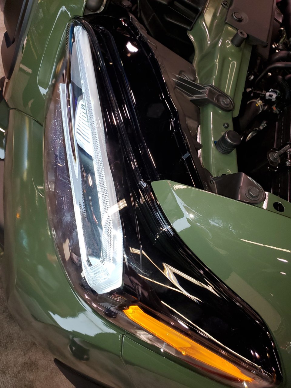

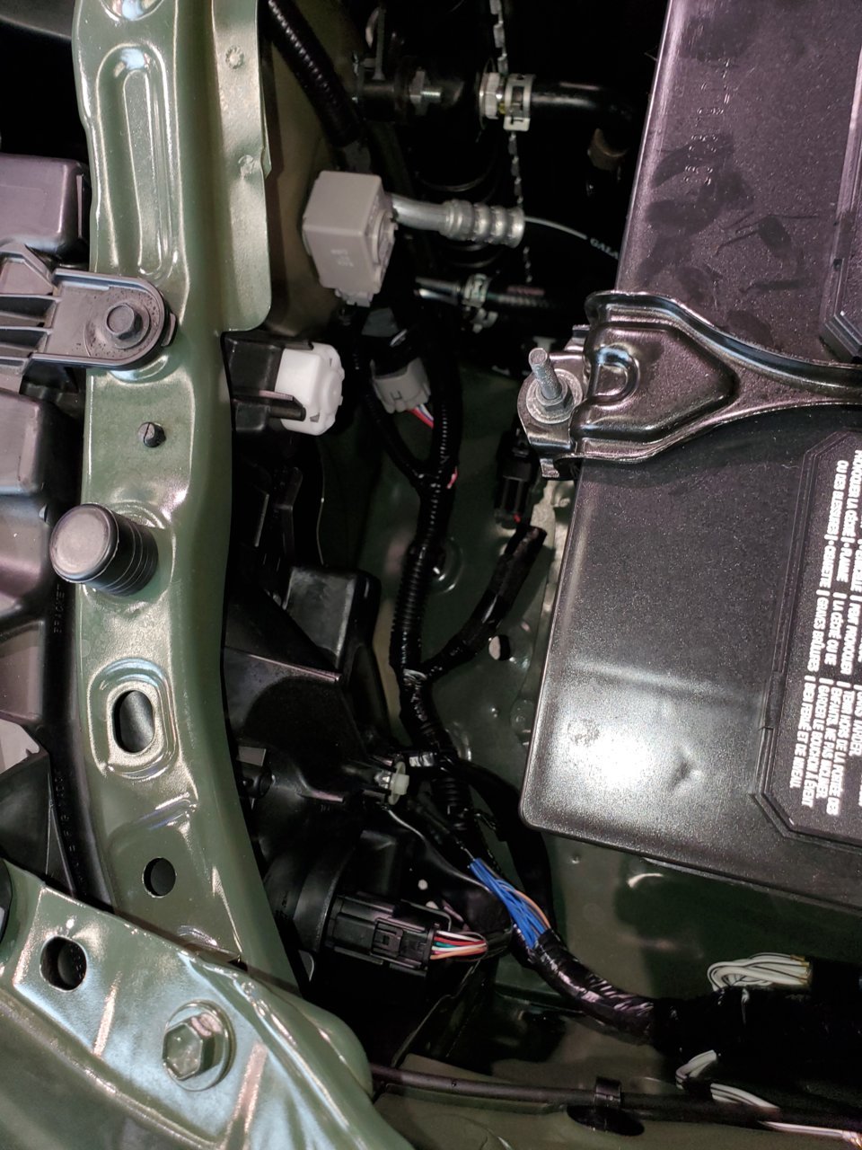

    Here's what the 2020 PRO light plug looks like...

    @ttu19 No you still need a conversion harness. I looked at both 2020. The led headlights have a different harness.

    Nope. It’s been confirmed that the electrical connections are completely different. LED’s use one 6-pin connector.

    From some research I’ve been doing the wires from the non LED to LED are all the same color and I found the part number to the connector that plugs into the back of the headlight you’d just have to take the factory connectors apart look at the pictures and get the colors matched to factory spots and it should work.
