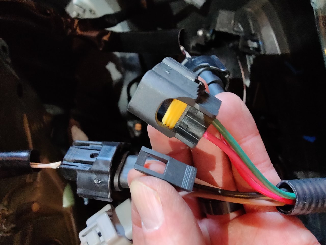

    Got everything buttoned up, and the harness is held together with electric tape.
    Hoping Mike will send me a replacement.
    Will post pictures soon.
    Really thankful this mod exist!

    Yeah, post a photo of the broken connector. If Mike doesn’t have extra I probably do.
    I learn something new every day. And they are just dangling, not sealed with a cap? Almost home from a bike ride but delayed by confetti cake.

    How would I replace just the connector? I would have to de-pin it? Never done it before..

    It’s not too hard if the connector is throw away. Just one tiny flathead. Remove the plastic TPA. Push each plastic tab out from the front while pulling back on the wire to remove. Reinstall in the new connector. Push TPA to lock in place. I can send photos via DM once you have the replacement connector. It’s the DRL one.

    Which clip broke? (Nevermind, I saw the pic you posted above) When I did mine, One of the OEM clips broke on me. I think Toyota just specced a brittle plastic.
