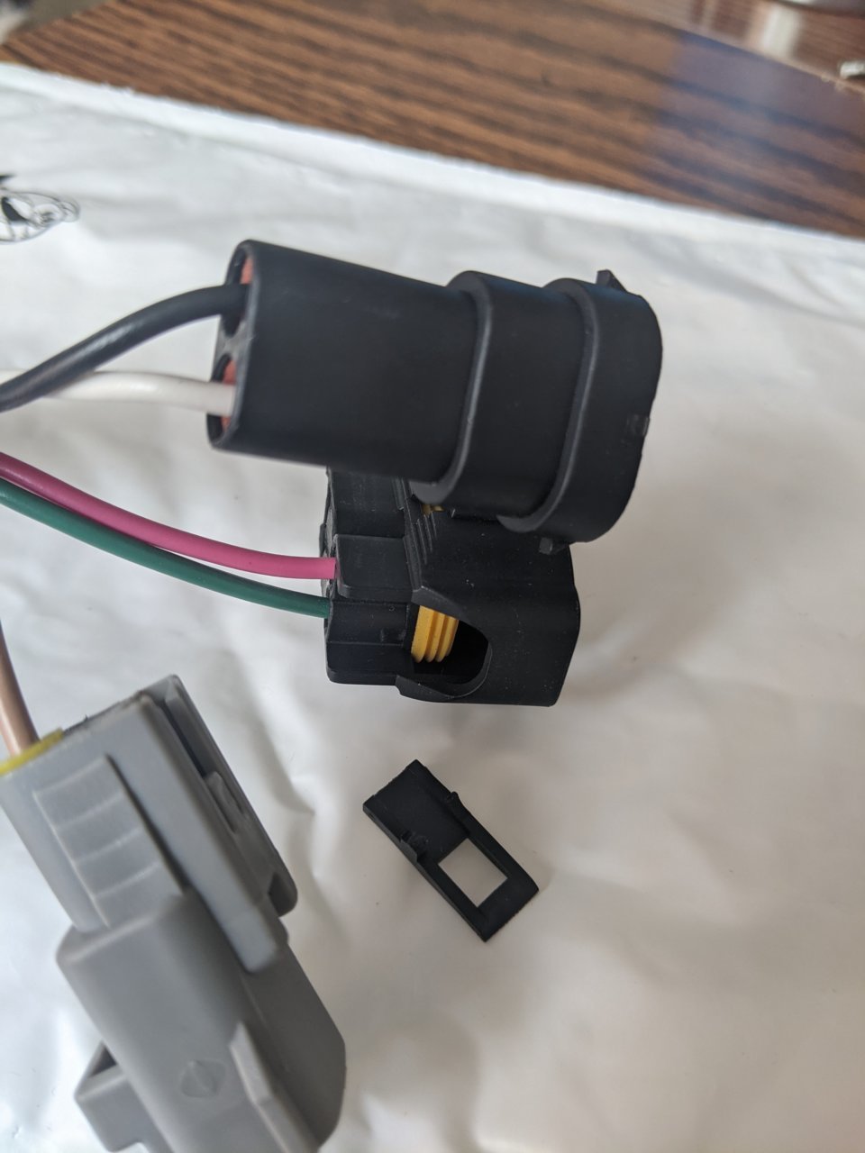

  7. May 12, 2021 at 4:16 PM
    #1847
    poe_fosho
    poe_fosho Well-Known Member
    Nov 23, 2020
    #347630
    62
    Colorado
    2021 Tacoma TRD Sport 6 Speed Manual
    I got my replacement harness and it broke the clip the exact same way...
    What am I doing wrong?
    No problem on the passenger side. The exact clip broke the exact same way. I plug it in and the tab snaps off.

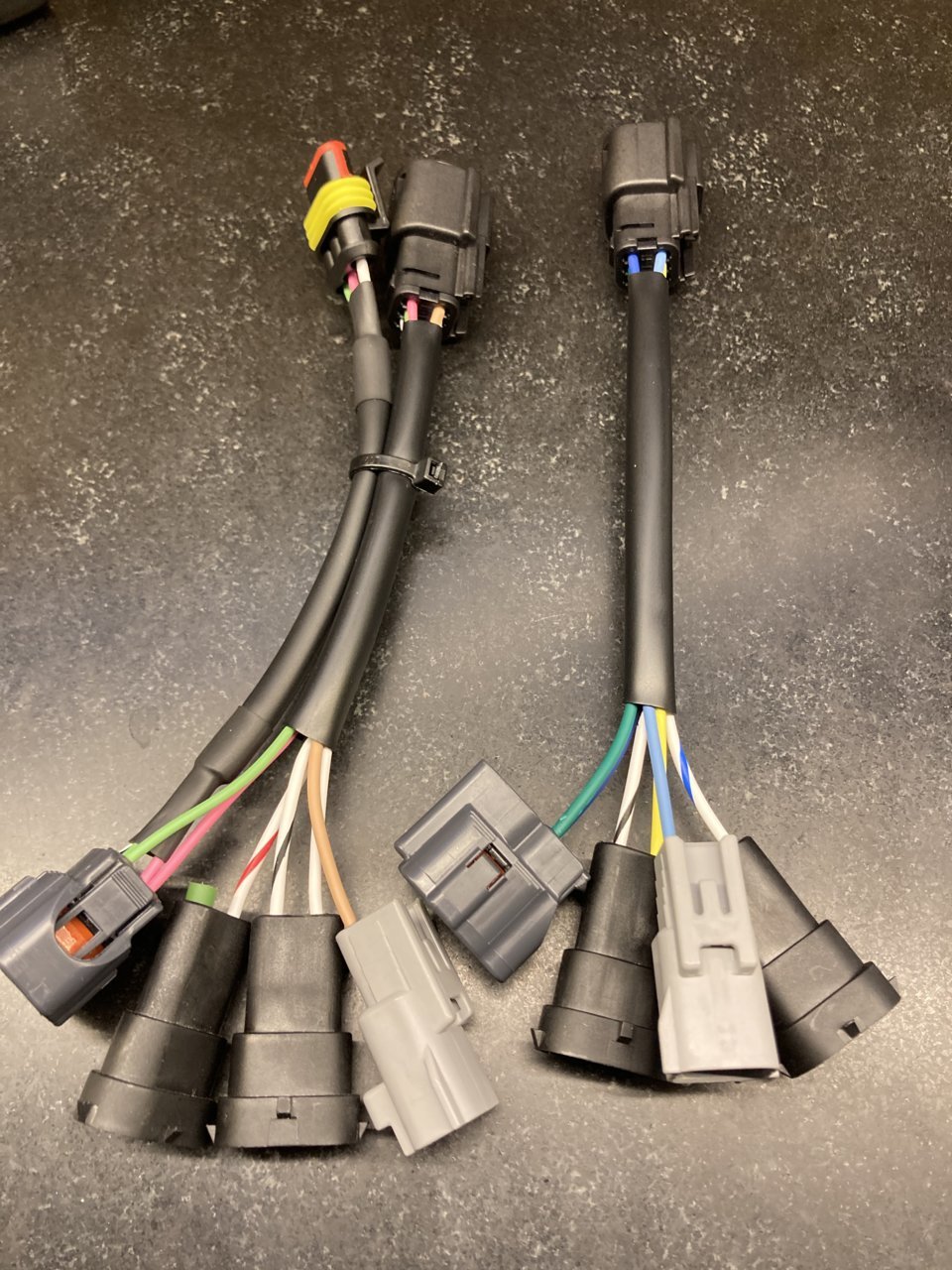

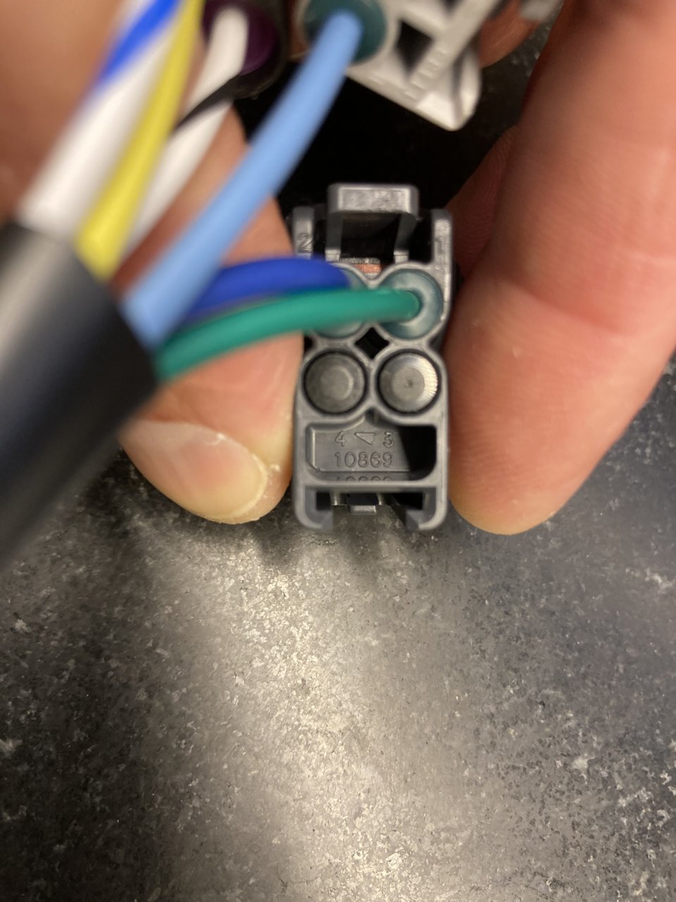

  8. May 12, 2021 at 4:29 PM
    #1848
    daveeasa
    daveeasa FBC Harness Solutions
    May 14, 2020
    #328079
    7,479
    David
    PNW
    2016 Tacoma OR DCSB 6MT, 2005 RC 5MT PreRunner, 2002 Tundra SR5 RCLB 4x4
    Sounds like he got a bad batch of connectors.
    So, there are OEM grade connectors and knockoffs. The OEM ones have numbers on them. I'll post some photos. The knockoffs typically don't have the part numbers on them. Now, maybe your grip strength is just superhuman (as hinted at before) but if you have normal strength you shouldn't be breaking the connector. And there's only one way these things can fit plus you've got it working so I'm trusting you're not trying to smash it in the wrong way :)
    The OEM grade connectors are pricey, $4-$6 a pop so if you use 4 of them in a pair of harnesses that's $20 right there, plus another $2-$3 ish for the MX150's and maybe 50 cents for the male H9's, plus wire, plus at least $1 for each sidemarker cap, around $30 in raw parts for "premium" connectors. One obvious way to cut costs is to not use OEM grade connectors and pay full (inflated) price on them.
    The knockoffs should be around $1 when purchased in bulk (quantities of 100+) after spreading the shipping around, but require a loooooong lead time (slow boat from china sort of thing). I have some of the sidemarkers (also the same as the reverse male connector) inbound for at least 3 weeks now, they show up when they show up, not a moment before.
    I've thought about buying knockoff DRL connectors but so far I haven't taken the plunge. The price differential is significant.
    Want to check yours to look for a part number? I'll post a photo of the ones I use with the number right now.
    6968D8C0-C345-4E00-AFF1-2AE3BFE35AE1.jpg FA436B8C-C260-4E7D-B8E6-CF3F94FD52CD.jpg

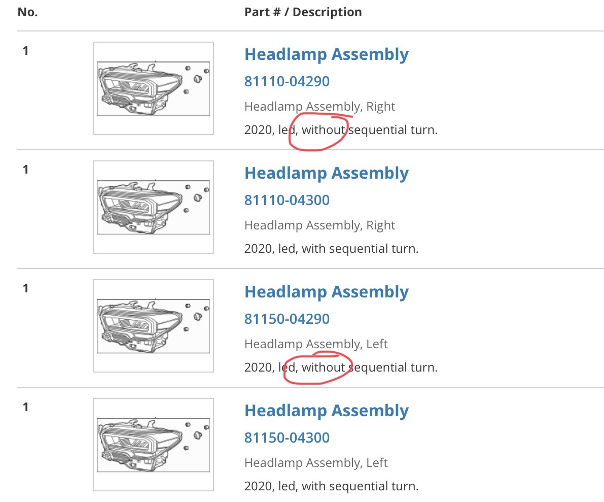

  13. May 12, 2021 at 11:34 PM
    #1853
    iampraneel
    iampraneel Well-Known Member
    Jan 6, 2019
    #278405
    203
    2016 DCSB TRD Sport 2WD
    Hey guys - question on the image below. I want the 2020 OEM LED’s without the TRD PRO lettering and I thought the two circled below ending in 04290 were the right ones but but it says it without sequential turn.
    Is that correct? I thought all 2020 LED came with sequential turns.
    hossler1788 likes this.
  14. May 13, 2021 at 4:32 AM
    #1854
    DamGuide
    DamGuide Well-Known Member
    Nov 29, 2019
    #312054
    674
    Nooga, TN
    2020 TRD Offroad
    It says that, but they do have sequential turn. That’s what came with my truck.
