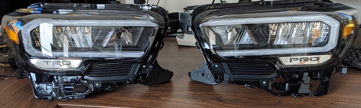

    When I bought my truck last year the one thing I really wanted was the LED headlight package. Unfortunately, there were none to be had in the entire southeast so I settled on a TRDOR with every option except the headlights. After many grueling hours of reading this thread and looking at all the other great looking installs I finally bit the bullet and hit the submit order button. I was really torn over the standard or pro version and actually ended up deciding with a coin flip lol. Now all I need is my harness to get here so I can get these bad boys installed!
