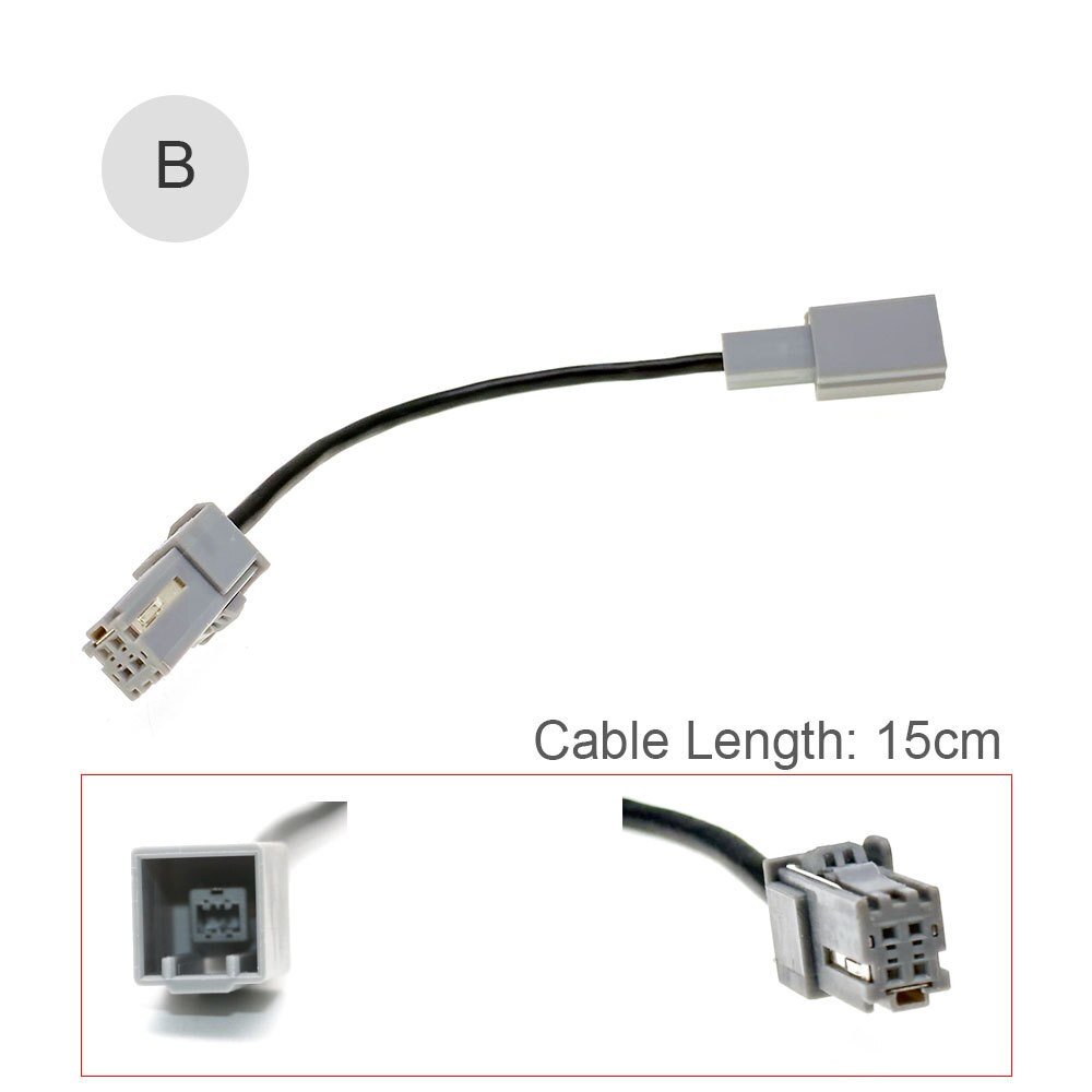

  17. May 7, 2023 at 10:45 PM
    #17
    IcemanPNW
    IcemanPNW Well-Known Member
    Apr 7, 2020
    #324019
    126
    M. E.
    3rd Gen TRD Off Road
    Ok guys, tested this evening and confirmed; disregard all of the earlier posts from previous years, this is the endgame for the retrofit as far as USB goes if you're doing the Entune 2.0 to Entune 3.0 swap.
    This is a short 6" long adapter that fits the Entune 3.0 head unit and attaches directly to the Entune 2.0 USB harness in the vehicle. You'll still need the separate harness for the rest of the head unit wiring, but this is THE one for USB.
    Aliexpress link: https://www.aliexpress.us/item/3256804748602146.html
    Notes: that link goes to six different cable options, only one of which is the correct one. Also, I have no affiliation with whatever this shop is, just have been looking for this specific adapter for a long time and finally found it. Lastly, quality control and shipping directly out of China can be sketchy at times, YMMV.
    ** MAKE SURE TO GET THE "B" CABLE PICTURED BELOW **
