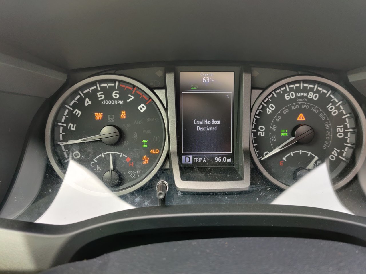

    Verified my crawl control in my '19 works, at similar angles and on slightly wet/shaded grass. Worked as expected in all speeds. I did not realize how much crawl control seems to jerk forward and stop almost immediately, expected smoother feeling operation in the cabin. Guess the slower speed settings are very sensitive.

    Mine does not work like my 18 and 19. I will be visiting the dealer.

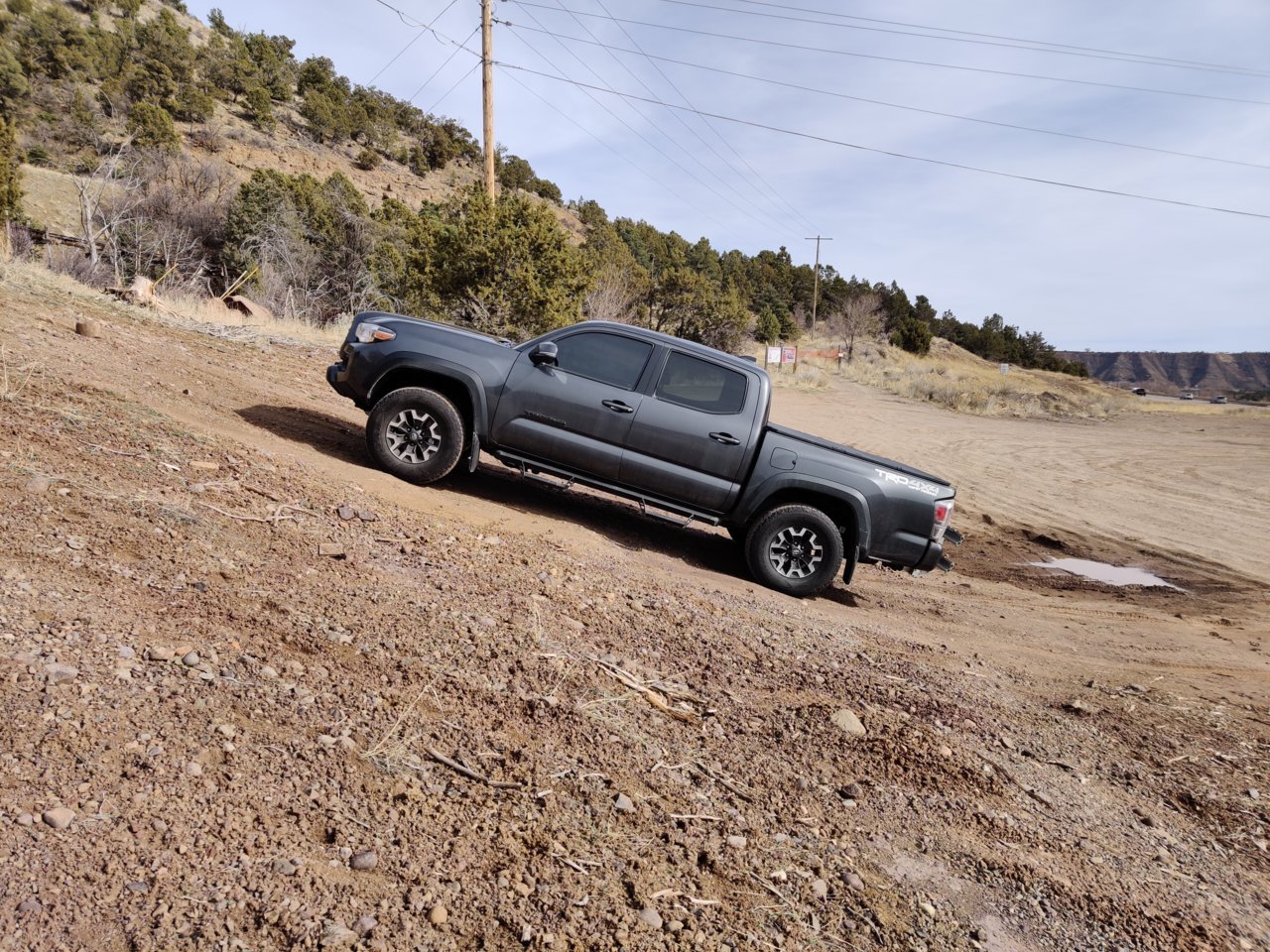

    Thanks for the pics. Interested in the outcome/fix.

    I went to the dealership it is normal on the 2020s tacoma i drove test another tacoma and on a high hill it tries to work and cancels CC my friend has a 4runner pro 2017 and that thing is a beast his CC will run a dig the truck just different CC i got to use my crawl control to go over a tree log to cross a trail with no road and it was nice

    My gut feeling says it has something to do with the drum brakes. It's the only Toyota Crawl Control system that is on a model with drum brakes. I remember reading some very early 3rd gen posts about drums getting fucked with the system. But those posts were very few. 2 or 3 from what I can remember.

    Turn off your ECT button.

    I just used CC on my 2020 TRD OR while going up a hill and it worked with no issues. it didn’t cancel itself or anything

    I bought a 2020 Tacoma TRD Pro in December, probably built sometime a month or 2 before that I’m guessing? After reading this thread I took my truck to a steep, off camber dirt road climb that I had done with my ‘17 T4R with CC. My 2020 Tacoma CC works exactly the same as it did on my ‘17 T4R, just as noisy, just as effective, no difference whatsoever. There was a lot of steering input required, and it didn’t quit. I continued up the dirt hill in a straight line and it still worked just fine. Not sure why some aren’t working, but it can’t be right. CC has been around for a while and this hasn’t been an issue before, and it appears that it’s only a problem on some 2020’s, which tells me something is wrong (unless Toyota says it working on a hill is wrong?o_O)
