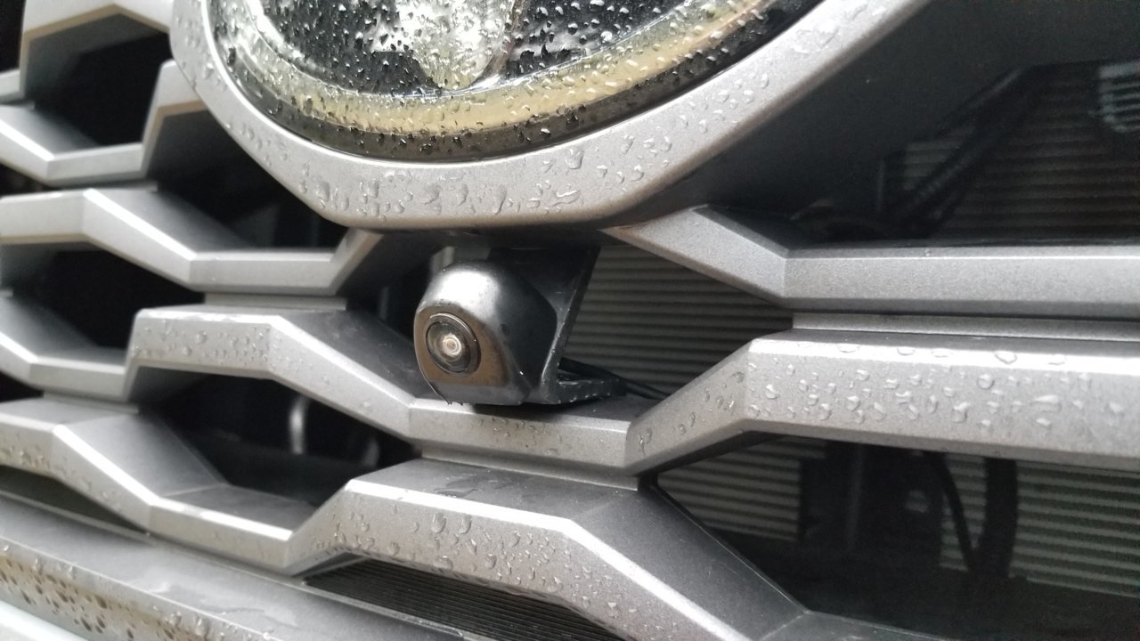

    I have a 2020 Tacoma Sport and would like to install a front camera directly below the TSS sensor on the OEM grill (like on the factory off-road) and am wondering if anyone out there who has already upgraded to the PRO grill would like to sell their front camera's mounting bracket? Unless I have misunderstood the parts lists and diagrams the camera bracket cannot be purchased separately (only comes with the OEM camera) and it's also a different part number for the PRO grill verses sport/off-road grill's camera.

    @Diesel156 I ended up using this bracket to install my front camera: Looks like it's sold out now but if you call them perhaps they could print you another one?
    It worked very well. I used a NATIKA camera from Amazon cutting one wire for forward facing and another wire for the "sitting" position. I also used a Foglight assembly screw as one of the ones that came with it seemed just a little too small.

    Im also interested to see where i can get one of those brackets. Design seems simple enough and I may try to fabricate one since they seem to be out of stock.

    I feel like you could cut a piece of L-shaped iron and bend it to form the same angle that they have

    Thats what I was thinking. I was thinking Aluminum L channel and over bend it to the angle.

    There were people making camera brackets for the Pro grilles I'm sure they can make one for the OR/sport grille. They were 3d printing them
