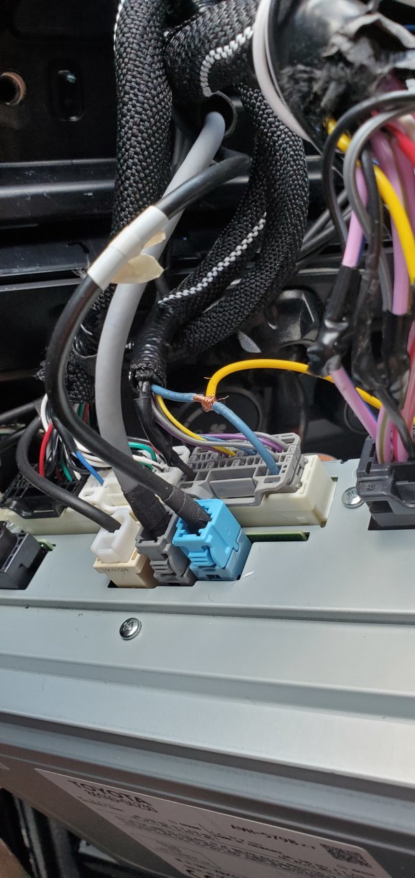

    I am also installing a LOC and want to tap into factory wiring. By going off the speaker wire explanation and colors, I'm still having trouble finding the remote wire on back of the radio. Help Please! Thanks!

    After trial and error I found the connection point. I grounded to truck body and ran power to dark blue wire.20200418_180221.jpg

    The loc I used had a separate remote wire that I was initially told not to use and then told to use it so no need to find it on mine.

    that blue wire you're spliced in to is constant 12v

    ^ What he said. Your amp will never turn off with this wire = bad

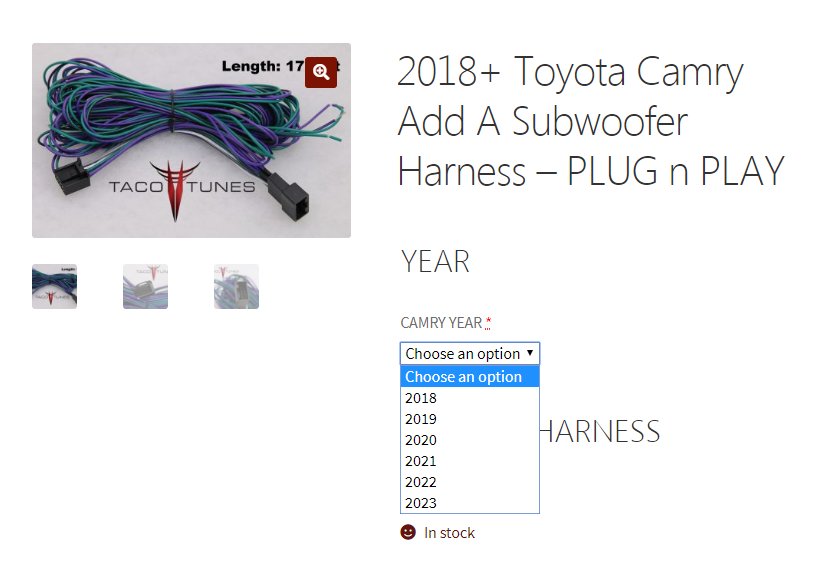

    thanks for the info - i bought the same LOC rubenz had, which i now know is wrong. the camry harness will work for me because right now all i'm doing is adding a JL audio stealthbox sub (access cab single 10 inch in the jump seat center console) and the amp for it will turn on with line-in signal so i wont have to hunt for a remote source.
    just to clarify though: in post #17 where you kindly provided a link for the harness, the link was altered? edited? censored? whatever we want to call it - the website you meant to share was taco tunes, yes?

    That was where he was linking, yes.
    There are a few words that have been blacklisted from this site and that is one of them. If you type it in, it automatically gets changed to asterisks

    I just ordered a 2018 Camry wire harness because 2018+ indicates to me that they're all the same so it shouldn't matter. If this works, it'll be perfect for me because the amp I'm using has Hi level auto-on inputs meaning I don't have to establish a remote wire to turn it on, it will just turn on when the head unit starts sending signals to the speakers. The LOC you ordered from Amazon looks like the one I ordered but with a whole extra loom on it. Thats way bigger and more involved looking than the one I got so hopefully its an upgrade that will work for the 2020's. I'm close to having everything I need and a couple weeks away from having the time to put it all in. I'm doing a lightbar, bed lights, rear work lights, sound deadening, and this JL audio stealthbox single sub install all at once so I'll update when its all in and working or be back looking for more help soon :fingerscrossed:

    no, sorry, what I meant there is that his looks better than the LOC i had ordered but the one I ordered wont work at all because its the same as post#10. I have since ordered the TT Camry add a sub harness which basically just looks like a quality speaker wire splice. No other added electronics.

    i also found this other add amp adapter, its a 4 channel, hope this helps

    Completed the install, This adapter worked perfectly and fits!
    By the way, this harness taps into the front speakers
