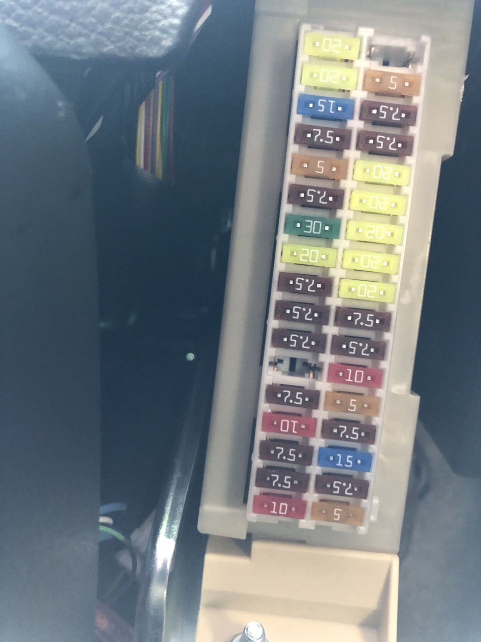

    Check these in the fuse panel under the dash

    I’ve been testing all of them. All good so far.

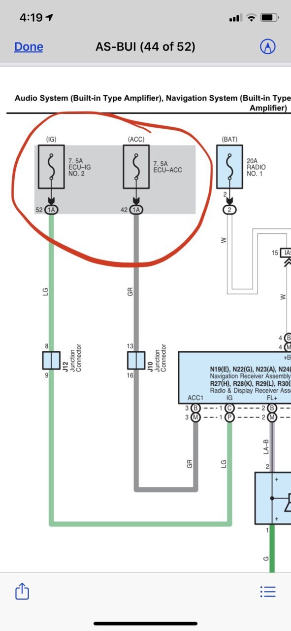

    If the radio AND the power mirrors aren’t working, this fuse goes to both of them.
    ECU-ACC

    Bingo! Just got back from parts store.. that was the culprit.
