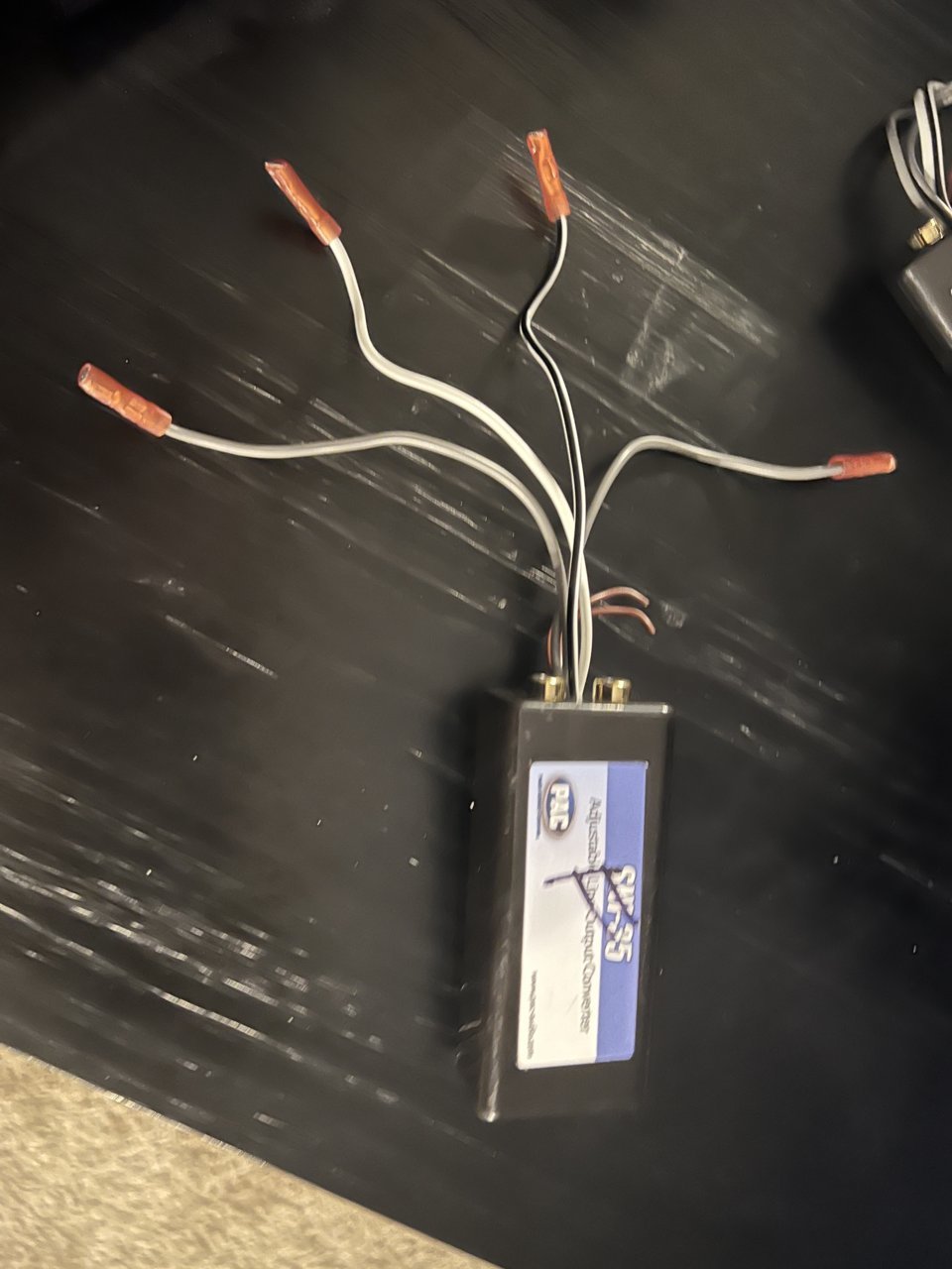

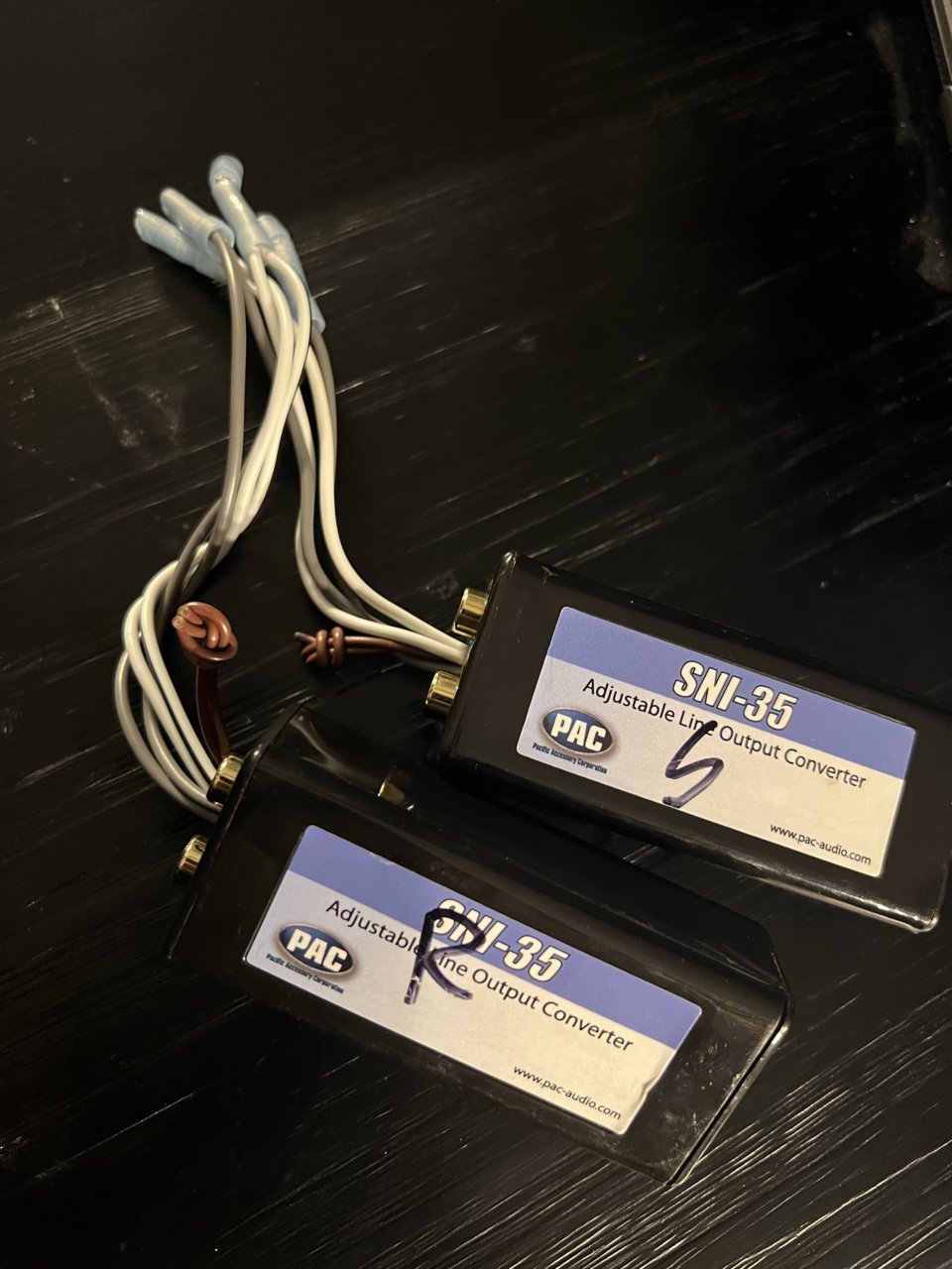

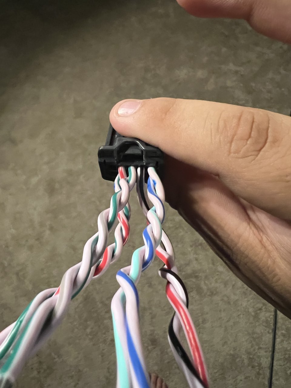

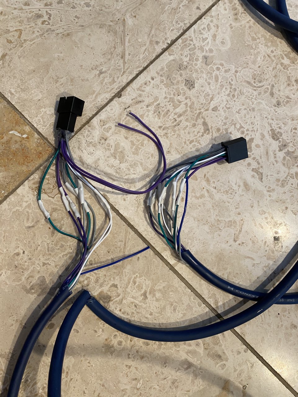

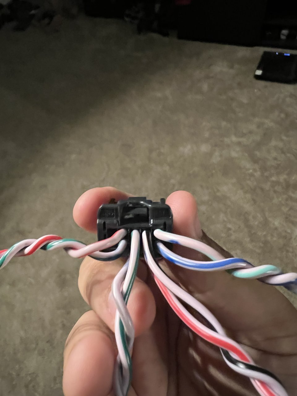

    Hello there, I know this post is old but I wanted to ask for your help. I am installing a more expensive line out converter than what the “professional” installer put in there. The connector in my radio is the same as his: (2019 Camry XSE) 10 pin with the top and bottom left pins empty. With the connector facing up and the wires facing me, The top has pink/red, pink/green, pink/black, and pink/teal wires. The bottom has pink/green, pink/grey, pink/red, and pink/blue wires. The wires coming out seem to be the exact same except mines doesn’t have solid colors.
    Can you clarify what the left and right, pos and neg wires are when the connector is facing up and the wires are towards me?
    Also, The LOC for the front has four separate connections, while the rear and sub dedicated LOC has four connections with two wires of the same color in one butt connector. What’s the reason for this?
    I’m going to try to provide pictures, I hope this isn’t too much to digest.

    Yo! Is this with the lock tab up and wires going toward or away from me? Appreciate it.
