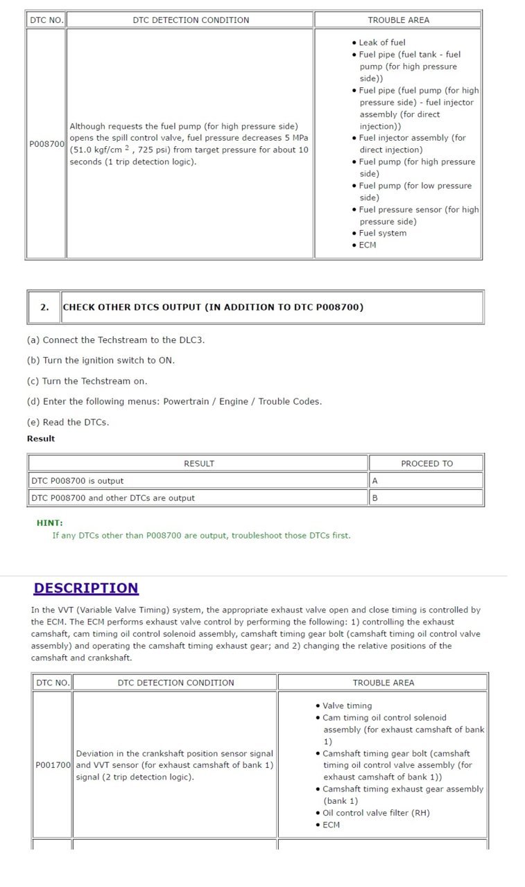

    My guess is the cam timing oil control solenoid.

    Stopped by dealer again this morning. “trac off” and “check engine” light on again. They were very busy, with cars backed out the door. Told me it wasn’t a good time to visit. Told them this car stalls, sputters, and dies at the worst times and I can’t believe this is normal. Told them to check the fuel pump. Someone asked me to name the dealer, but I’m not here to rat anyone out or get kicked off the forum. I just want my car fixed and maybe help the next guy or girl out. No one should have to deal with these problems or service. Said they have no time to fix it (which I believe..they were very busy) and sent me away in a Camry.
