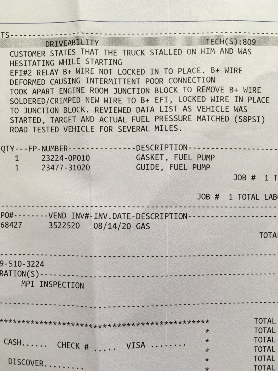

    Official report:

    Wow, a loose fuse. Good to know. I will have to tell the shop that has my 2016 Tacoma (thread - 2016 Tacoma no throttle, check engine light on, trac off light on) and have them check that. I did put in a front camera a few months ago and spliced into a fuse to power it.

    Final update..Toyota declared it a Lemmon and is buying back. Less than 2,400 miles and been in the shop four times for over thirty days for repairs and still isn’t right. Not a good experience at all.

    Wow, didn't expect that after they found a loose fuse. So that wasn't it?

    Still runs rough, but not throwing codes anymore. Really disappointed with the offer from Toyota. Funny how when you buy a car everyone at Toyota is your friend and then when you have problems it’s like “good luck with that POS.”
