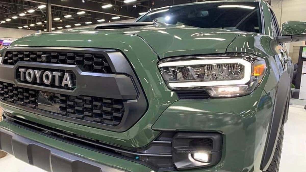

    I would really like to have it like this, I’m assuming the OEM 2020 TRD pro grille has the opening for it already. Guess I better call around

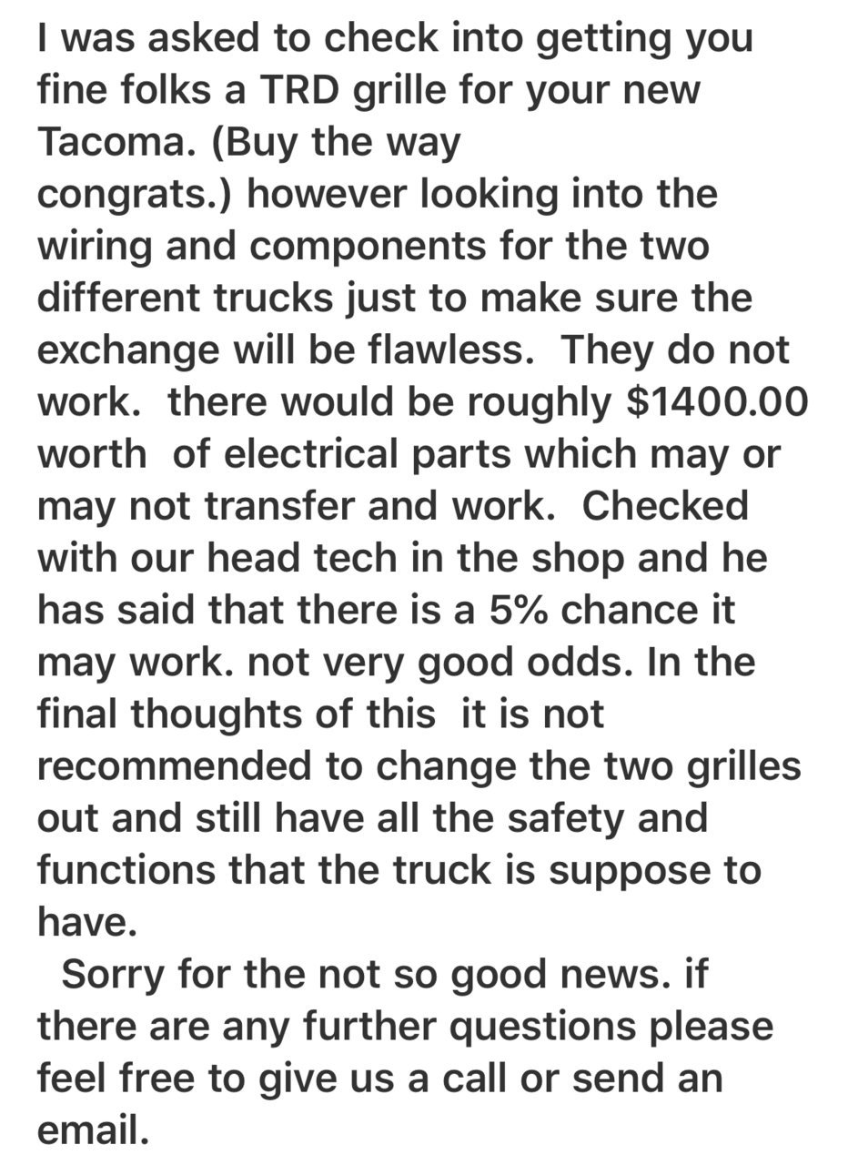

    Okay - got an email reply from my dealer’s parts dept regarding an OEM 2020 TRD PRO grille (compatible with both TSS and camera,) and here it is. Seems unlikely - and maybe easily resolved if you’re tech-savvy, but here’s the response:

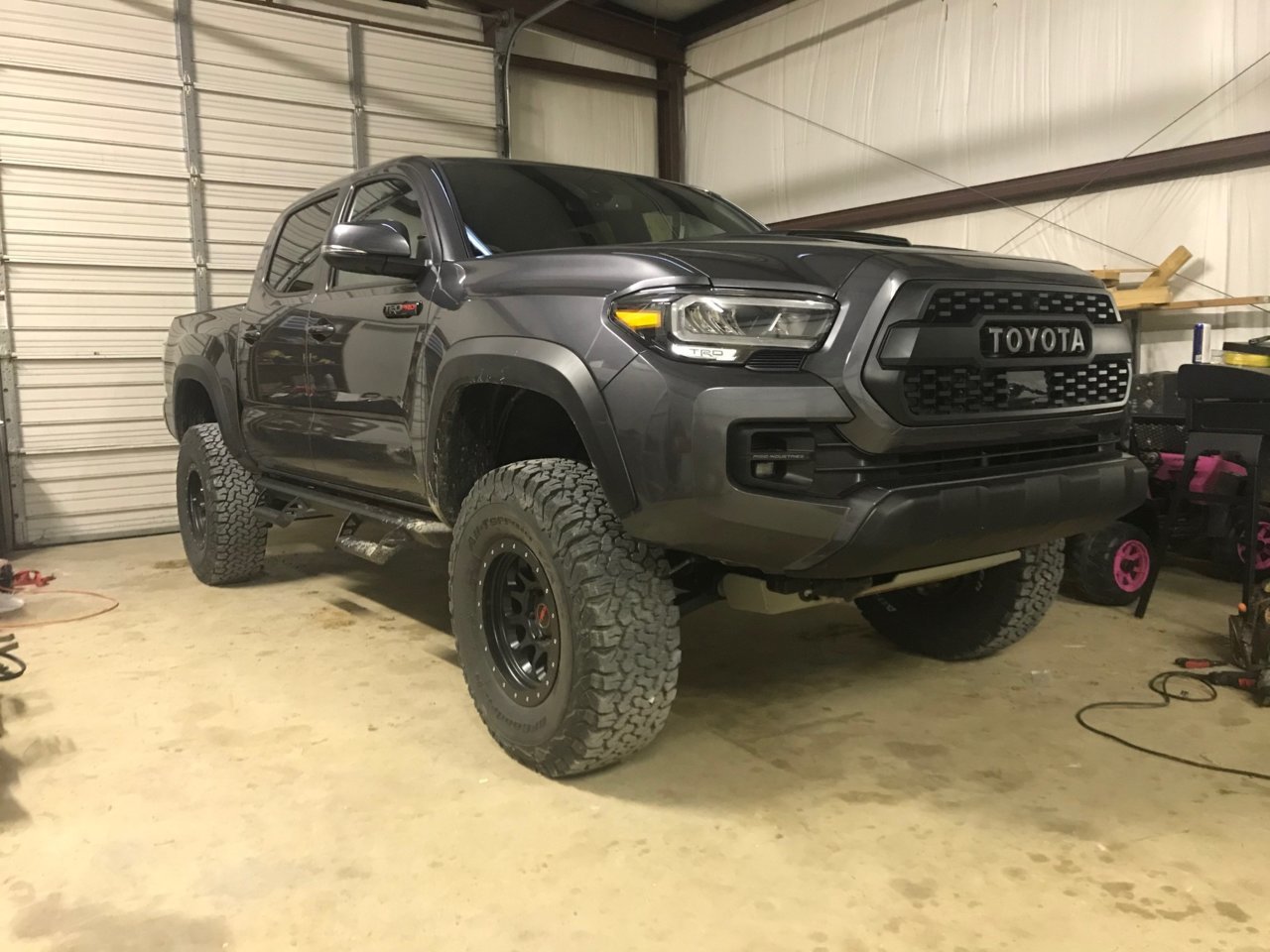

    2020 MGM DCSB
    Just buy the Pro (like I did) and you're good to go! :spy:

    Damn does it look good in MGM :drool:
  16. Dec 3, 2019 at 12:23 PM
    #16
    WreckedRooster
    WreckedRooster Well-Known Member
    Jan 17, 2019
    #279680
    1,188
    Jake
    Oklahoma
    2020 MGM DCSB
    Thanks! she's sitting a little different now. Still got more to do.
