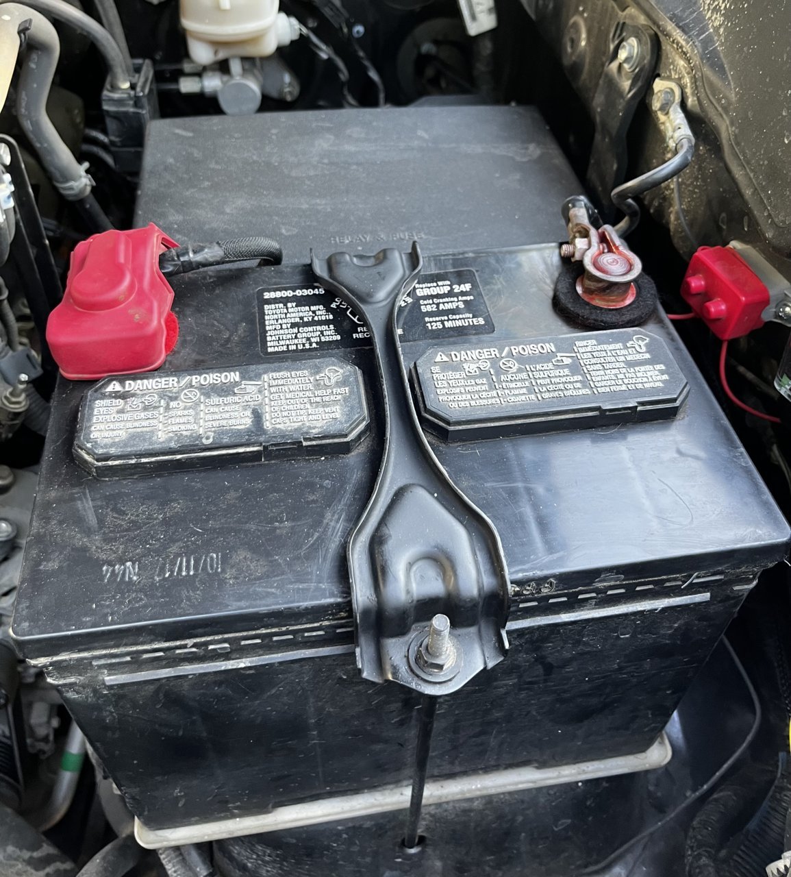

    Same here with some folk. I’m still on the original OEM battery. And the truck was parked for nearly two years with both a covid working at home and a fucking cancer fight back to back. I never tended to the battery. I finally cleaned the terminals for the first time not too long ago. But I’m presently searching for a replacement even though the cranking is in good condition.
