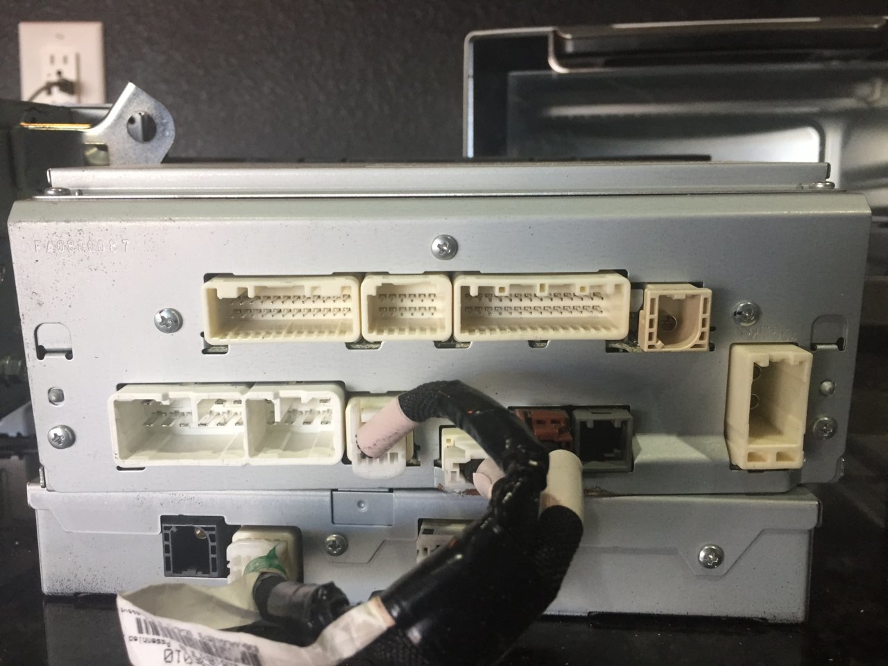

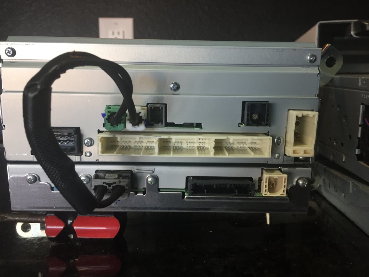

    Im doing a speaker upgrade right now. JBL Stadium series 2.5 Ohm all doors. IMG_0392.jpgIMG_0391.jpg
    Here are pics comparing the 2019 and the 2020 Radios. The rear connections are different and there aren't any kits as of yet for the wiring.

    JBL is different. Runs from the JBL amp at 2 ohms. Subaru tweeters are 4 ohms
    Stock speakers are trash
