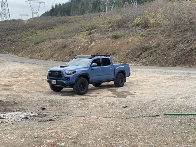

    2018 TRD PRO CAVALRY BLUE
    285/75/16 on a stock pro.
