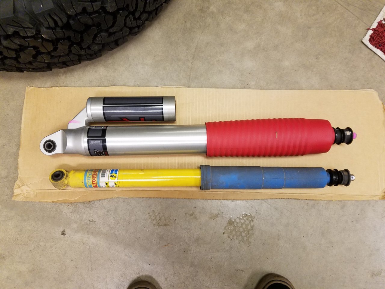

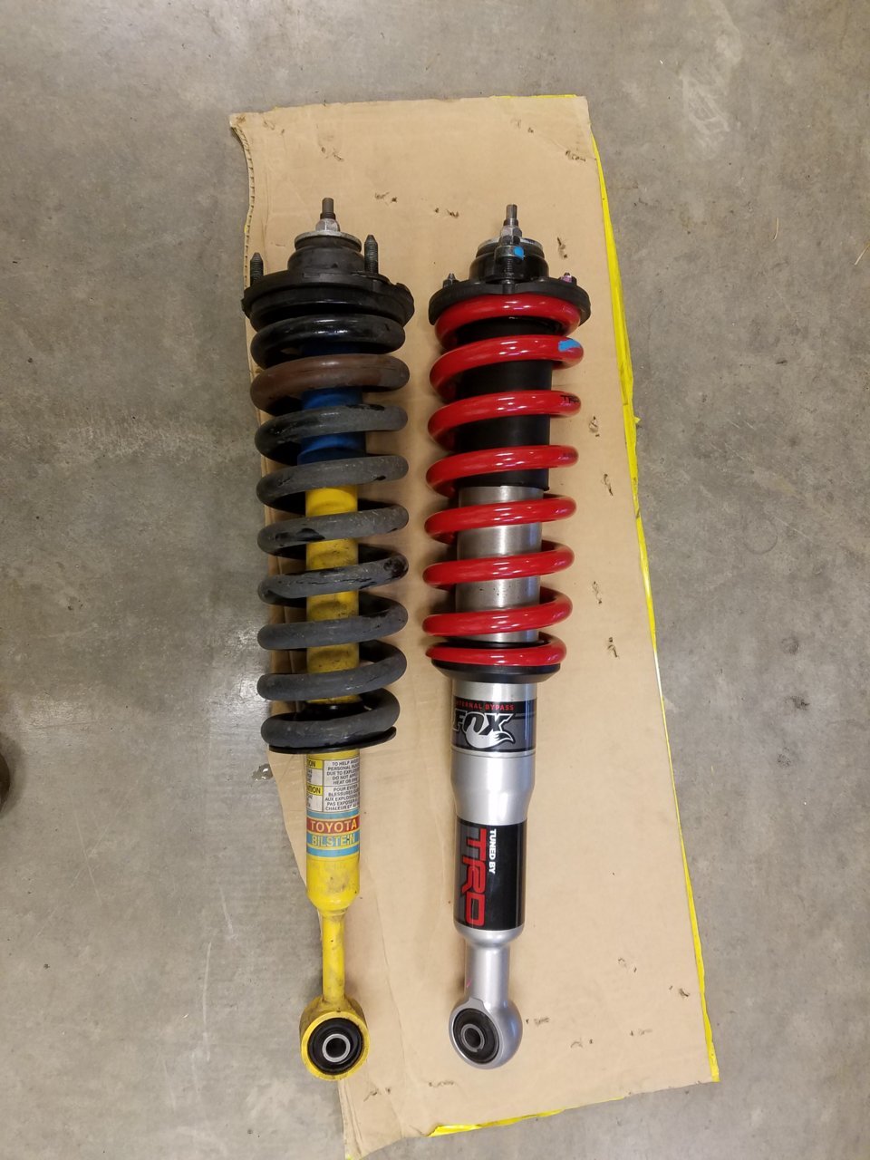

    I'm fairly certain that the TRD Pro Fox shocks have always been 2.5" front and back.
    Also, in 2020, they revalved the shocks, but also stopped using a flat grind coil and used a full diameter coil end with a modified spring perch.

    That was an old post. I've been out of the loop for awhile but I did a quick Google and you're probably right. I think my confusion was from Toyota claiming in multiple official statements that the rear has "2-inch piggyback reservoirs". Alternative sources suggest it's a 2.5 shock with 2.0 reservoirs. Fair enough.
