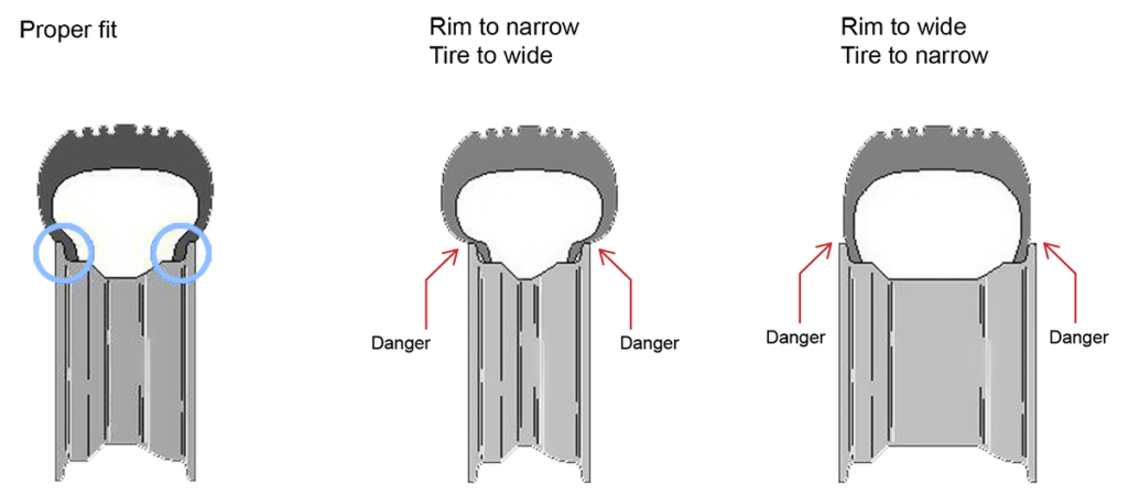

    SO what's your take on 285's on a 7 inch wheel? Manufacturers recommend 7.5 minimum...I'm thinking it should be fine unless it isn't . Either way there may be legal issues??. There's a decent sale on some 285/75/16 Cooper AT3 XLT north of the border and it's sooo tempting. Picking up a Pro in a week or so...

    I would find a suitable wheel for that size tire. Safety first. The 285 tires are all heavy and can be used up to 80 psi. If you do loose a tire I can tell you from experience that the bare rim will take you for a ride in the ditch. Not only may you roll but you may encounter another vehicle, hopefully not head on. When I had a bare rim on pavement at highway speed I could not steer with all my strength away from the side of the road. Once you get into soft soil the rim will dig in and then all goes quiet as you flip through the air...

    Sounds like when I rolled a Dodge Aspen!! Quiet.... then all hell breaks loose!!
    Guess the other option for a 33ish is a 255/85/16. But probably go 265/75/16. Cheers :)

  17. May 5, 2020 at 6:34 PM

    A picture worth a thousand words! Thanks for that:cheers:
