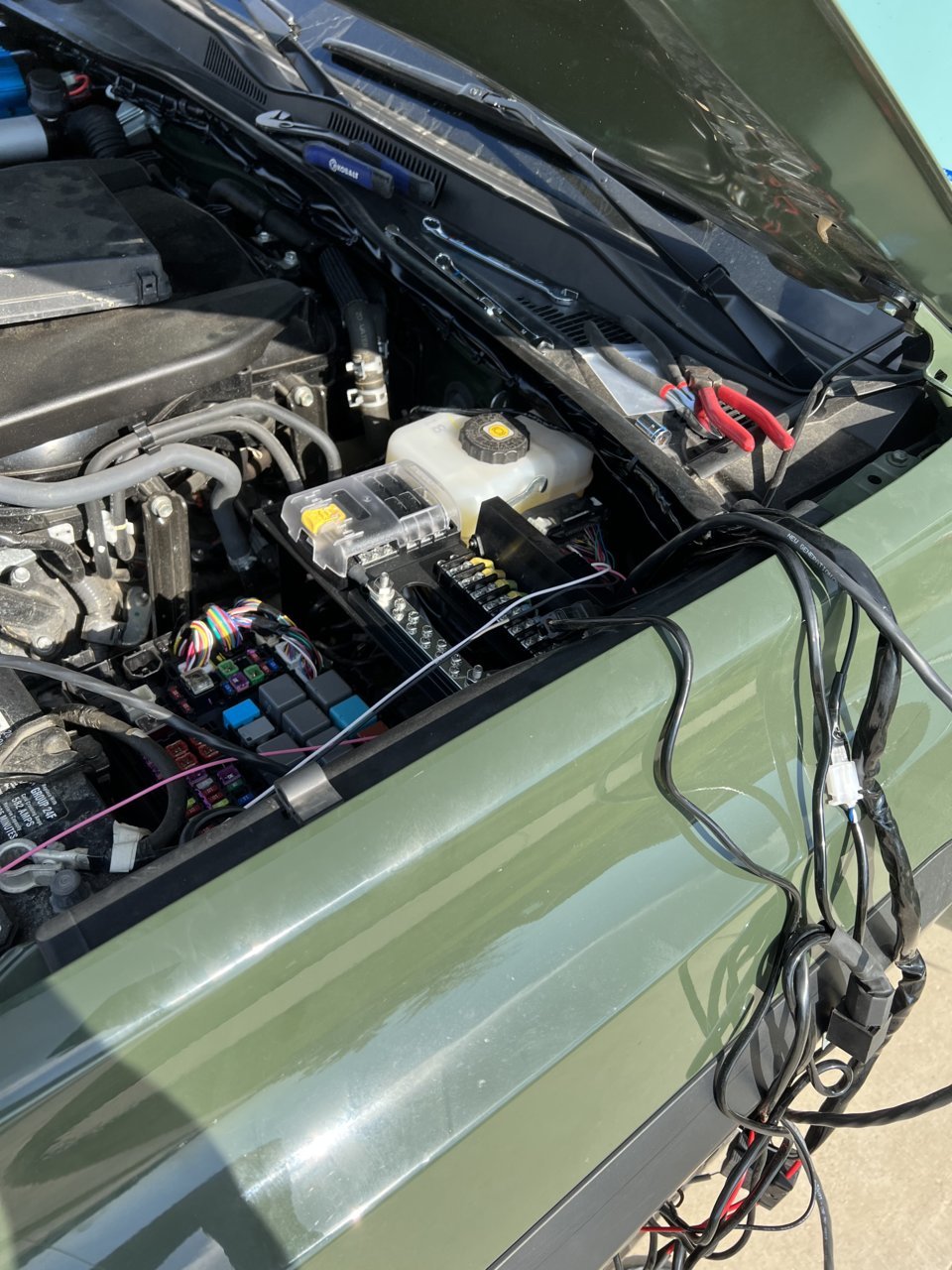

    Crap! I forgot to do hub to fender measurements. Right now I’ve got 450 pounds in the back. The truck was squatting. My calibrated eyeball says this things now sitting 3 inches higher. Bout to add 200 pounds of bumper weight so… that shoooould give me the 2 inches of lift with 660 pounds (as advertised by OME)

    Welp, almost forgot that if ya putting lights on the rear bumper(like I am) to install the lights before attaching bumper… and so far I got ditch lights and arb compressor hooked up direct to the battery and I ain’t adding any more to the rats nest… so… switched gears and finishing that power trays/switch pros combo. Yeeessh. It’s like one thing is a prerequisite to another to another to another. It’s 100 damn degrees out here.
