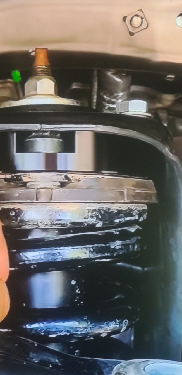

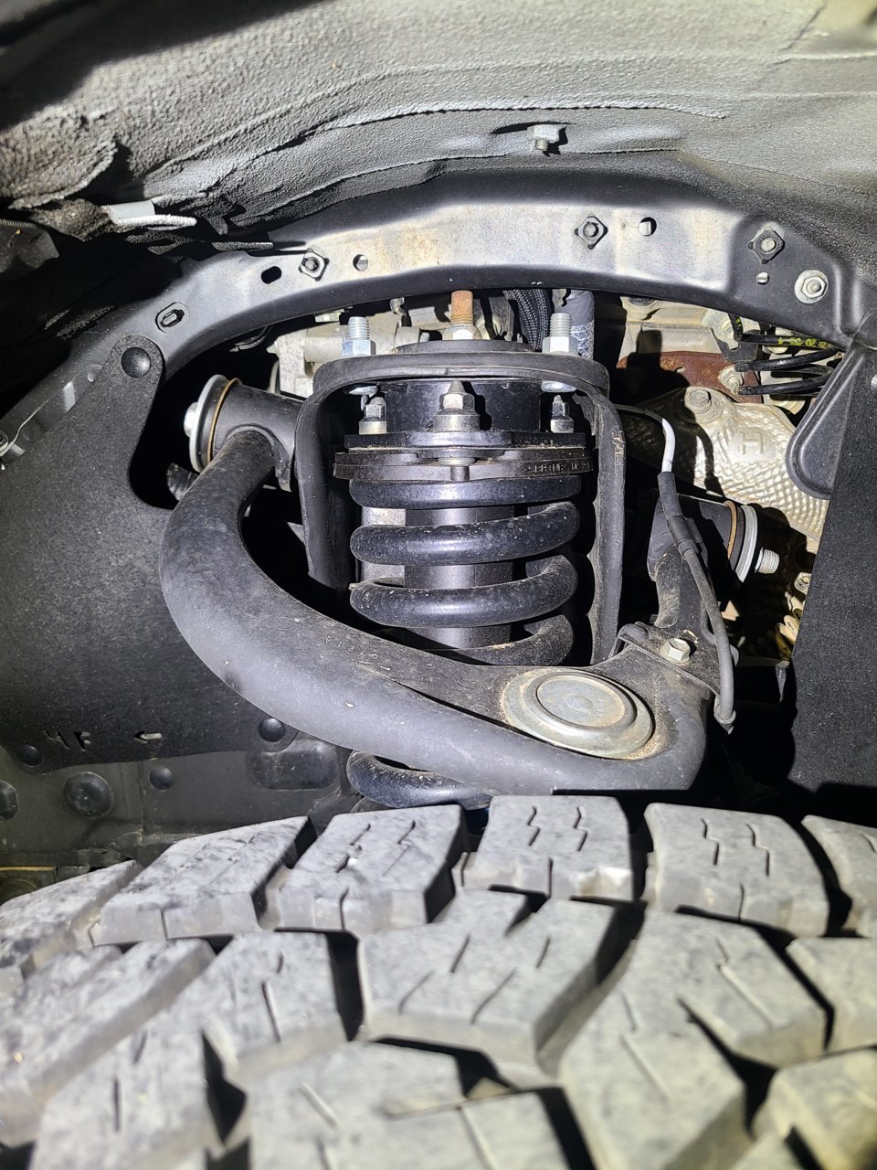

    Take a close up picture of the top strut mount. A 2” lift spacer is barely visible while a 3” lift spacer is quite visible.

    I already had this picture in my phone.

    Looks like a 1.5 spacer, so 3" of lift.

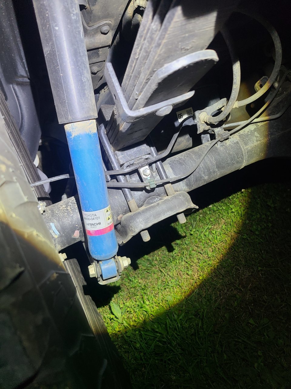

    Would Bilstein 5100 put me at the same height? I'm wanting to keep the same ride height with a smoother highway ride. Here is also a picture of the rear.

    Why is mine not squatting without any lift in rear? Sorry so many questions, this is all new to me.

    That's a 1" block you have on rear axle.
