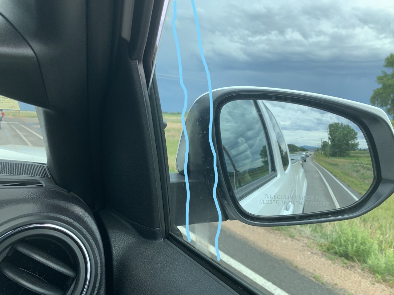

    It could be something on the weather strip. I’d roll down the window and clean the strip by sticking something down into the weather strip. Like try to get a washcloth down in there with soapy water and pull it back and forth to try to clean between the two sides of the weather strip.
    Also, you can try to pinpoint exactly where the grease is coming from. Wash the window. Roll it down two inches and then back up. See if the bottom of the window is greasy. If it is, you know it’s coming from the top of the door.
    Then roll it down 5 inches and back up. See if it’s greasy. Continue this up and down process until you identify how far down in the door the grease is coming from.

    I actually have the same issue with a grease stain on the inside of the window.
    Cleaned it a few times. It eventually stopped coming back.
