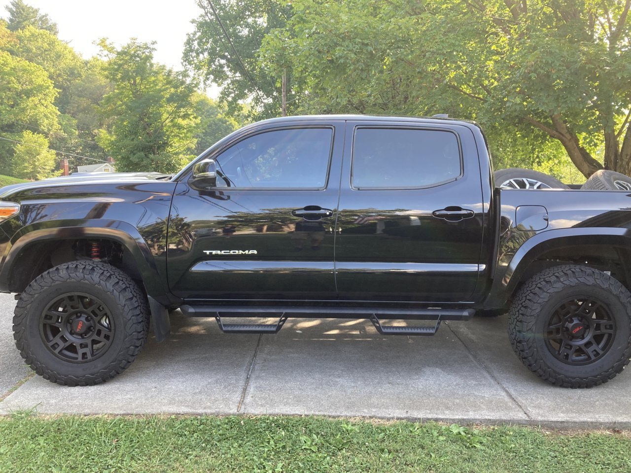

    i definitely had the well documented issue of them not seating up properly due to the hub ring on the rear being a mm or so too deep. My truck is a 2021 DCSB. While I can’t speak to everyone who has put these on the 3rd gen I can wager a guess that those who are claiming they fit just fine are just tightening the rears lugs to some ungodly and unsafe tq to try to make them work. Thankfully, I found a forum member here who had a grinder (and experience) and was able to grind a millimeter or so off each rear hub ring so that these wheels would fit perfectly.
    Be aware that these 2021 wheels are notorious for being VERY difficult to balance perfectly. I had mine rebalanced 3 times in the 5 weeks I had them on the truck. Ultimately, I decided to sell these to another member and I switched to the “SEMA” prior year wheels that look only slightly different. If you have not paid for these wheels yet and have a 3rd gen, I’d recommend considering the prior year SEMA wheels.

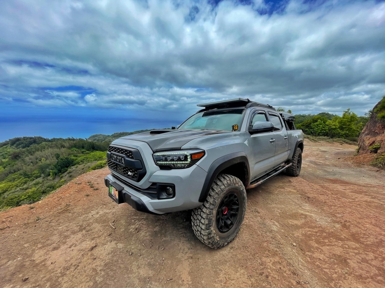

    6F83D729-50F2-4C80-9685-F580BFE29853.jpg Love my rims just trying to find offset as I move up in tire size. If anyone knows the offset lmk

    +4mm.
    I think those wheels look best on the Cement, Silver, and Magnetic Gray trucks. Nice choice. Did you run into the mounting issues I described earlier?

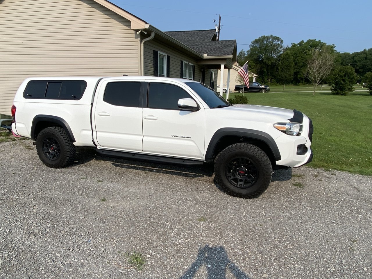

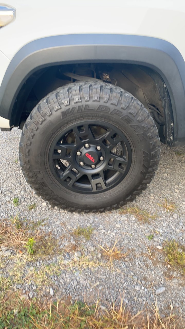

    Just picked mine up from dealership with the trd lift , rims and tires. I went with 275/70/17 ko2’s

    That looks great! Are you getting any rubbing with the 275?

    Thanks so much. I took the front air dam off before I got it done, but as far as mud flaps and control arms go, so far absolutely nothing. I will say, this has just been highway driving but looks like there’s plenty of room.I originally wanted the new 4runner rims but after reading allot of threads about having trouble with them, I went with ol faithful sema rims and glad I did.

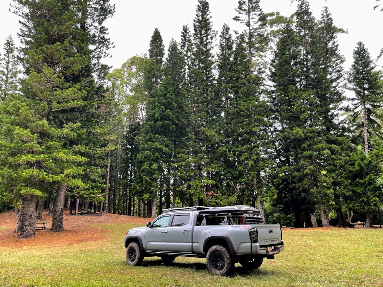

    No issues mounting thanks for the info
