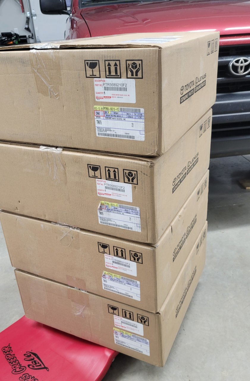

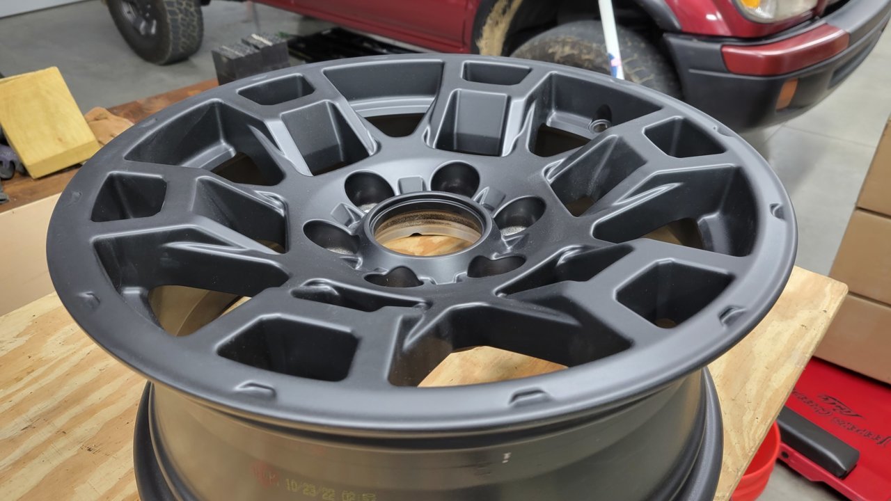

    I ended up purchasing a set of these OEM wheels from ToyotaPartsDeal.com for $855.55 delivered. They came in today in perfect condition. They are a little more matte than expected but I intend to use Dr Beasley matte seal to help make them easier to clean and care for. The surface is very smooth. Here's a few pics. I'll be putting these on my incoming TRD Off Road MGM and plan to go with 265/70r17 Toyo AT3's. I'll bevel the rear axle to provide proper fitment.

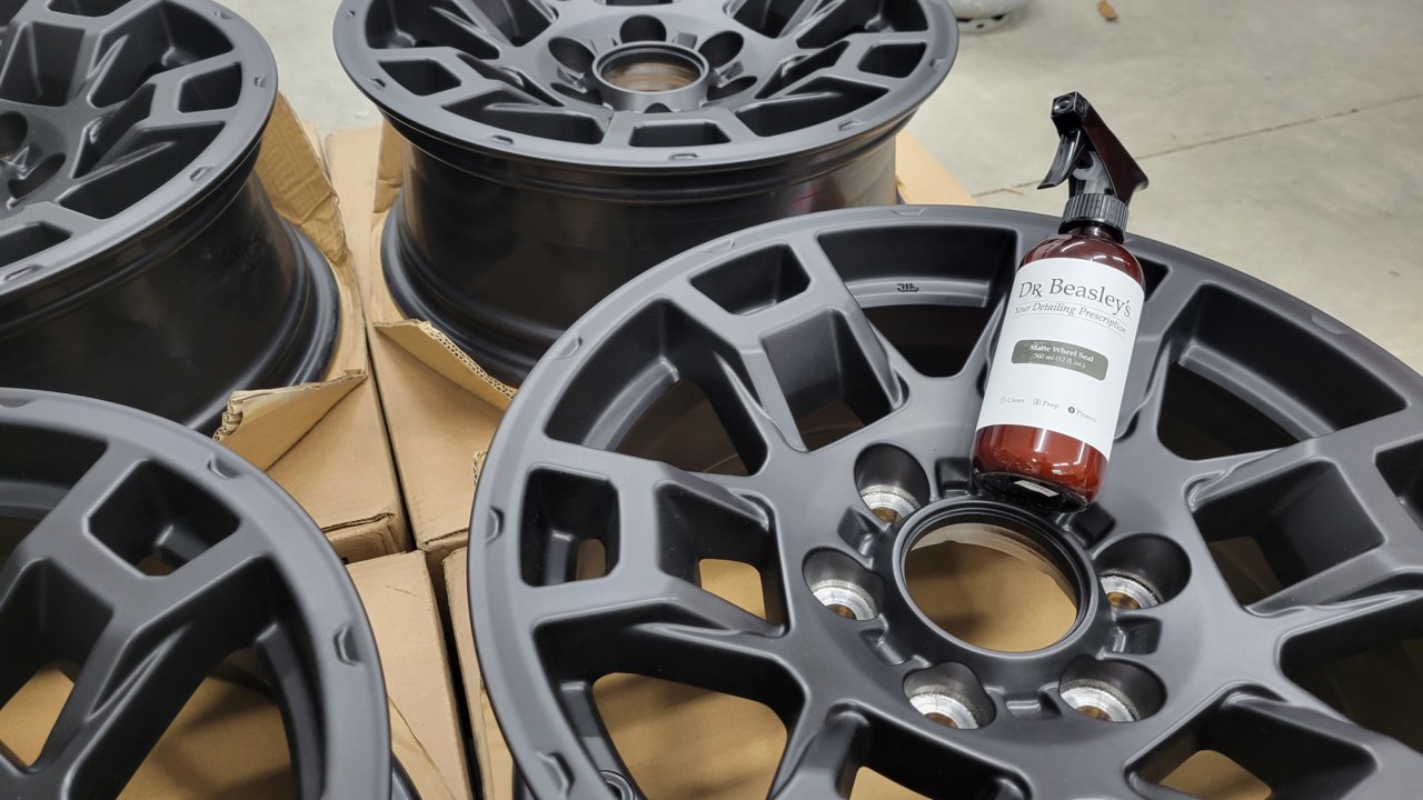

    I treated these with Dr Beasley's this evening and there's zero change in appearance but they do feel like things won't stick to them. I'm encouraged but was hoping to add a little more sheen(which would give me more confidence). Will see I suppose. I love the wheel design but and am hoping for fairly ease of cleaning. The wheels definitely have more shine in the photos than in real life. I prefer the small amount of shine that the photos show and wish I could replicate it in real life.

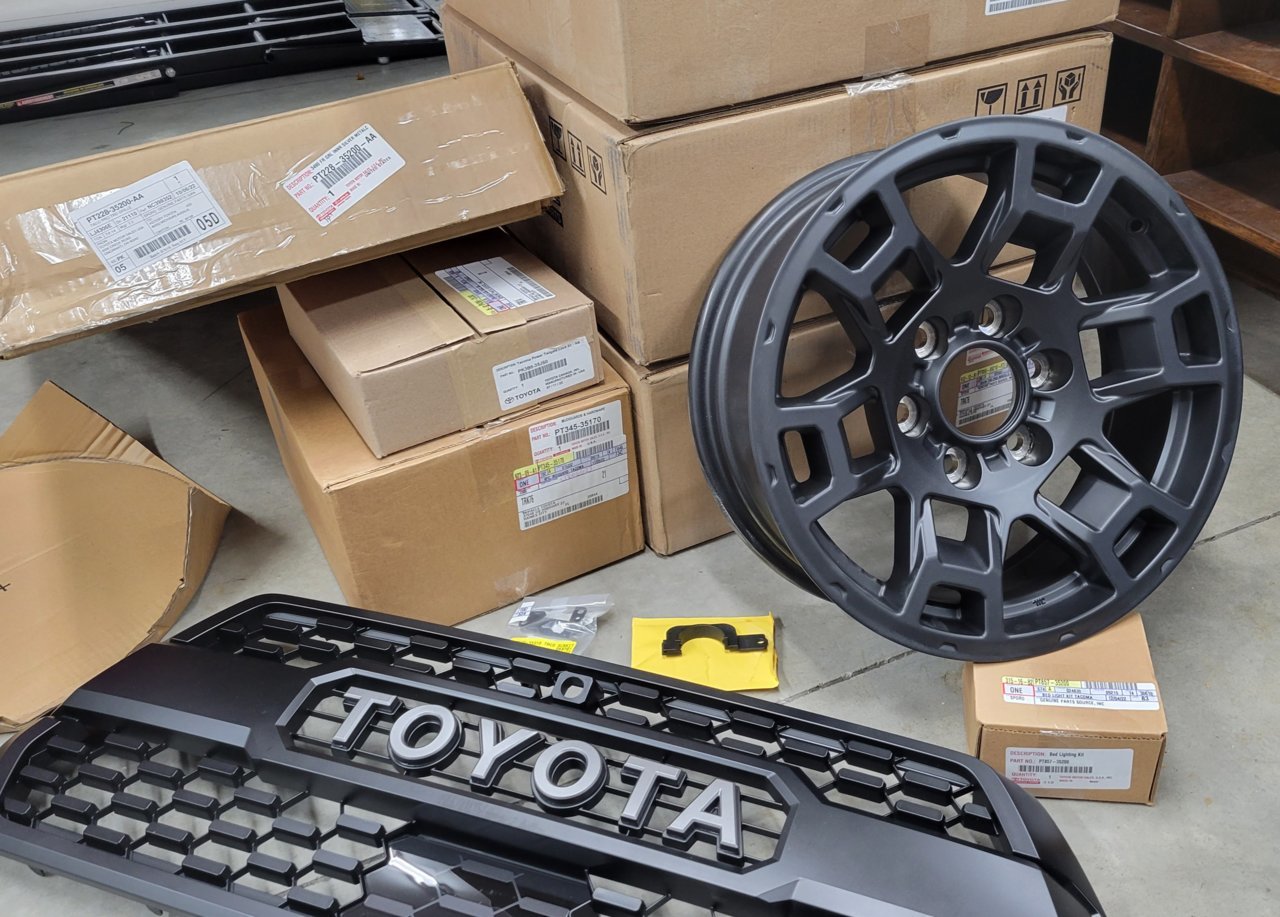

    I couldn't really find a better price on the wheels. ToyotaPartDeal didn't charge me tax and shipping was reasonable($45 total). I intend to do Bilstein 5100's on 3rd (1.1") or 4th(1.5") notch if I rub on the OEM mudgaurds along with a 1" block in the rear. I'll install these myself. I have already purchased an OEM Pro grill.

    Same experience I had with the chemical guys matte cleaner/sealant. No change in appearance at all. I guess it makes sense. Most people get matte because it’s matte. Why would you want to make it shiny. But I get it- just a slight sheen would be nice.

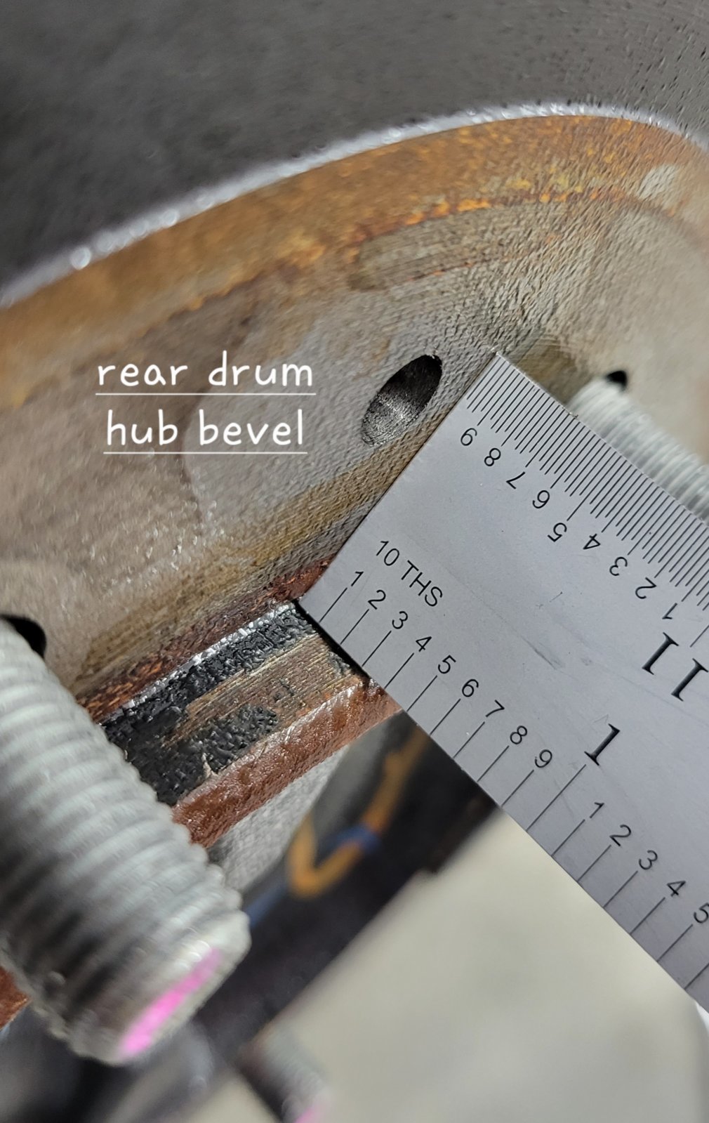

    Pull your rear wheel off and measure the depth of the protruding axle hub. If the hub is sticking out 3/8" or more then these OEM wheels will probably give you issues without beveling the axle hub. Here's a picture of how far I beveled my '23 Taco in order to get the OEM '21 Pro 4Rnr wheels to fit.

    Thanks for that information. Did you use a die grinder to bevel it?

    I used a 4.5" angle grinder and used short pieces of 1/2" PEX to protect the threads. If your good with a die grinder that should work well too and might be a little easier to manage around the threads.
