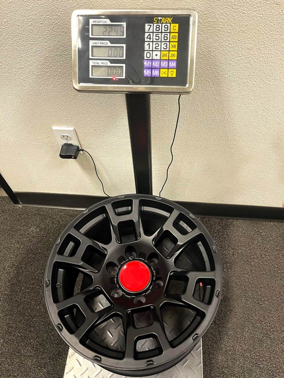

    The actual weight of these wheels is 22.45 lbs

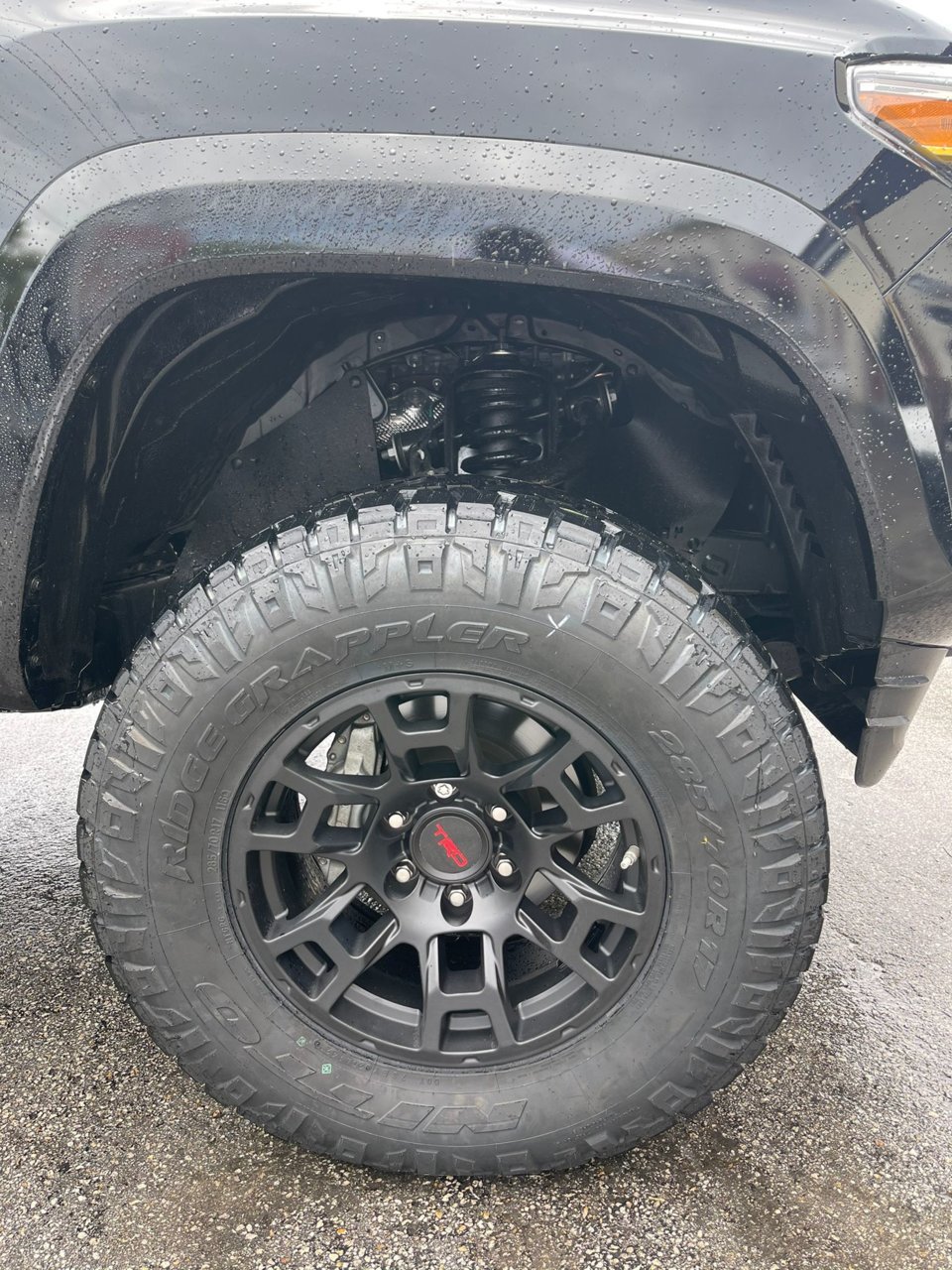

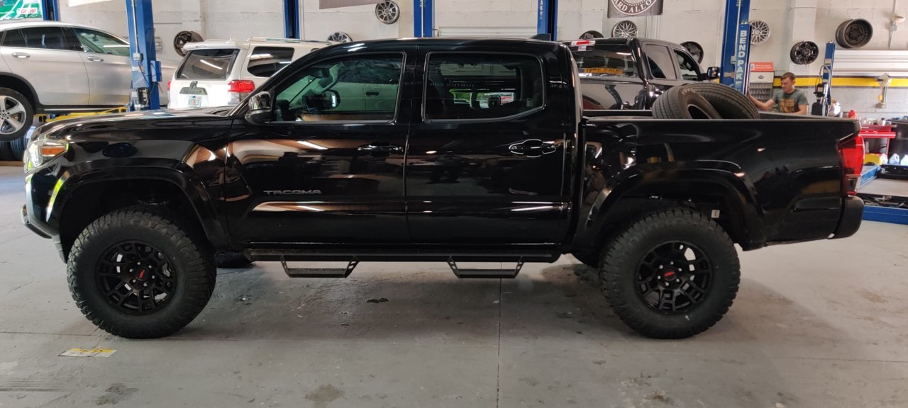

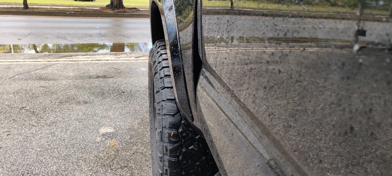

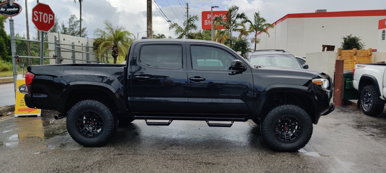

    Got mine installed today!!
    0 offset
    They look awesome, wrapped them in nitto rigde grappler 285/70/17
    Lifted it 3 inches with 5100 bilstein on the front 5th notch and a 1/2 inch top plate, on the back used 1.5" blocks.
    No rubs anywhere and the ride feels almost same as stock, I would say even better since it's a little firmer.

    That is a good looking truck right there! Man, I really dig that setup.
    Super clean, thank you for sharing those pics!
