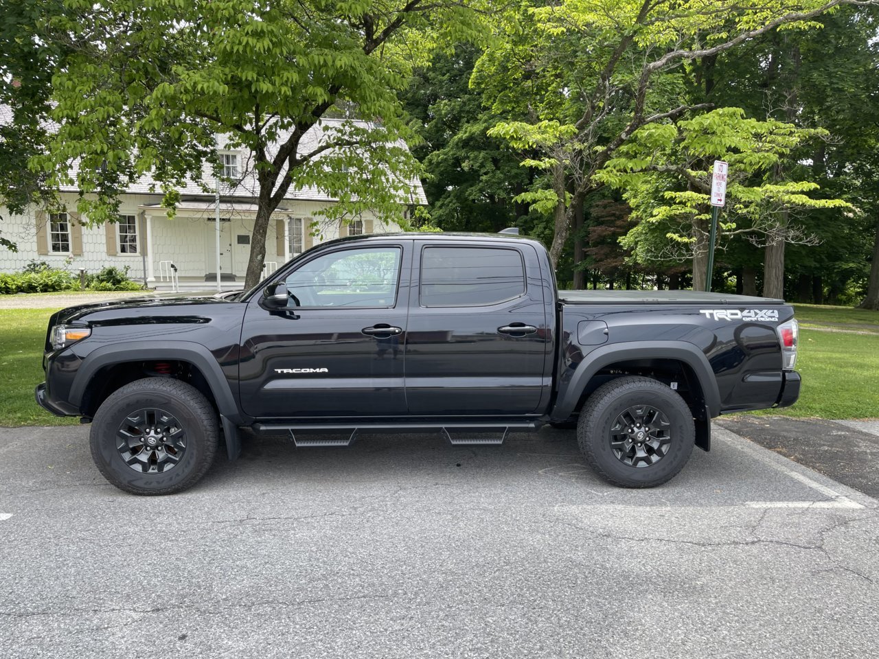

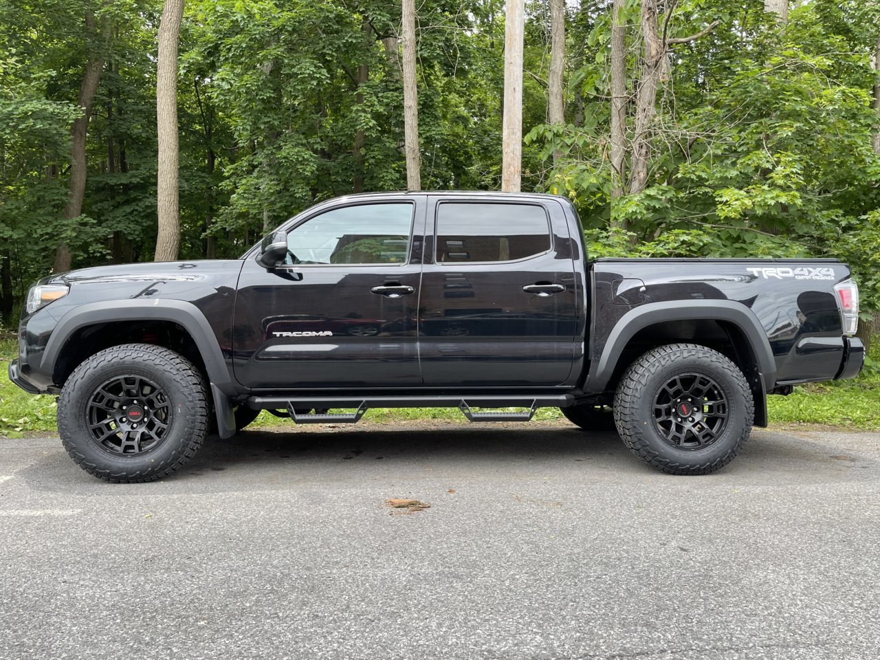

  4. Jun 5, 2021 at 8:05 AM
    #484
    hammerofjustice
    hammerofjustice Well-Known Member
    Jan 29, 2021
    #354389
    53
    2020 Black Tacoma OR MT
    Just had the 21 style mounted with 265/70/17 Falkens. Pro shocks, but otherwise a stock 2020 OR.

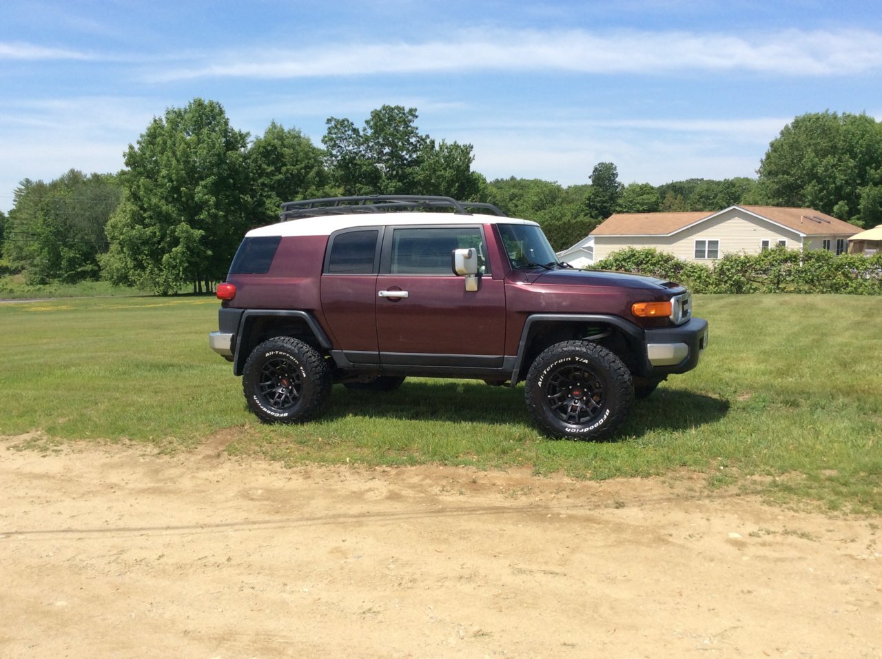

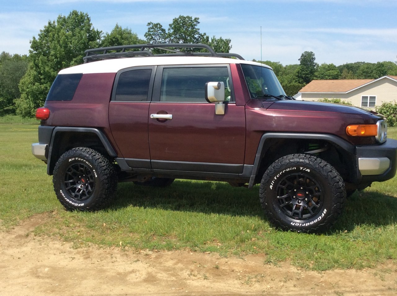

  5. Jun 5, 2021 at 8:41 AM
    #485
    Walksinsolitude
    Walksinsolitude Well-Known Member
    May 20, 2019
    #293864
    140
    2011 reg cab
    Toytec 3” bilsteins on 4 corners rear aal. 285/70/17 nitto trail grappler on venom Rex 17x9 -12 offset
    D94A0891-E355-48ED-B223-3CB050F208A8.jpg 4C0CFE43-C5B7-4C05-A8EC-1BCAAE93BCF3.jpg Just finished the install on my sons FJ.

  20. Jun 6, 2021 at 6:31 AM
    #500
    hammerofjustice
    Jan 29, 2021
    #354389
    53
    These are 0mm offset in the satin black finish.
