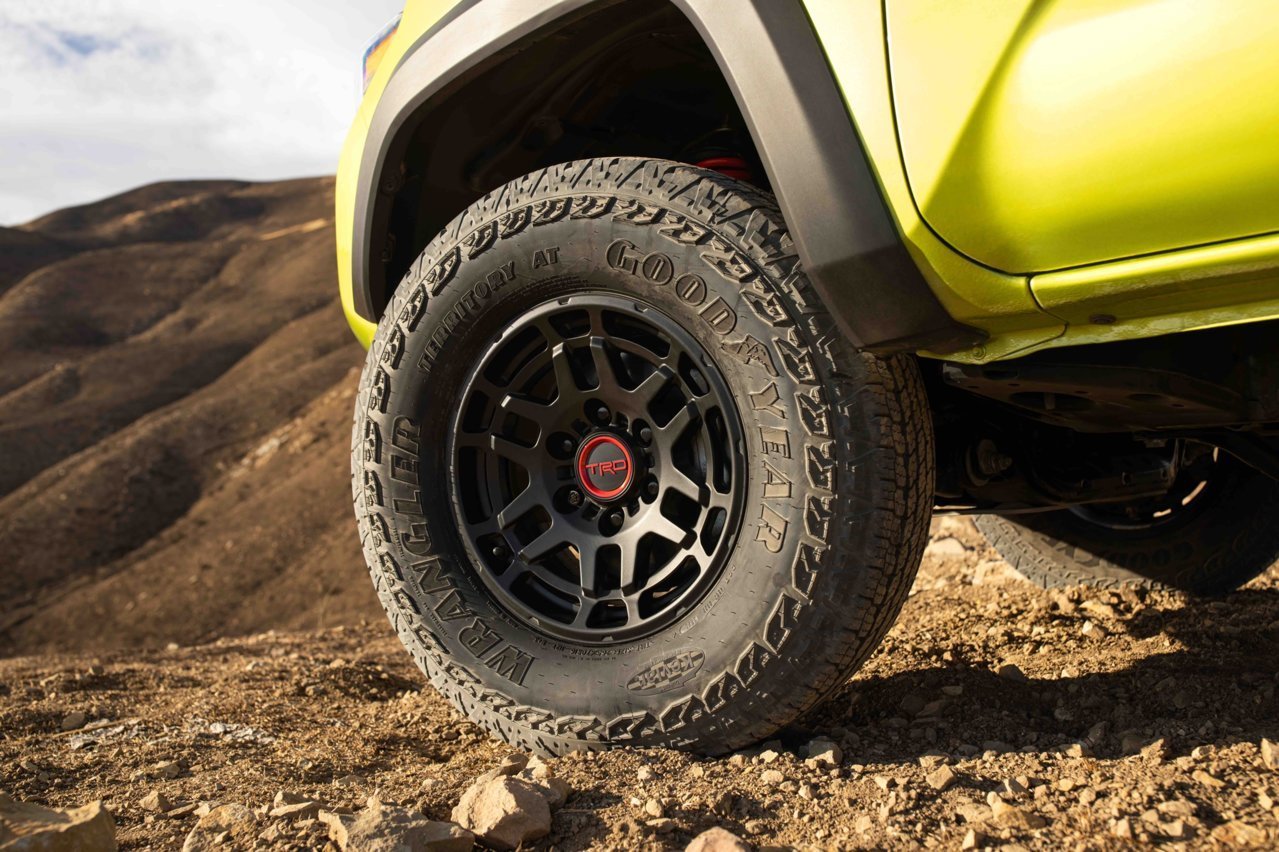

    Dustin, I'm wondering if your team will be doing replicas of the new 2022 TRD Pro rims in 17s, preferably 8.5 at +0 offset like your 2021 4Runner TRD Pro.
    I already preordered and bought your 2021 Pro 4Runner rims, but these 2022 Pro rims look absolutely amazing.

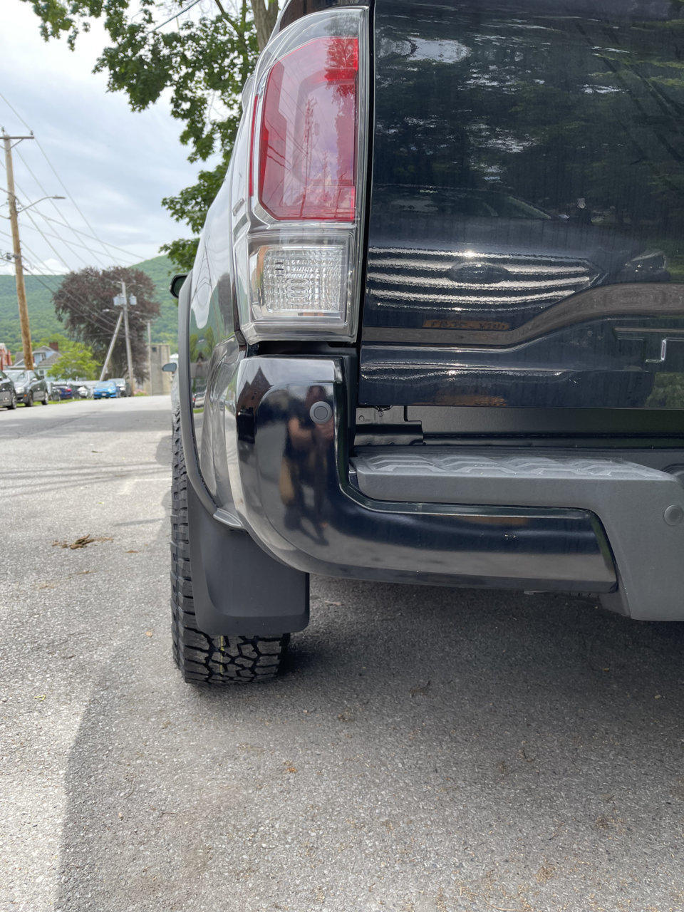

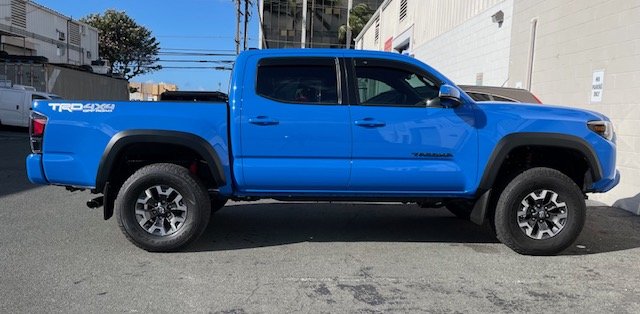

    Before:
    After:
    Falken 265/70/17. Wheels are the 0mm backspace version.

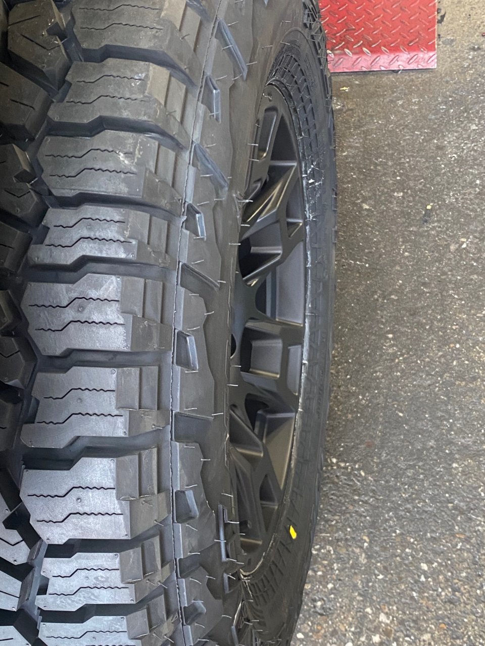

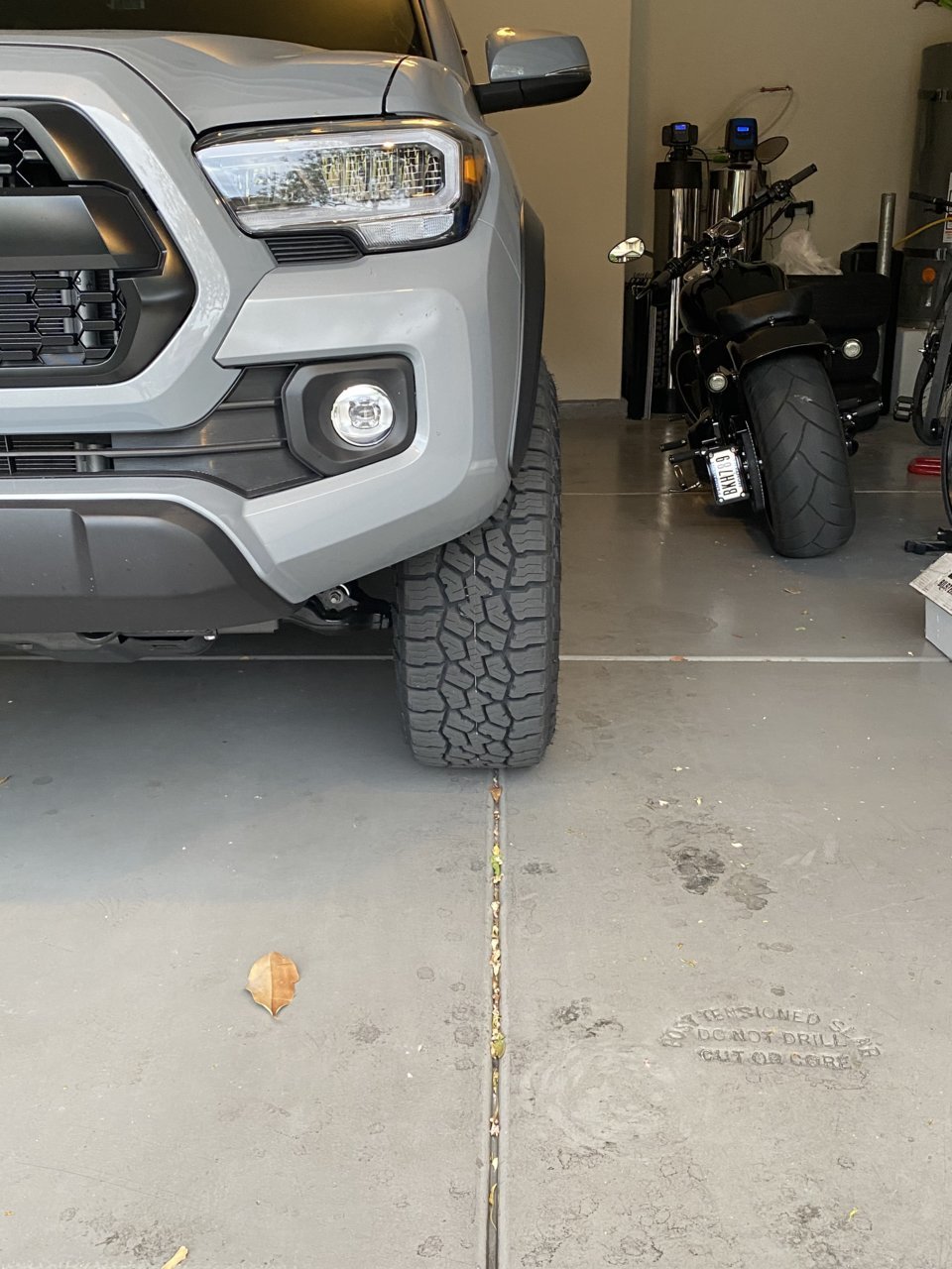

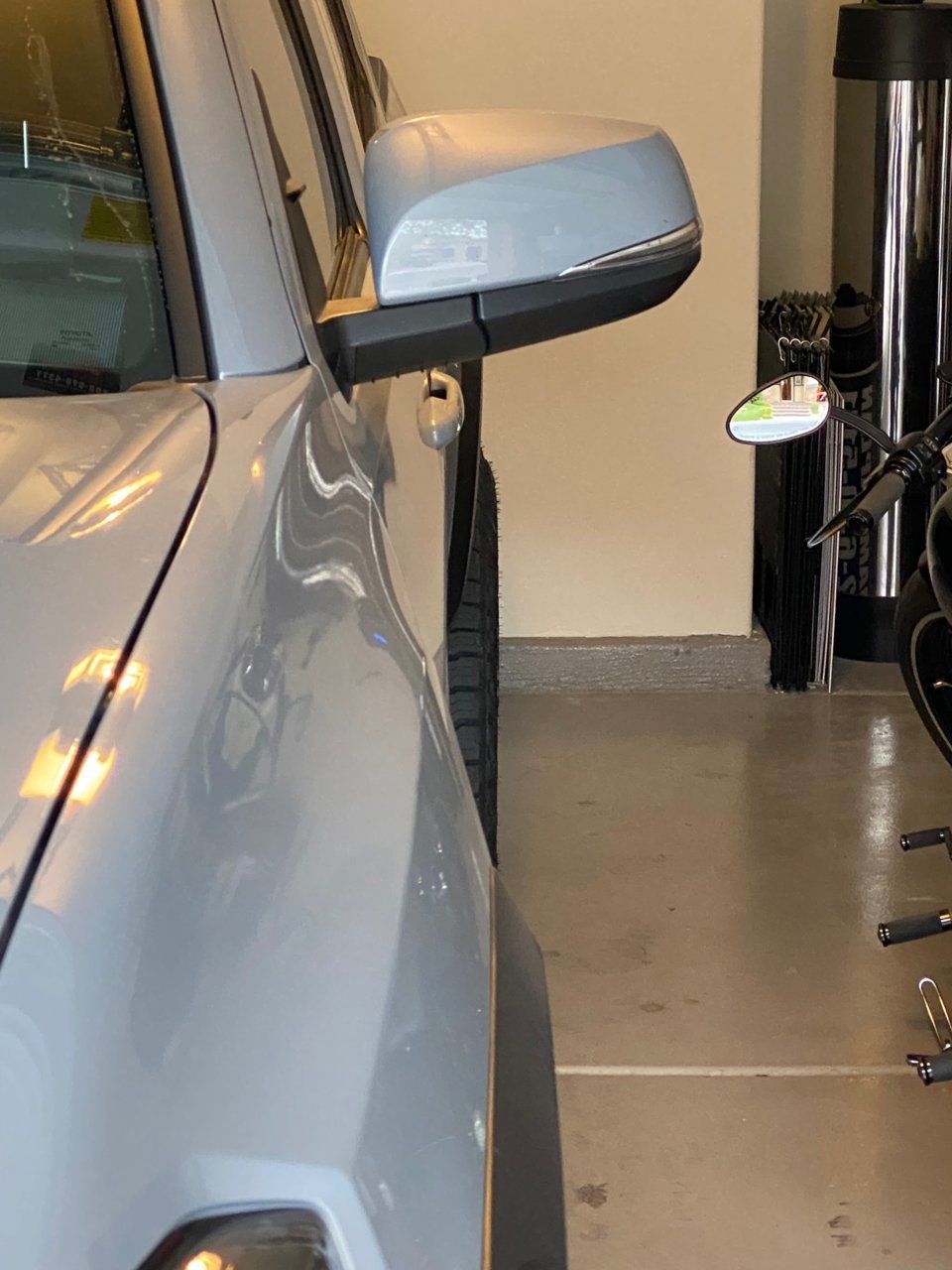

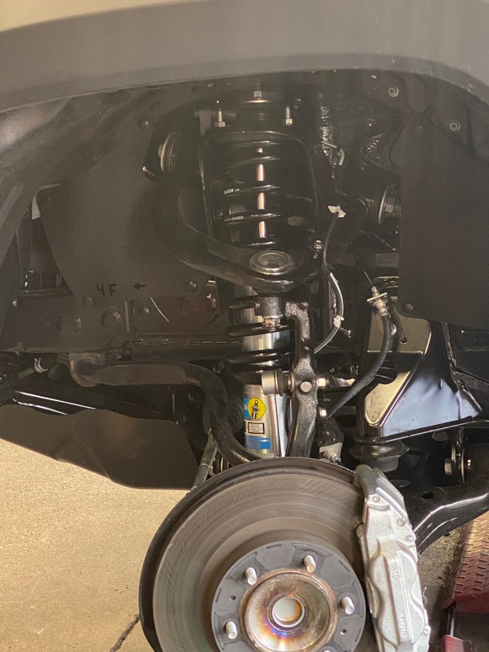

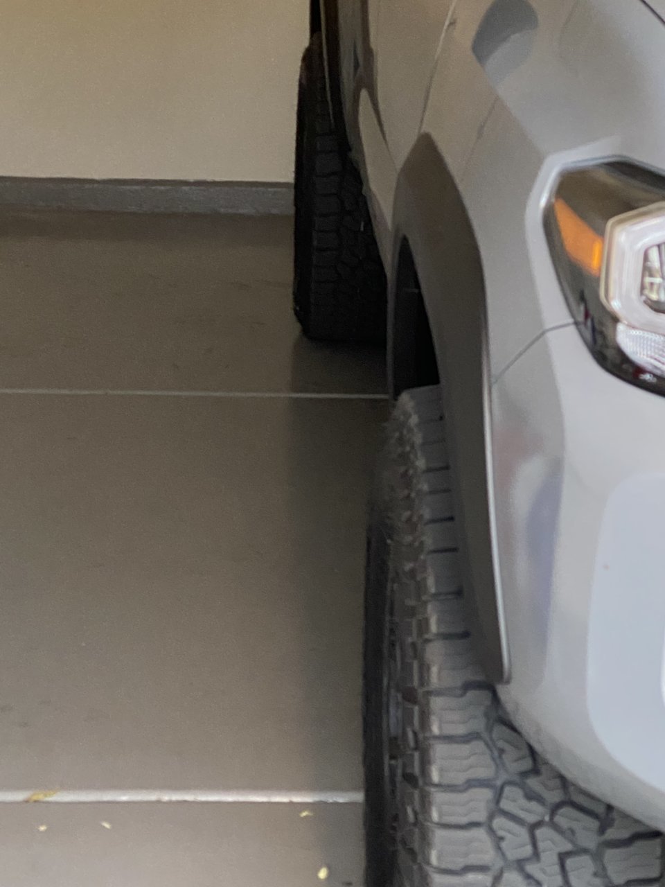

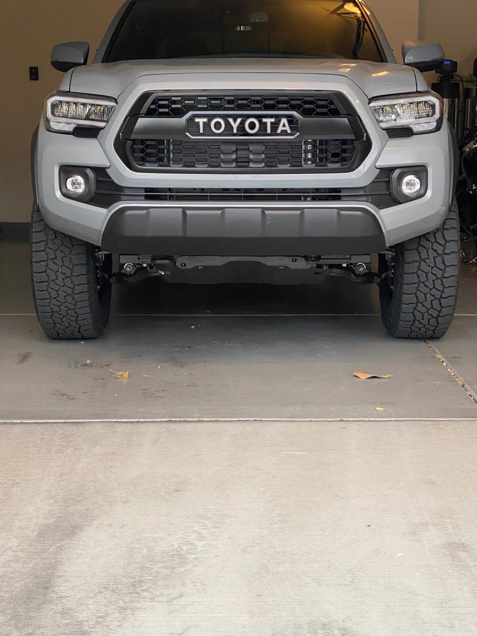

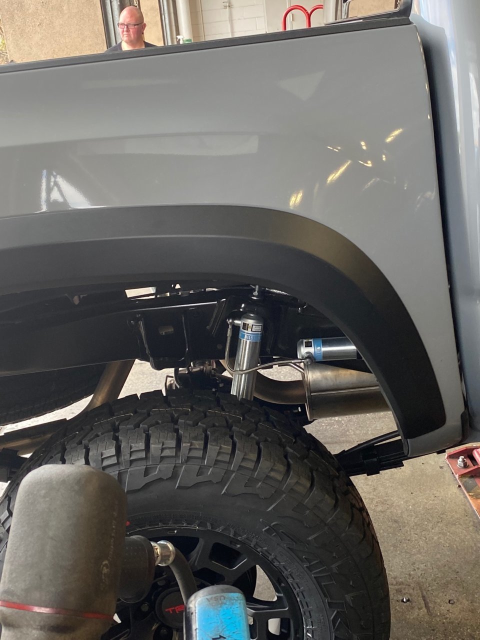

    I bolted mine on today with a bilstein 6112 2/3 lift to level it out and 5160 in the rear, rides great. A bit stiffer on driver side due to being on setting 3 as opposed to 2 on the passenger side, but it sits about dead level now.
    I have falken wildpeak 275/70/17 tires and they look great, but I am getting some decent rubbing on the front of the fender and cab mount and rear of fender well. I am going to go back to discount and get some 265s and with the minor lift and aggressive 0mm offset, they just rub too bad to live with. Pisses me off as they look so damn good!!

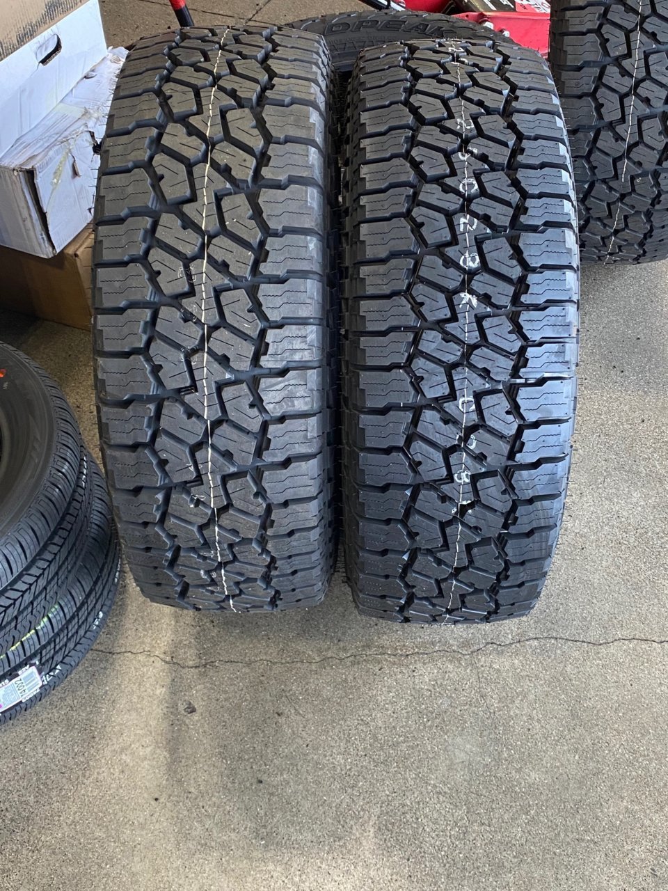

    I took pics of the 275s and the 265s next to each other and they are very similar, so I should not lose much in terms of looks.

    Those both look like gurly-man tires compared to the one that's on that bike!

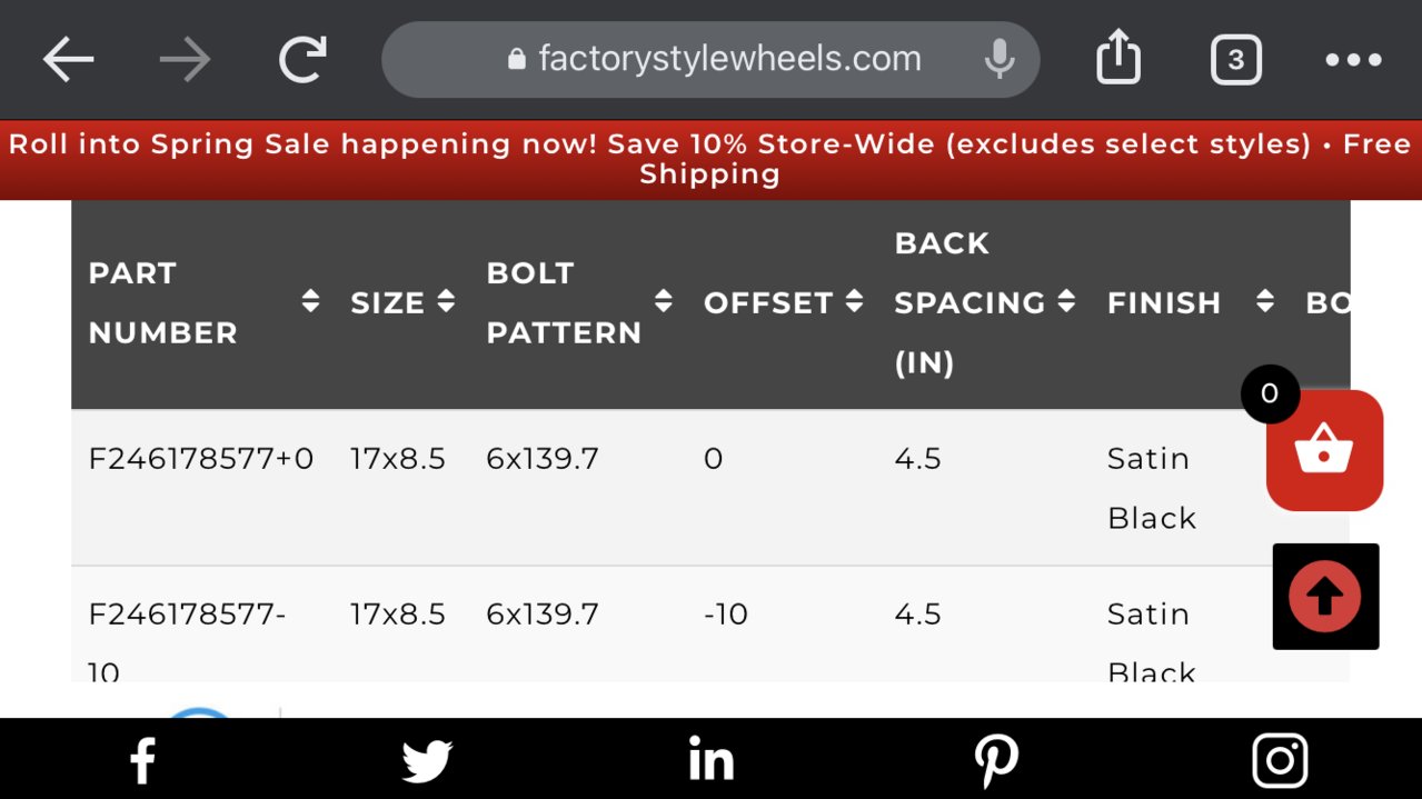

    Hey guys!
    Sorry for the delayed response on this. Also sorry for all the confusion I've caused you. Lol!
    I have a ton of duties around here. So sometimes I just shoot the wheel pics, get them edited and put them up on the site as quickly as possible so I can move on to the next thing.
    I just hadn't gotten a chance to get those backspacing specs updated, but I have now. This is much more accurate.
    Again, I apologize for all of the confusion.
    -Dustin

    We will be doing this style as well!
    I am not completely sure on the specs just yet, but I will definitely keep everybody posted as we get them into production.

    No worries! Its splitting hairs honestly but just making sure we all understand it right. I see you updated the backspacing for the 0mm offsets as well. So 0 offset is 4.75 not 4.5" as it was before correct?

    That is correct!
    The 4.5" Backspacing is for an 8" wide wheel with a 0mm Offset
    The extra 0.5" in width opens up the backspacing to 4.75"
