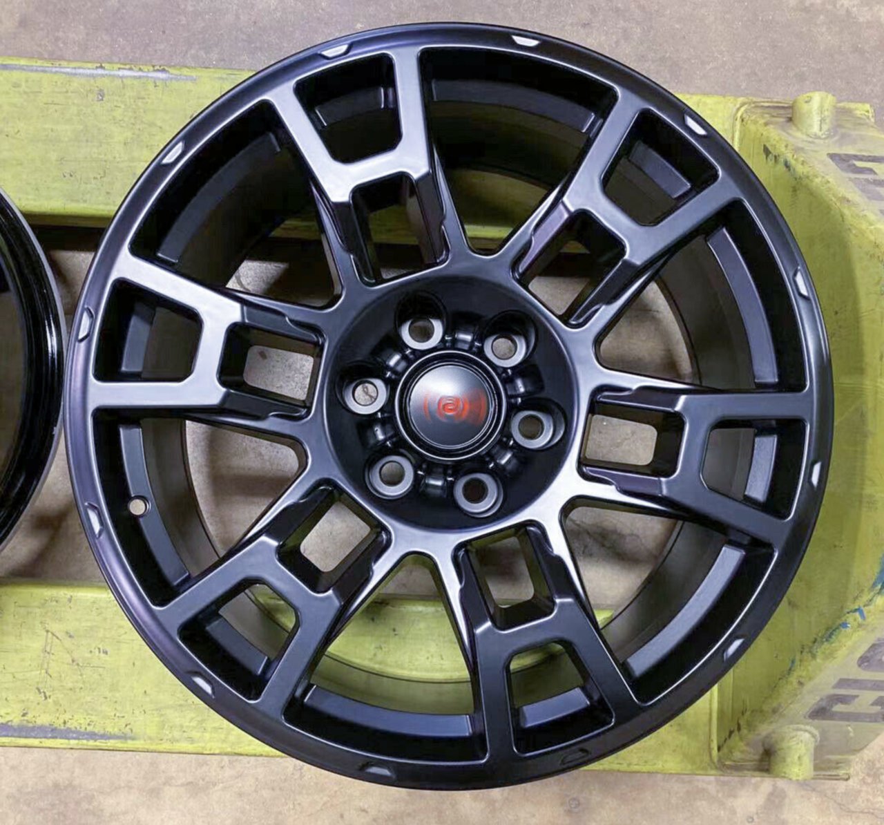

    I’m seeing these for sale on eBay. Are they yours?
    #51
  12. Feb 3, 2021 at 7:08 AM
    #52
    bmxtaco
    bmxtaco Well-Known Member
    May 16, 2015
    #155410
    178
    Planet Florida
    2021 TRD OR 6MT
    The design of the ebay knock-offs are way off OEM, and not very similar to his renders either. Specifically the spoke length/widths are wrong. The width/offset/weight are also different.

    Good eye! So do we know when these will be available from Factory Style Wheels?
    Edit: ETA April 2021
