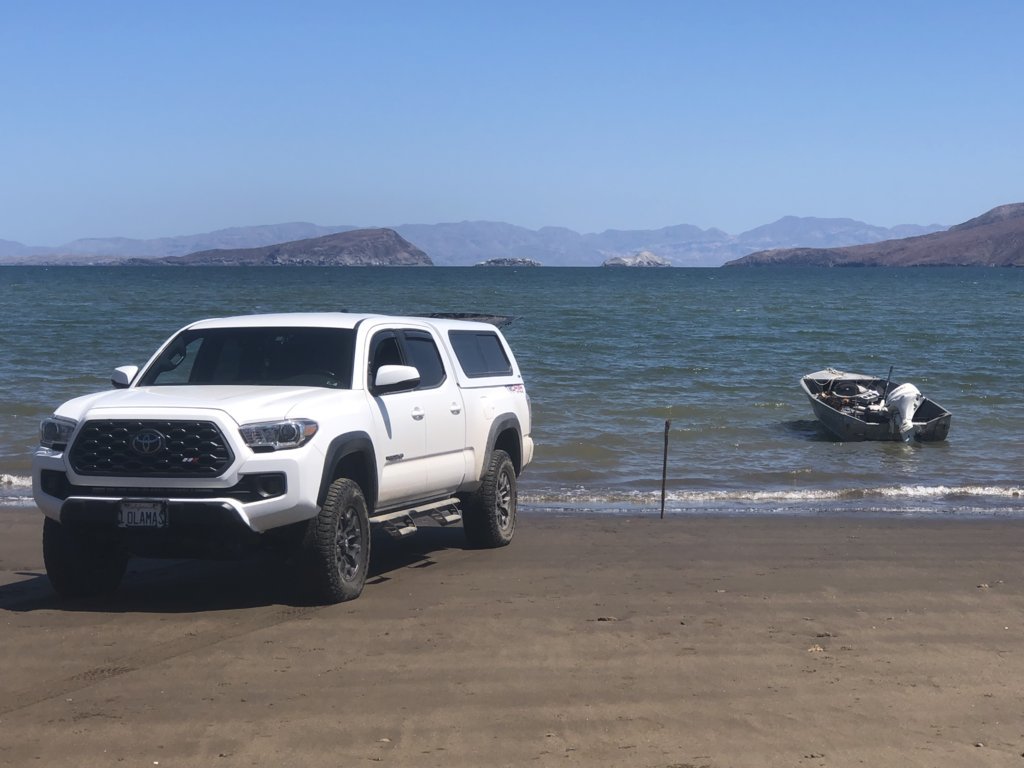

    Welp, I put on 5100s cause I hated the stink bug ass in the air look. Middle notch leveled me out proper. Then added air bags to fix the notoriously soft rear end and it’s perfect for my needs traveling SOB (south of border).IMG_9847.jpg
