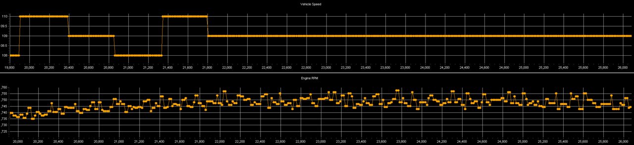

    I didn't log speed for that first log. Here is that same section for the second log:

    So, would you guys mind banding together with @BlueTaco4x4 to either open a case with corporate or possibly do some additional stuff to possibly get this addressed?
    Of course, if we can kill it with a tune, that info will be made available.

    The unfortunate problem is that even the best BT adapter is not fast enough to catch it. Fusion was only giving 1/sec data rates. It seems if we turn down the number of PIDs, it will log a bit faster, but this feels like a 10hz vib, at any speed. The wired vF logger is capturing something.
    I did brain fart the last time that I was there with @BlueTaco4x4 and didn't try TS logging. That's on me, as the vF logger doesn't have any AT PIDs yet.
    But, we do have logs from Fusion. There is only one that shows a bit of a TC dance, but the speeds are not steady to really know for sure.

    There was some of this happening on the 2019s. OVT made the special 1.05.1 tune to help with the shuddering / rumble strip feeling. I believe it helped in some cases.
    I don't recall seeing much about this issue in the past year. But suddenly the 2021s seem to be popping up.
    @OVTune 's suggestion was to first try changes to the Air Load Control maps. We did that with no success. I have not hit him up again on this, as the OP was intending to leave his Taco at the dealer. It ended up being two dealers, now with corporate saying they won't do anything until they get more reports.
    Note that I personally felt this and it is shitty. Both @BlueTaco4x4 and I drove the same roads at the same speeds in my Taco. Nothing.

    Just a not that this feeling is in all gears from about 25mph to as fast as the OP is going. Steady speeds and always about 10hz. It doesn't change with speed.

    Good point. And @tonered log shows engine speed oscillating while vehicle speed does not. Although it looks like the vehicle speed sensor does not have fine enough resolution to tell for sure.
