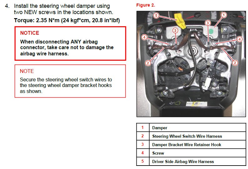

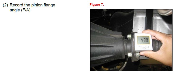

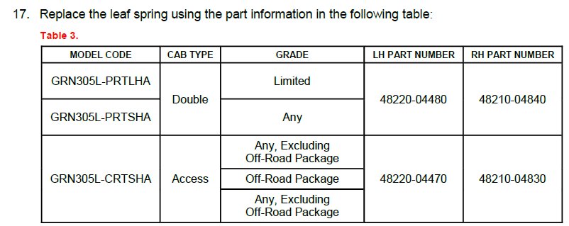

    December 15, 2020 MANUFACTURER COMMUNICATION NUMBER: T-SB-0124-20
    Components: POWER TRAIN
    NHTSA ID Number: 10186200
    Manufacturer Communication Number: T-SB-0124-20
    Summary
    TSB: Some 2016 ? 2021 model year Tacoma vehicles equipped with an automatic transmission may exhibit a vibration under deceleration (coasting or braking) between 30 ? 10 mph. This vibration is felt in the seat, floorboard, and/or steering wheel. Follow the Repair Procedure in this bulletin to address this condition.

    It looks to be similar. I'm trying to avoid unlocking 04B04 in the hope that the TSB happens soon. I did have to unlock 04A61 though.
    That TSB replaces a damper in the steering wheel and measures pinion angle and possibly replaces your rear leafs. To me, that would suggest a speed variable vibration. To me, the vibes frequency doesn't change with speed.
    Of course, it is a course of action to try?
