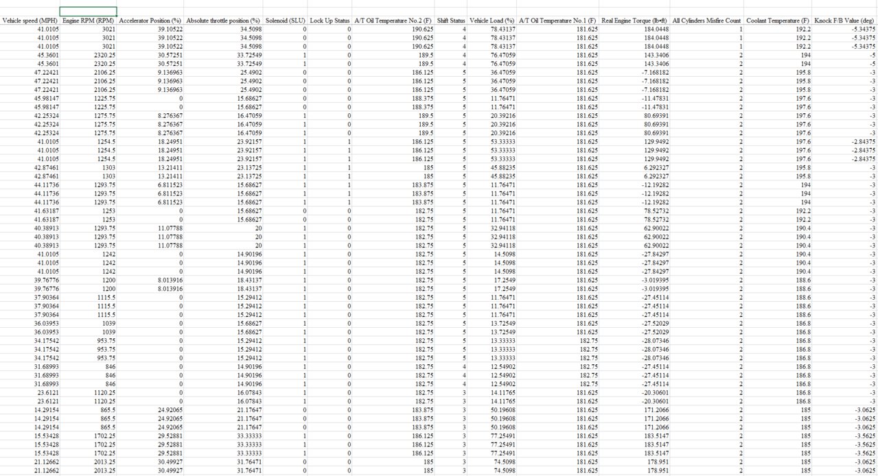

    31,282
    tony
    Lynnwood, WA
    Thanks, but that screenshot was only Engine RPMs on four different vF Logs.
    Yes. Though, we were watching both SLU and Locked PIDs on OBD Fusion. There was not a moment of wavering or anything that would have made me think the ECU was commanding anything to the TC that was being felt. At times, I would feel a hint of a stutter starting and glanced at OBD Fusion to see it transition from Slip Lock to Full Lock. Here is a section of the OBD Fusion datalog:
    The biggest issue there was that the log interval was 1/sec.
    As noted, I did make the mistake of not logging on TechStream after I found the AT PIDs missing from the vF Logger.
    The issue felt is constant shuddering at any steady speed, most evident and annoying, IMHO, on the highway holding speed.
    One thought has come to mind, which might blow a hole in the whole logging effort. Are we monitoring the ECU commanded actions or the actual solenoids? Say that the ECU commands full lock, SLU and Lock, and if either of those solenoids are going in and out, is that data being reported or is it just the ECU command?
    My other thought is that if the AT is truly locked steady during this situation, what other elements could cause an approximate and constant 10hz vibe over a wide speed range?
