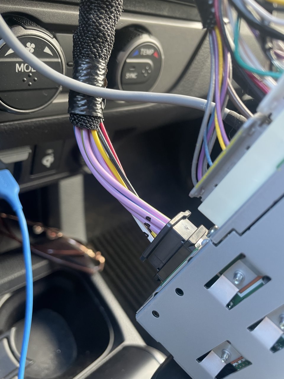

    So I do have one question for you. Is the black connector on the end of the stereo still the speaker connector? It appears that on mine there is also a yellow red and black wire which would point to it no longer being the speaker connector.

    Do you have a picture? I did my install 4+ months ago and I've slept a few times since then.

    that last black wire according to the metra diagram would be the speaker harness. But i cant tell off that changed on this year due the colors of the cables.

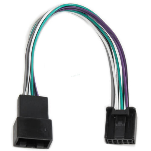

    Found an easy wire for adding an amplifier.
  11. Sep 24, 2021 at 7:47 AM
    #31
    itsZiz
    itsZiz Active Member
    Jan 31, 2021
    #354654
    30
    2021 VooDoo Blue SR5
    KMC KM535 GRENADE OR Falken Wildpeak AT2W 265/75r16 Black Decals Overlay & Tailgate Inserts Aeroskin II Hood Protector Tacoma OEM Bed Mat Window Tint TRD Grill
    Where did you find that adapter?

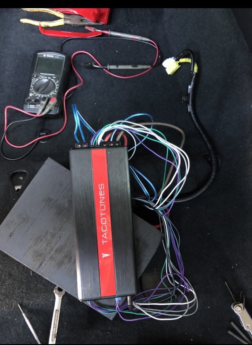

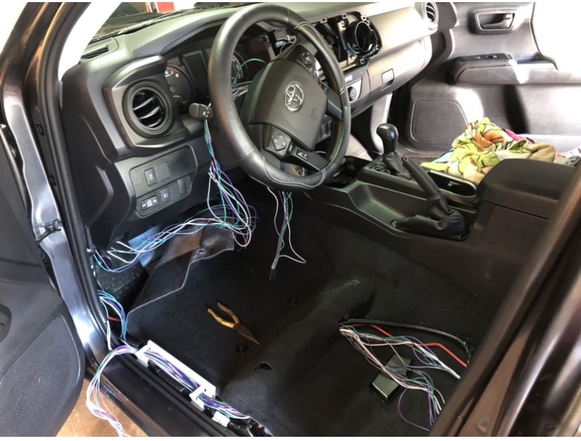

    854F555B-B5C2-45C8-B6AB-FBD682359BA8.jpg 95B77314-C133-4EFD-8E52-D64287E893E3.jpg Plug and play, no splicing, facitory head unit, 5 channel amp, 12” sub, all Kickers replacing stock speakers. Ttunes. 2021 double cab.

    #34
    itsZiz[QUOTED] likes this.
